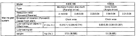

E Ed.S . Jan 31, 2020 30 Hunter 376 St. Petersburg Sep 24, 2021 #1 Can anyone tell me what the gear ratio is on a hunter 376 with a KANZAKI transmission with a 3JH2E engine.

sail sfbay . Feb 21, 2013 4,638 Hunter 46 Point Richmond, CA Sep 24, 2021 #2 Yanmar datasheet attached indicates the transmission is a Kanzaki KM3A and gear ratios tabulated below from this reference Marine Gear; Applicability Of Marine Gear And Reduction Ratio - Yanmar 3JH2 Series Service Manual [Page 13] | ManualsLib or YANMAR 3JH2E 3JH2TE Marine Diesel Engine Workshop Manual (emanualonline.com). Might have to cannot your local Yanmar dealer Marine Diesel Engines and Marine Engine Parts | Ace Marine Diesel, FL to confirm your transmission gear ration based on its serical number. Attachments Yanmar 3JH2TE Datasheet.pdf 318.2 KB Views: 269 Last edited: Sep 24, 2021

E Ed.S . Jan 31, 2020 30 Hunter 376 St. Petersburg Sep 24, 2021 #3 Thank you, that helps. I'm trying to determine what folding propeller to use.
kloudie1 . Nov 6, 2006 10,256 Hunter 34 Mandeville Louisiana Sep 24, 2021 #4 There should be a small plate on the case with the ratio stenciled on it. A mirror and flashlight may be needed. Likes: JamesG161
