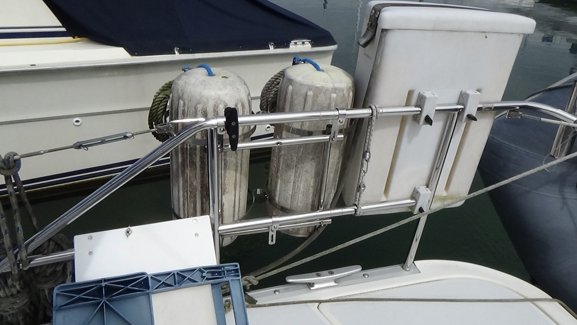

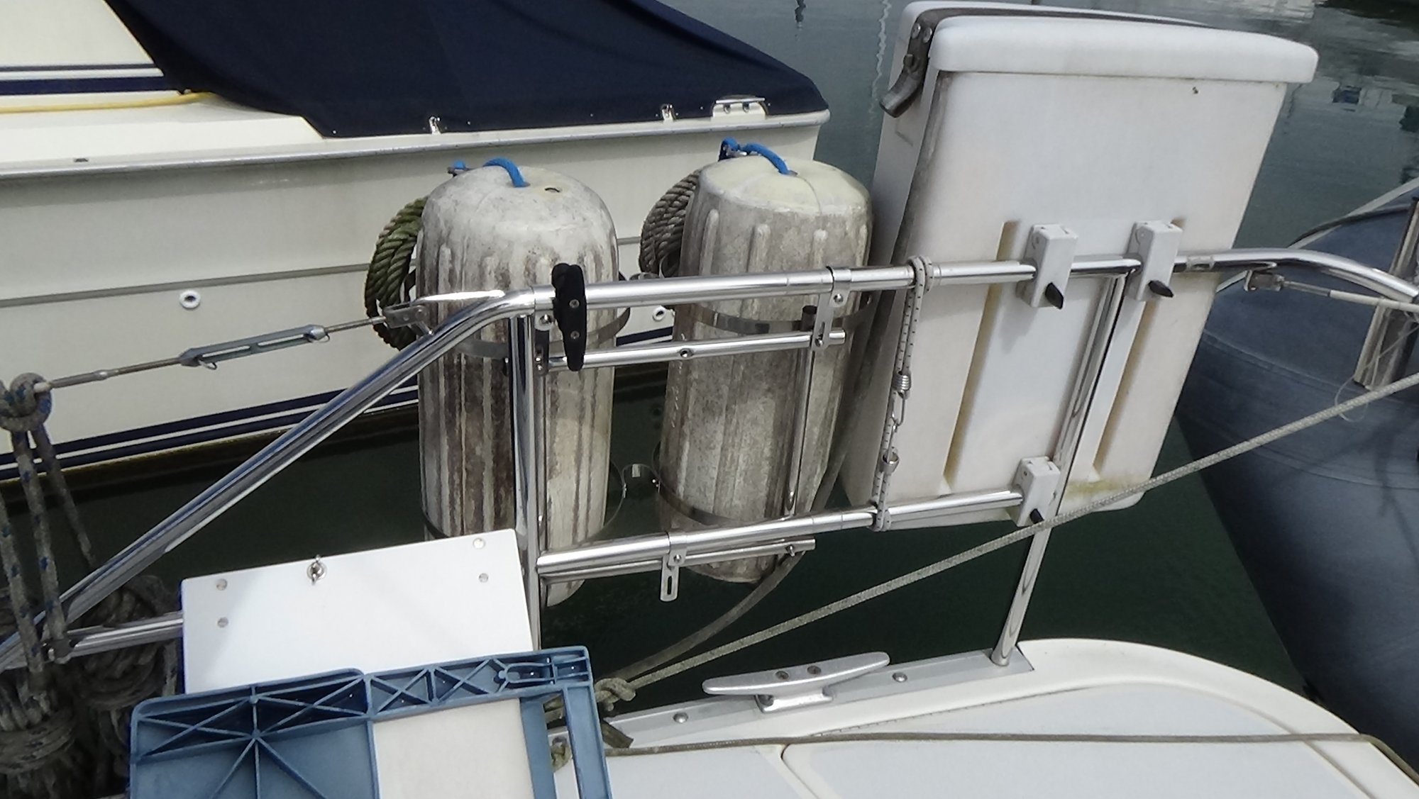

Stow my Taylor Made fenders in a Taylor Made dual fender basket that mounts on the outside of the stern pushpit rails, one on each side. Used to have two West Marine woven synthetic double baskets that finally wore out after several years of use. These new SS baskets work much better, are out of the way and should last the life of the boat.

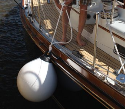

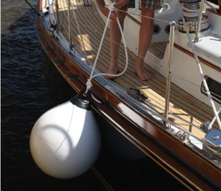

A couple of 15and 18" Taylor Made Tuff End Buoys mitigates the boat hitting the dock.

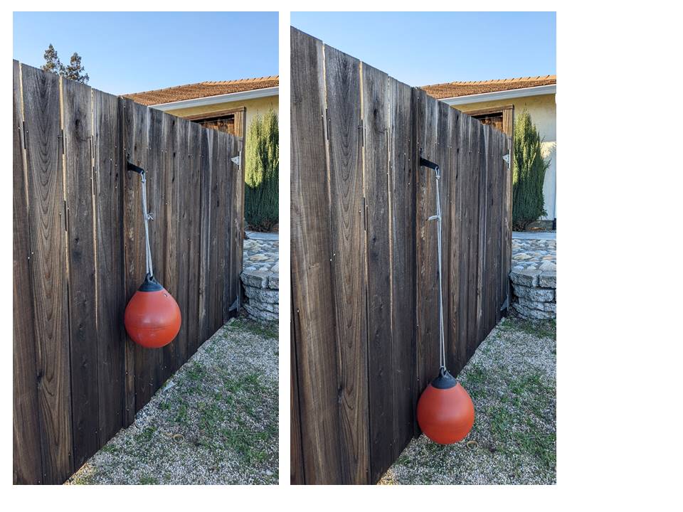

When we first bought our H34 in 1985 a new acquaintance, Ted, at the club advised us to buy a couple of the 15 inch round orange fenders. They've given us lots of flexibility and protection over the years. We are able to store them in our aft lazarette or as Stu posted, flip them over the top lifeline while underway. Ted also suggested we loop a line twice through the eye of the fender and secure it to a bronze clip. Then they can be extended down for low docks or pulled up to protect the caprails of the two boats when rafted. Here is a picture of an extra one I have at home that someone gave us when she sold her boat. Note the high and low position.

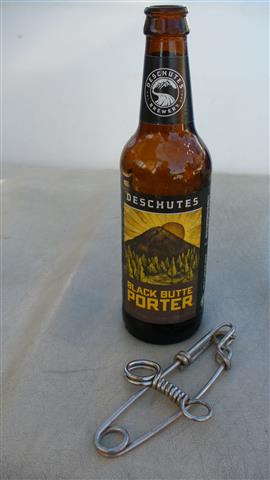

I use these clips (not the smaller link) that we got in Winchester, OR. Clipped to the lower lifeline they work for docks. Flipped over the upper lifeline they ride on the gunwale for rafting up.

@Stu Jackson, Is the beer bottle there to indicate the cost you had in acquiring those special Oregon designed clips?
