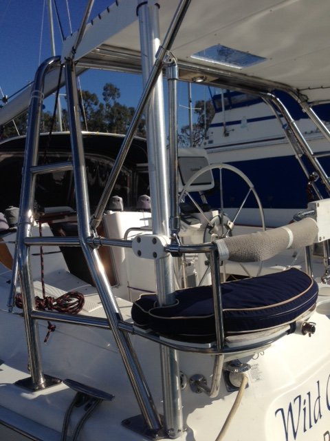

The mechanical connection to the arch is better seen here

Are you saying you have a ground wire from the starboard arch? Thats what I have. But, mine is clearly not factory wiring. As I understand it, no one else has one.
I did disconnect the arch ground wire and tested the performance of the radio and radar. They both worked fine. So the ground wire doesnt appear to be required as a ground plane. Nor is it needed for lightning protection. So, it looks like a bad idea to have the arch ground wire.

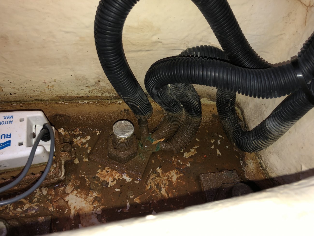

It's been a while, but I did check behind the headliner access panel. There is no factory ground wire in place. I also checked at the keel. There are only connections for 3 wires there. So, my vessel now has no ground wire connected to the arch (because I removed the aftermarket one), but one is required as per the manual.
Attached is a picture of the bonding wire connection to the keel. There are only 3 wires there- one for each shroud and one that goes forward to the mast and forestay.
Could someone check to see if there is a ground wire connected to the arch behind their headliner access panel (far starboard stern corner of aft berth)? If there is, could you check to see if there are 4 wires connected to your keel? And could you try to figure out the routing for the arch ground wire?
Thanks!
