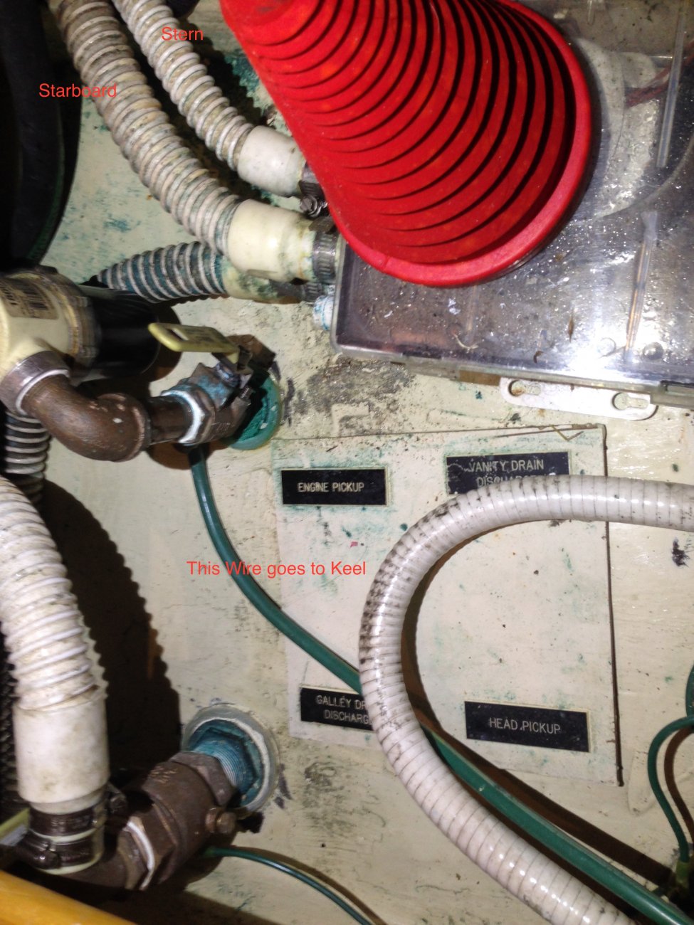

I've been impressed with my 356 and the engineering involved. But, I do have one problem. The thru-hull for the engine water inlet is slowly corroding.
The other thru-hulls are bonded to a submerged zinc mounted in the hull. They show no signs of corrosion. But, the engine water inlet thru-hull is bonded via a long, circuitously running wire to, I believe the lead keel. As I understand the galvanic series, that's not a good way to prevent corrosion on the thru-hull.
I'm considering removing that long circuitous wire and bonding the engine water inlet to the zinc mounted in the hull. But, I'm reluctant to modify what I've seen as a very solid engineering job. How are other's Hunter 356 thru-hulls bonded?

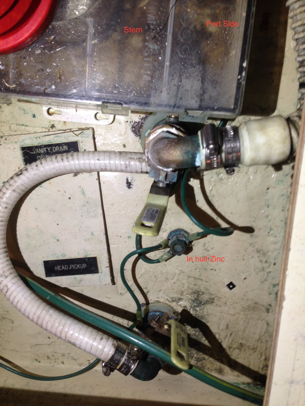

Here's the pictures. I've added text to the photos to describe what you're seeing.
I'm not certain that the wire I've identified as going to the keel actually goes to the keel. I, as of now, haven't pulled up the floorboard.

I still think what you're seeing is an add-on, not a Hunter original setup. First, there is nothing in the 356 manual about this grounding system or the thru-hull zinc, either in the description, drawings, or schematics. Second, note in your pictures that a ground wire runs to the head pickup and then a short wire runs to the zinc - it's a bad practice to not use homeruns to the zinc. Also, the crimps are not glue filled shrink insulation,which would be used in a wet area. I also think that the really heavy gauge wire to the engine thru hull from the keel (?) is a major error and extremely dangerous; if that wire goes to the keel it is effectively connecting the thru hull into the lightning protection system and providing a high current path for lightning to the bronze thru hull - essentially a point path into the water. I would expect a strike to make a very large hole in the bottom of your boat there. I would definitely talk to the service manager and see if he can tell you what's going on.

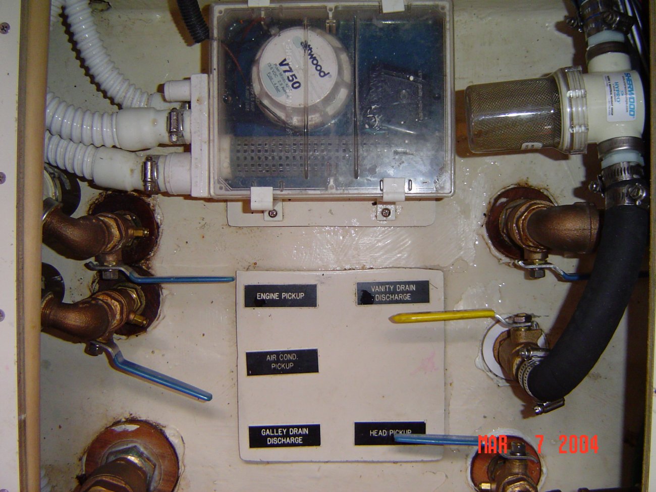

FYI, Escape is s/n 198, built in April 2002

Thanks Chuck and Jerry!
And Thanks so much for the picture!
Chuck's vessel was built a few months before mine. Jerry, when was your vessel built? If we can establish that a vessel built after mine also didn't have this feature, then it's a given that this was not provided by the factory during that timeframe.

BTW, Hunter had issues with the original thru hulls (corroding ball shafts) and recalled them for replacement at Hunter's cost. I think the blue handled valves in Jerry's (old?) picture are the bad ones, all of my new valves had the yellow handles

Chuck and John: Merry Xmas to you too. Note the date on that photo was 2004! I wish it was still that clean! It isn’t! Chuck is right about the thru hulls. Mine were all replaced and my thru hull handles are yellow now. I’d forgotten about that recall Chuck.

Yes there is a zinc mounted on the hull. The mounting bolt can be seen in my picture. Its roughly midway between the two thru-hulls to port.

I forgot to mention that I also found that the blackwater thru-hull near the transom is also bonded to the in hull zinc.

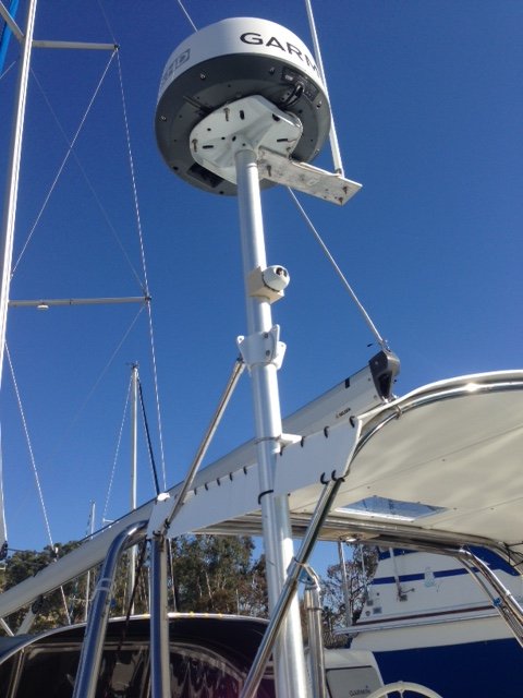

My radar and vhf are mounted to a short mast mounted to the arch. I wonder if the ground plane set up by the arch is helpful to signal strength? Anyone else have an arch mounted vhf and radar and bonded arch?

neither radar nor vhf need a ground plane.... My radar, AIS antenna and second VHF are mounted on a stern mast. Where did they put your radar on the arch? unless you don't have a traveller I'm surprised it fits.

Radar is mounted to a mast on the arch. To ask again, does anyone have a ground wire connected to the arch? I think I’ll disconnect the wire from the arch and see how the radio range is affected.
