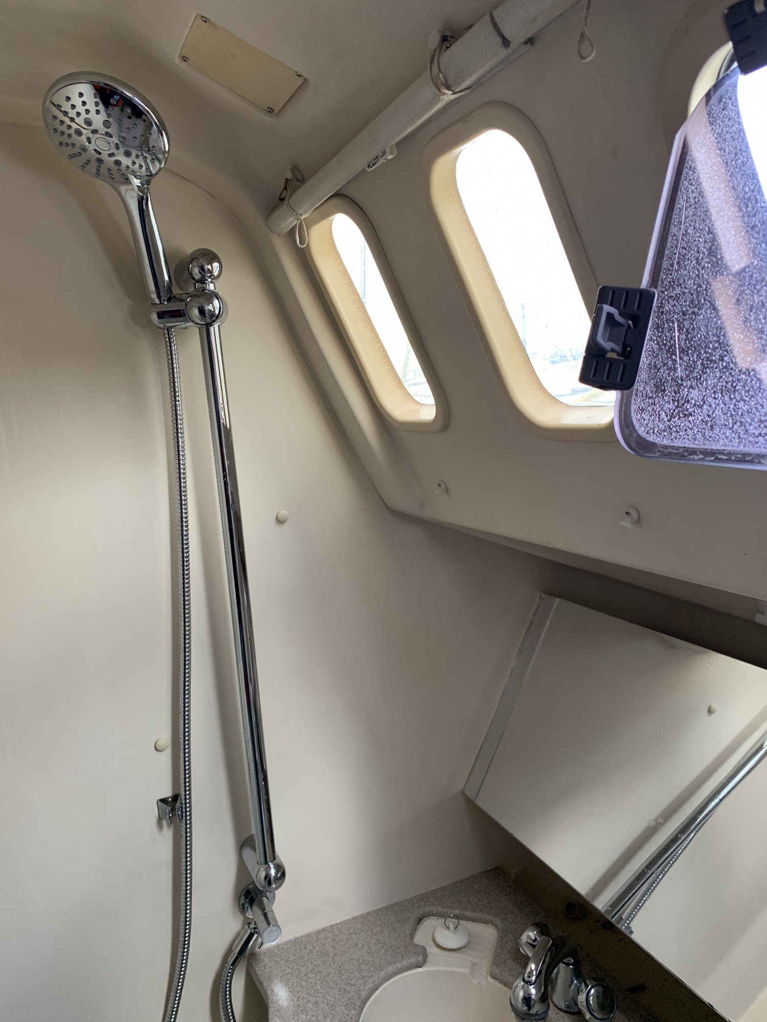

James,
My hose runs from the center of the faucet set up under the mirrored vanity and over to a bracket holding the shower wand above the toilet. So no kinks, in fact the hose and wand are like new. It’s the lift-up connection between the hot and cold faucets that’s the problem.
I really would like a nicer look to the faucets, but I think I’ll have to go with the original design replacement. Height is an issue also as the mirror opens down over the sink.
I just hoped someone had a better retro fit done to their boat.

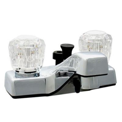

Kloudie,
I like the design of the faucet you highlighted. I'll be at the boat later this week and get my dimensions. The overall height of almost 6", seems to tall to me. Once the shower wand is attached to the center post fitting, the drop down mirror is the issue. I've already adjusted the chains that hold the mirror, the most I can and still have an easy reach into the cabinet behind it.

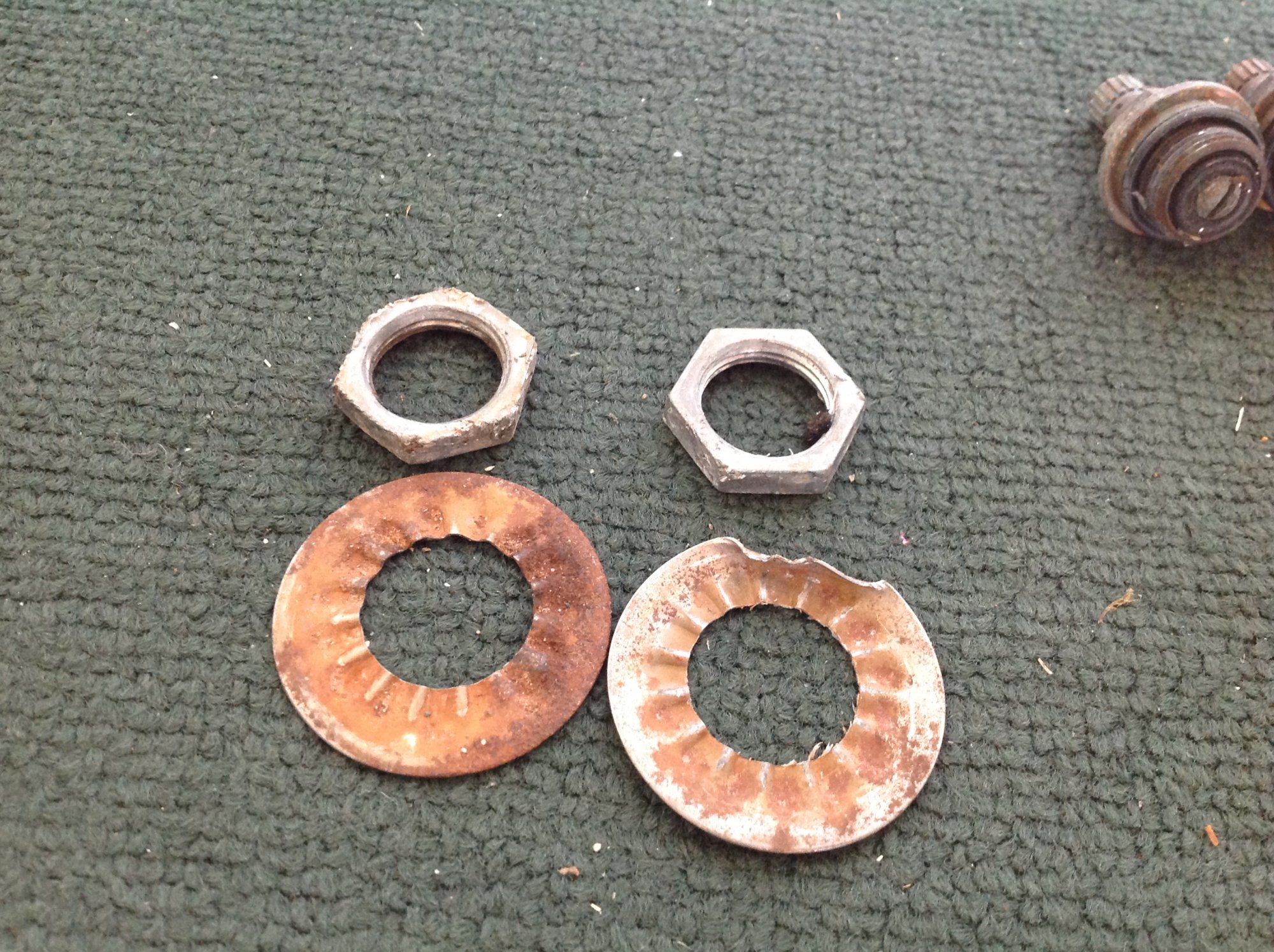

I don’t know if you have completed the replacement of your faucet set yet or not. I have a few tips for you.
First is be prepared, on my 2000 340, they used galvanized metal washers and nuts. (I found a picture of the setup I had under the counter)
Removal was nearly impossible. I thought I could simply unscrew the nut. They were rusted and frozen on.
There is very limited space to use a wrench under the counter given the shape of the bowl.
Rust penetrating removers didn‘t work for me. They just dropped off and added more of a mess.
I removed the handles and the shower wand. With those off you can pry off the chrome covering.
Then I cut the plastic between the faucets. This lets you use a plier to hold on to the nut on top.
Use a lock plier under the counter to hold the nut and turn from the top to loosen the connections.
Remove the door to cabinet for more area to work in also. It helps, not the most spacious of places to work in.
Your new faucet set will have plastic nuts to hold the faucet on. BUT, they are bigger than the original galvanized nuts Hunter used. So be prepared they may not fit completely flush to under the counter. Mine didn’t.
Have some Plumbers Putty handy. A small amount placed on the nut will fill the void and seal the faucet to the counter.
Hunter used some silicone sealant under my faucet and in the holes to hold the faucet tight. You’ll need a razor blade to remove the excess from the counter and the holes. They were very free with the silicone back then.
I hope this doesn’t scare you away from the job, it’s not as hard as it might appear.
