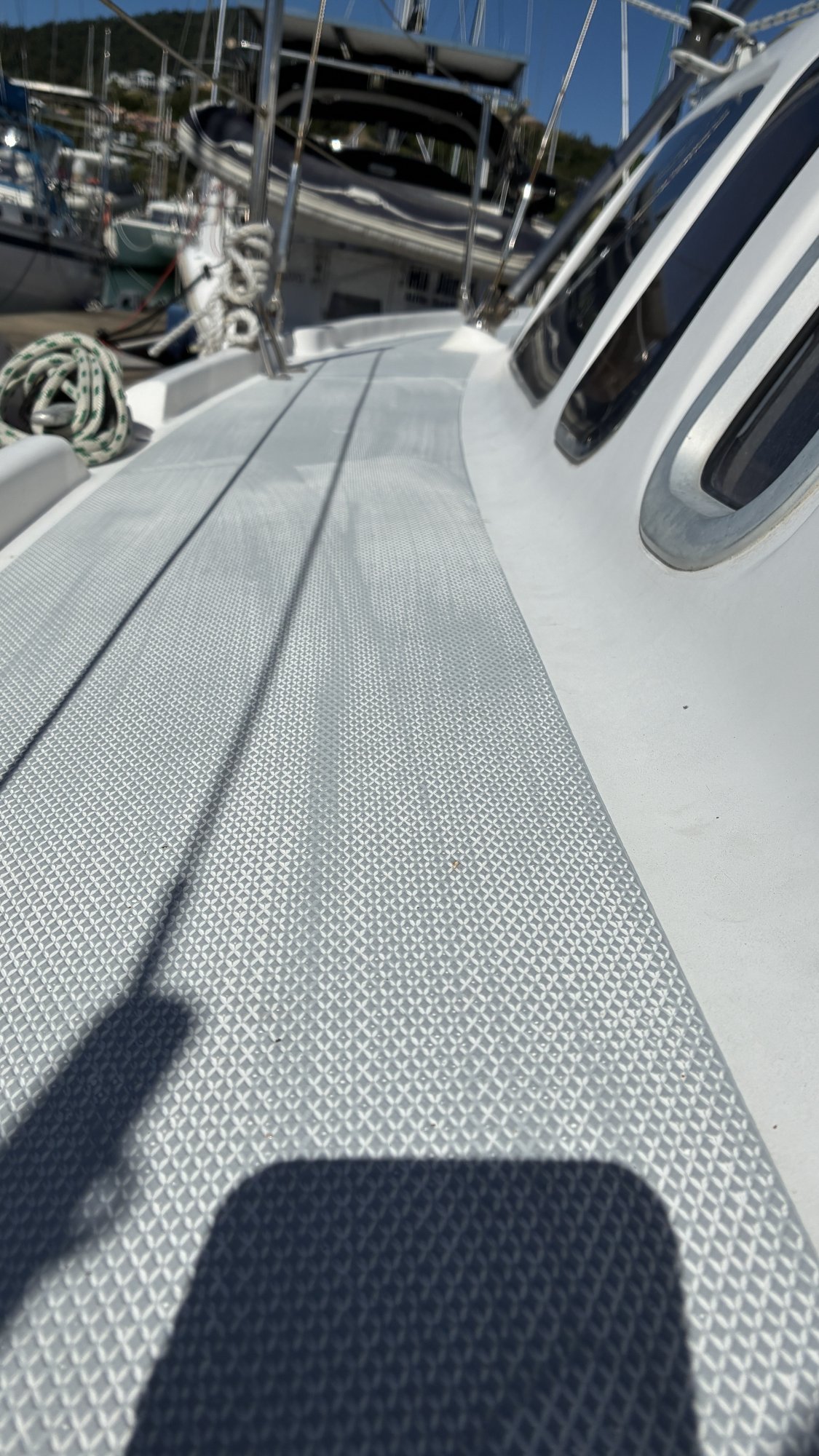

Hi Folks,
I have a 1999 Hunter 340, and as per the pic below, not sure what previous owner did here... but looks like he tried to use way too little deck paint!
It's an ugly mess and high time I sorted it.
I really like the original factory impregnated non skid, and would like to retain it if poss.
I'm considering a product from here 'down under' called Kiwigrip (made in NZ) which seems quite popular.
They recommend their special 'stipple' roller to create non skid 'peaks and troughs' on a completely flat deck, but in my case, this would ruin what is already there. The product is also quite thick, (think porridge) but can be thinned with up to 10% water.
So... here's my plan:
1. Light (and careful) orbital sand to key the existing impreg deck tread.
2. Acid deck wash/thorough rinse.
3. Detailed mask up
4. Thin Kiwigrip with 10% water to allow flow into existing deck pattern.
5. Hand paint with quality brush, spreading it out to retain the existing moulded non skid. (Product apparently only needs a single coat... but I wouldn't want to go too thin.)
Please let me know if you have an any similar experiences with refurbishing the Hunter factory decks, OR... have a far better idea re product recommendations / application / whatever???
I'm all ears folks cheers.

Hi Joe,
Thanks for the detailed response mate cheers... and I noticed you're from Mission Bay SD. As an aside... while backpacking the World in the early 90's, I worked as a sailing instructor for a cuppla months at the 'Mission Beach Sports Centre' I think it was called. It was a really big show, all aquatic based training progams, probably employed 20-30 instructors... and I loved every minute of it. Wondering if it still exists?
Anyway... back to my deck.
Great to hear you've actually used the Kiwigrip with great results. (I'm too scared to flip the lid off my tin until I work out a plan.)
My pre patterned factory non skid gelcoat deck is actually in really good condition. Which is why I want to keep it 'as is'.
The very thin coats of 'grey whatever?' the previous owner applied is also in really good condition with no cracking or peeling. He just used too little paint.
So my 'challenge' here is pretty much cosmetic/aesthetic.
The reason I was going to go with thinned down Kiwigrip and a quality brush, rather than their stipple roller, is that I figured I could carefully 'run' the brushstrokes out a bit to retain the highs and lows of the impreg pattern and minimise 'pooling' of the product in the troughs.
I know 'brushing out' will result in a pretty thin layer, but a combination of the rubbery Kiwigrip and the existing gelcoat pattern should hopefully give me a good looking result that is grippy under foot.
Bearing in mind that as my serious ocean racing days are well and truly behind me... should myself, my crew and my boat ever experience conditions where we are 'heeling' to the point of requiring perfect non skid to stop us all sliding off the deck... we'll be immediately dropping sails, starting the motor, and racing back to the Marina for a 'Brewskie.' Cheers for your input mate. Happy Sailin' - Marky Mac

To me, your deck looks like the factory applied grey gelcoat in the mold in the non-skid areas, then sprayed the entire mold with white gelcoat, and the grey gelcoat has worn off the tops of the non-skid pattern.
If you are sure a PO applied paint, then why not just use a paint remover to get rid of it? Then you would have your factory non-skid back, which you say is in good condition.
I've never used kiwigrip, but have been on several boats with it. There is no way, nor any amount of thinning, where kiwigrip is going to work with and maintain the existing non-skid pattern. It will completely fill and level it. Even thin paint is going to do so to a large extent.
Since your existing non-skid appears in great condition, one option is to take molds from each section. This leaves you with two choices:
1. Use those molds to make new non-skid panels with the gelcoat color of your choice, and glue them on.
2. Use those molds to apply new gelcoat on the existing non-skid. This would be done very carefully by waxing then spraying the mold with PVA, thinly coating both the mold and the prepped non-skid with gelcoat, and setting the mold down evenly back into the non-skid with some light weight on it. When it cures, you should have gelcoated non-skid again. It is likely you will have some pulls, but these can be spot-repaired in a similar manner.

Marky, I believe you're over thinking this project. As I stated in the earlier post, using KiwiGrip in the manner you propose is unnecessary. If you don't want my opinion, I suggest you contact the KiwiGrip folks and submit your idea to them. Once you open the can an see the product, once you touch it and spread it out...it will be unbelievably evident that it's NOT paint.
So.... fill in the hairline cracks with thinned primer. Then lay on a coat of non-skid paint... adding grit as you see fit. The paint will take on the bumpy contours (you'll want to experiment with thinning, of course). The primer should have been adequately thinned to fill the cracks, the paint should cover the deck in thin coats.. non-skid paint has dull, non-glossy surface. On purely flat decks, with no molded non-skid, the grit element is added for the grippy finish. You may or not want to do this.'
Choosing to use the Kiwigrip will completely change the character of your deck... for the good! You'll no longer have any bumps... the surface will look brand new. So don't waste time and resources trying to get me or other users of the product to support your unusual plan. Good luck....have fun...keep sailing.
