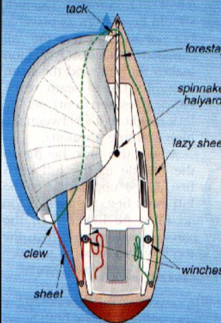

Hi All, I recently purchased an asymmetrical spinnaker for my H340. Not sure how I'm going to connect it to the boat. The head will connect to the Spin Halyard, but the jury is still out on how to best connect the tack and the clew. Any thoughts?
23,803
:plus: @sail sfbay That rig looks pretty good. Will want to be certain you have a adequate connection for the tack at the bow. Light weight lines for the sheets. Be sure the sheets are long enough. I think they are 1.75 to 2 times boat length.

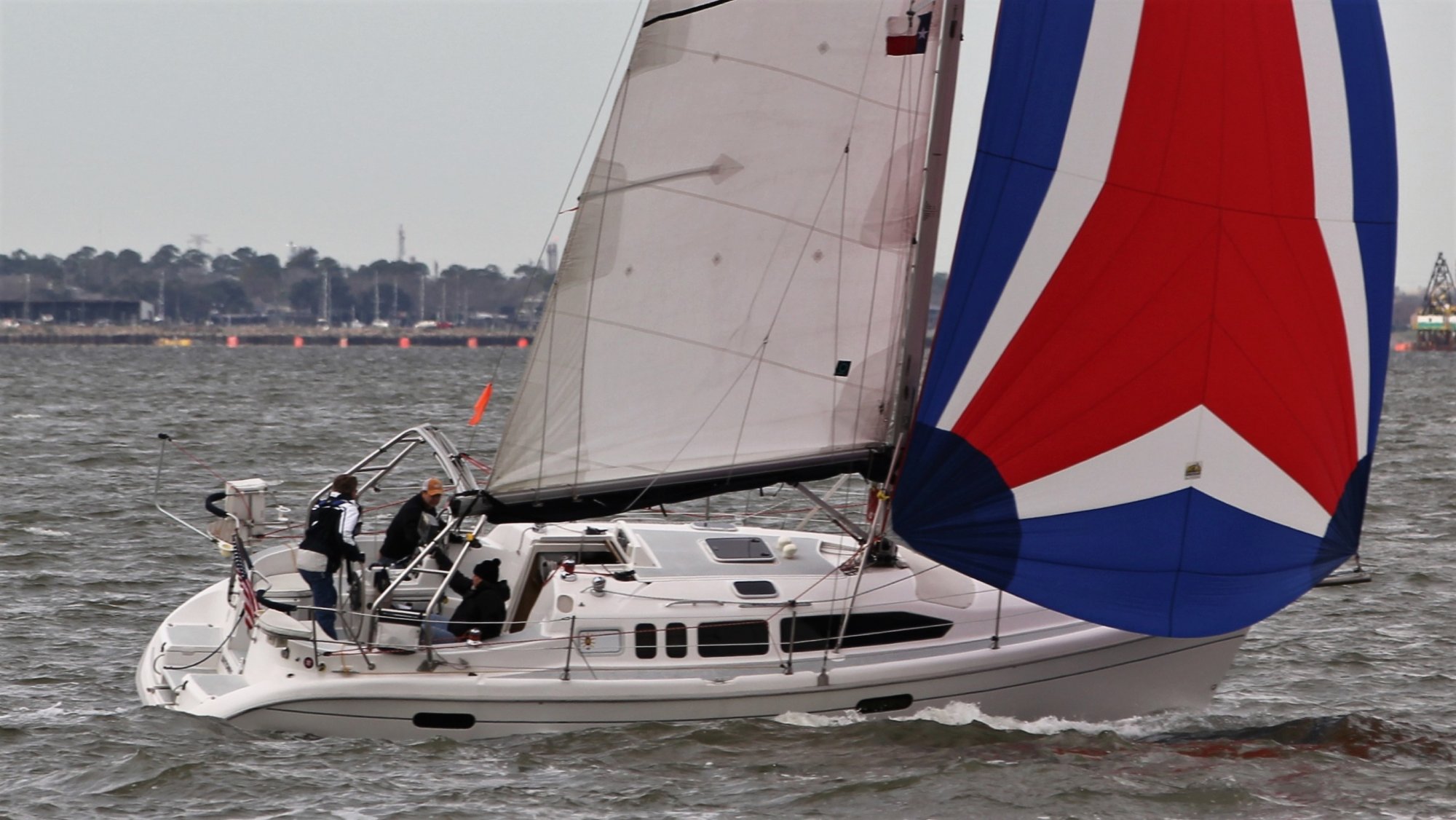

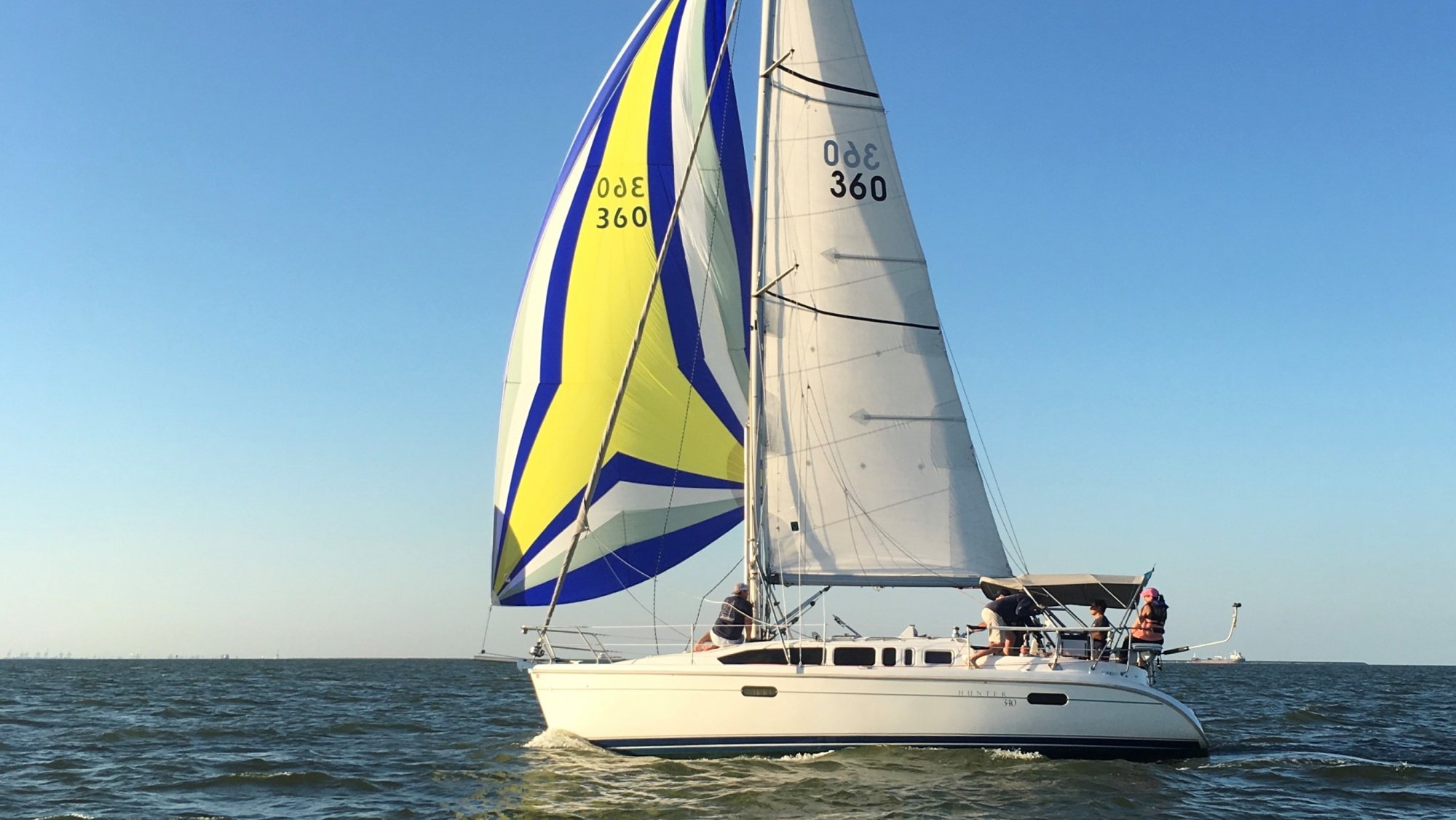

Hunter 340 Baytown TX
I have a Doyle UPS that came with the boat and a code 3 I bought locally a couple years ago on my 340. I run the sheets through a block on the loop on the back rail to winches I mounted on the coaming. I attach the tack to a homemade bow sprit on the anchor roller. We've had them up in pretty high winds and have had no problem with the sprit tied to the anchor roller. I use twings on the UPS.
