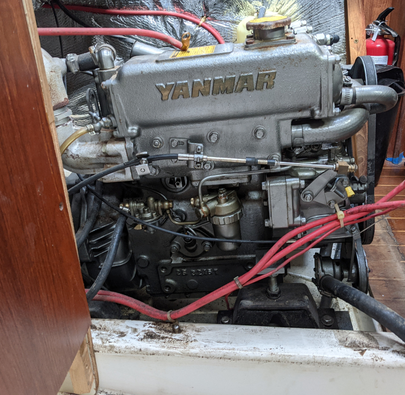

Like@Hunter34Austin I plan on making a frame out of what's left of the starboard side of my engine box. PO had already cut a big hole into the panel for previous engine work and didn't cover it. I'll be adding a "hatch/panel" of 1/2 marine ply, covering it with epoxy and glass, insulating the engine side of the panel and attaching to the frame created from the old panel. Looking for fastenings that will provide tooless entry. (any suggestions?). Thinking about doing the same to the port side as well. Also might do same for the walls of the quarter berth which are missing having been removed by past owners.
