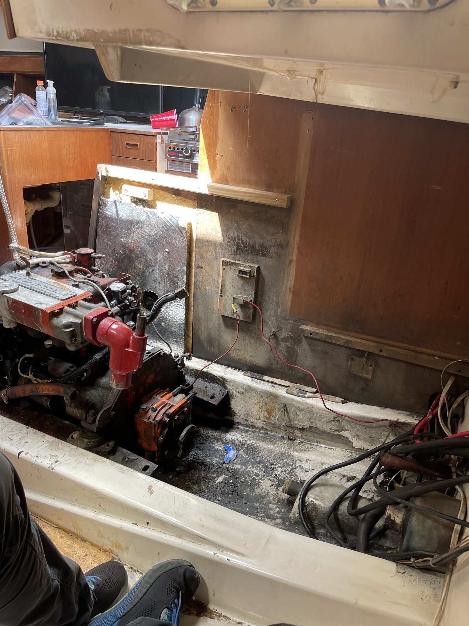

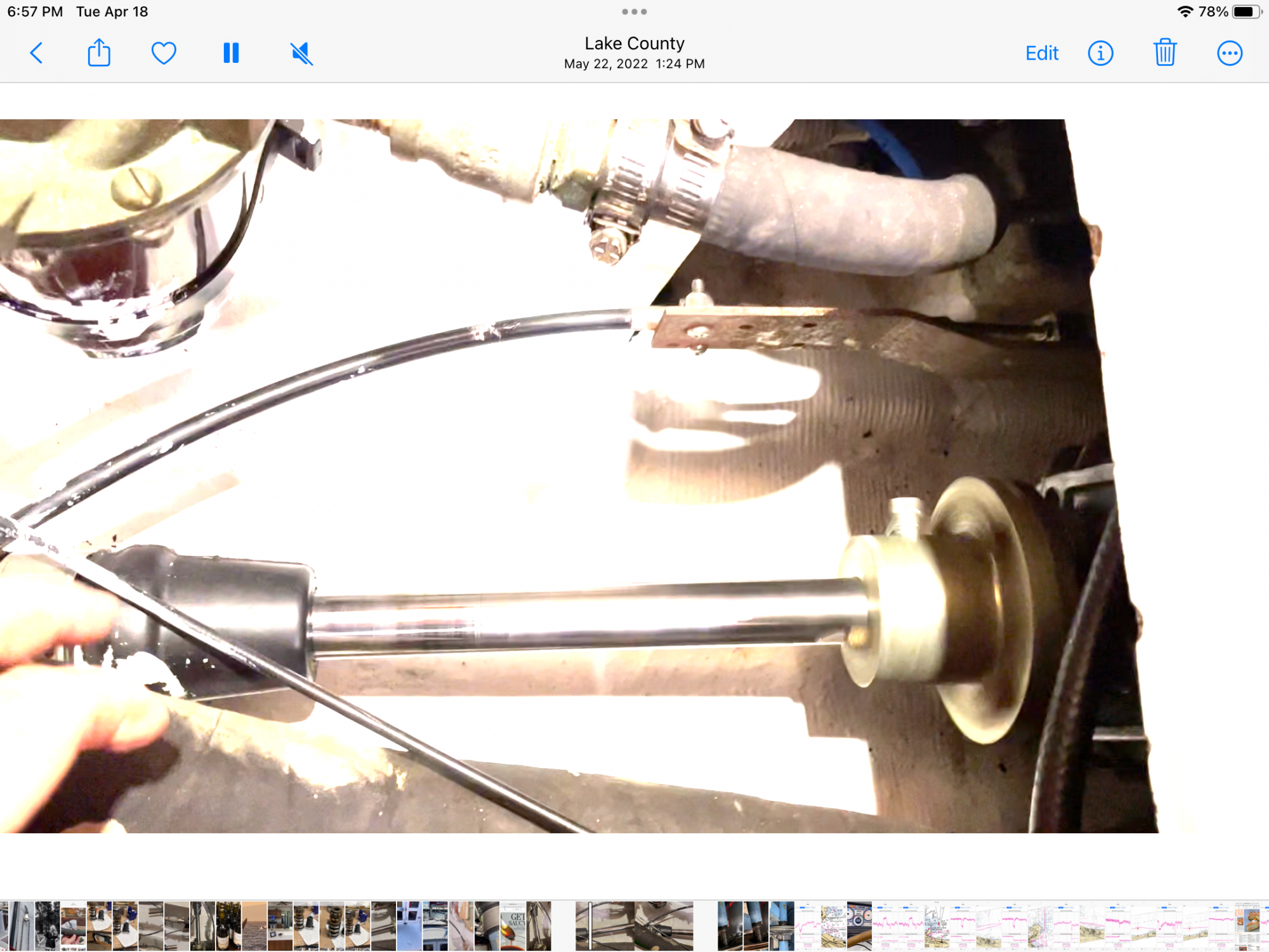

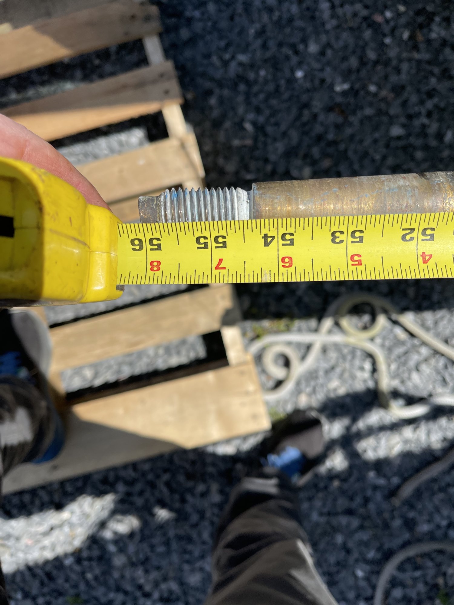

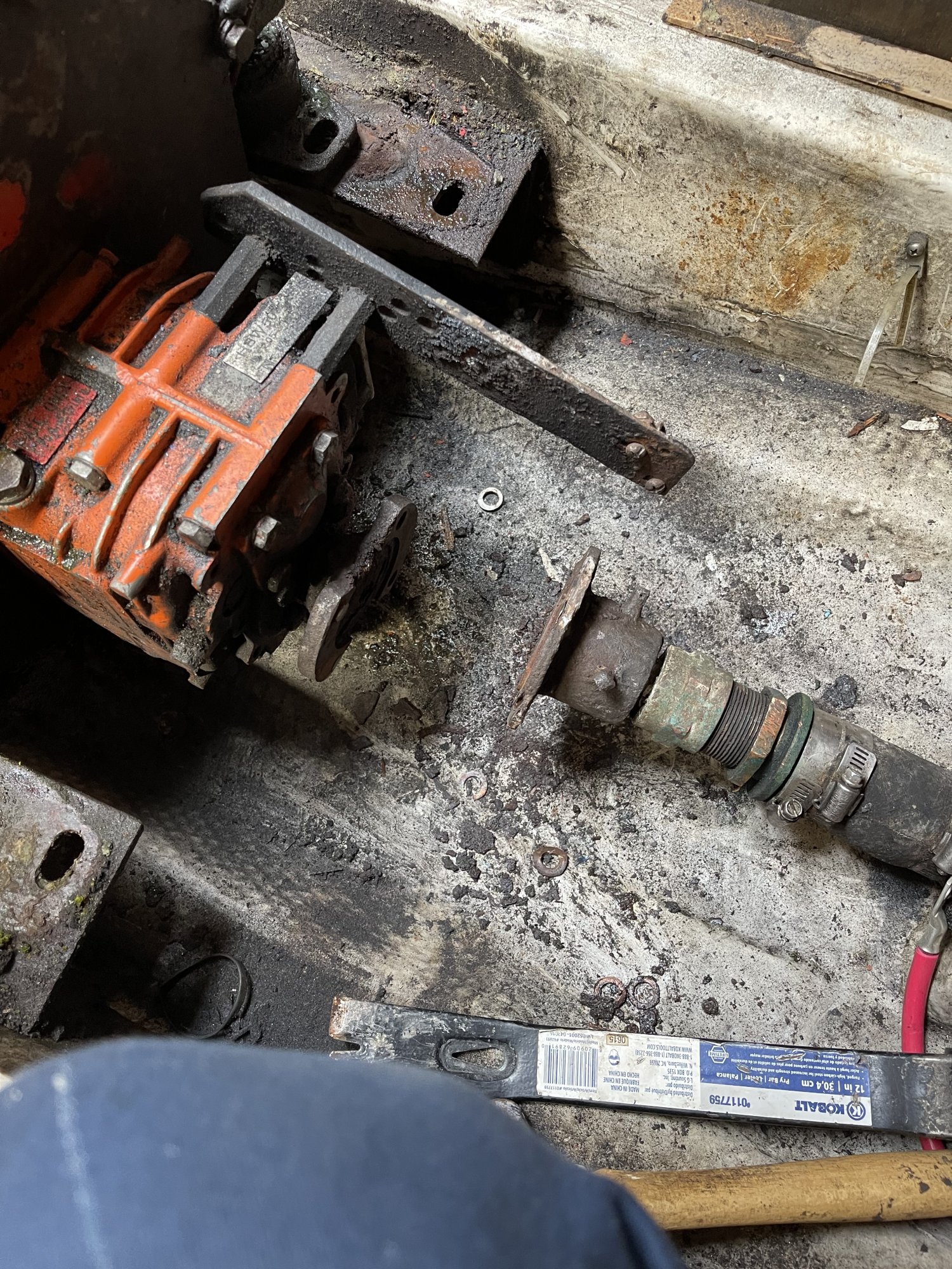

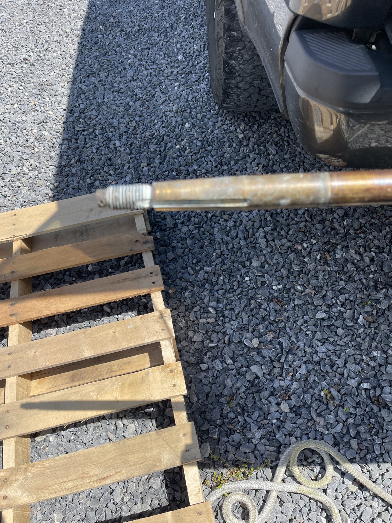

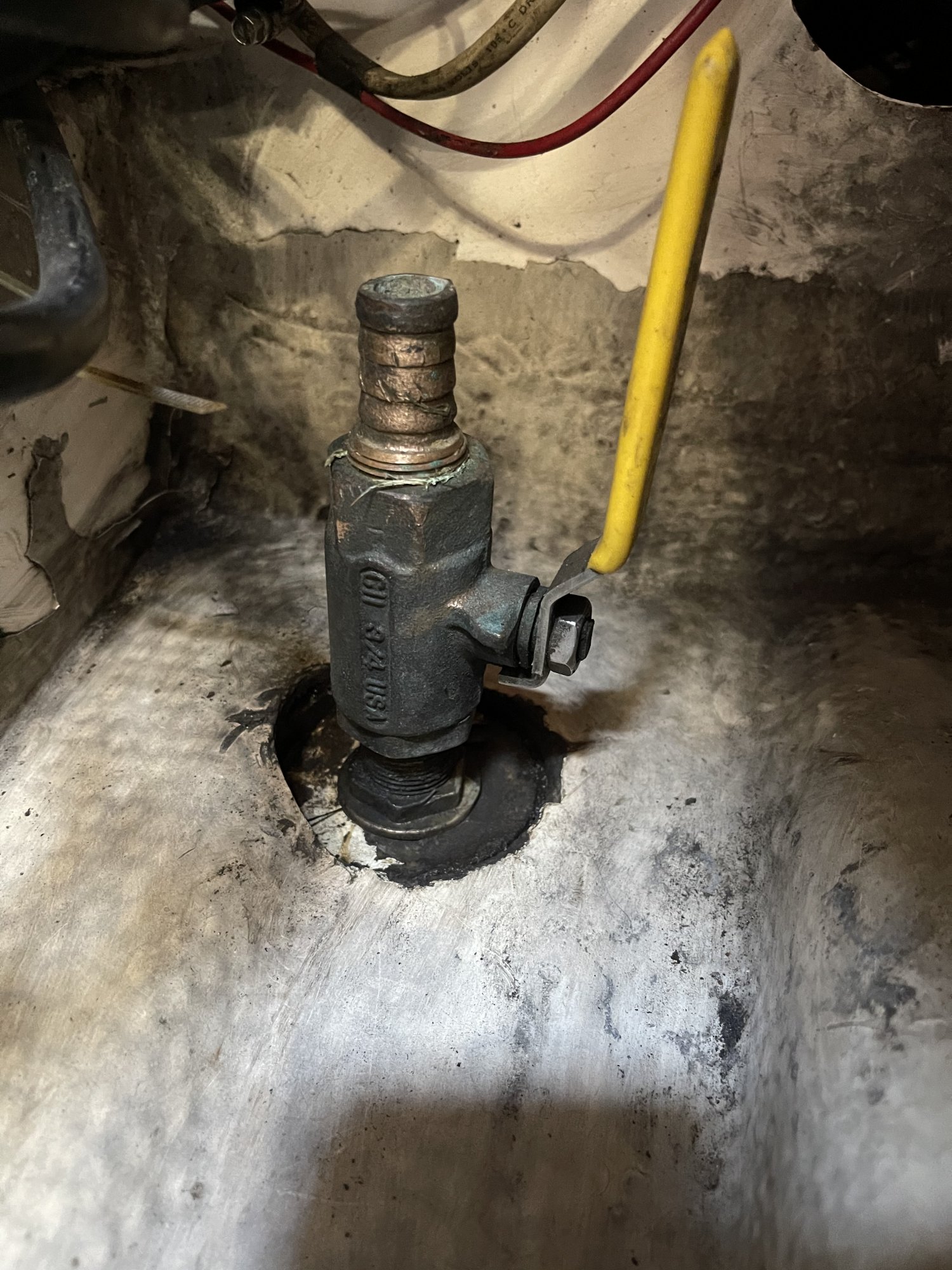

Just thought I would share some pictures in case anyone is interested in details about the shaft and coupling.

good pictures, cdells. I see you have one of the earlier H-34's with the Westerbeke 4 instead of the Yanmar. The shaft taper fit at the propeller is an SAE standard fit.. Note that the small nut on the prop goes on the shaft first .. Also check out MaineSail's prop shaft installation notes..
