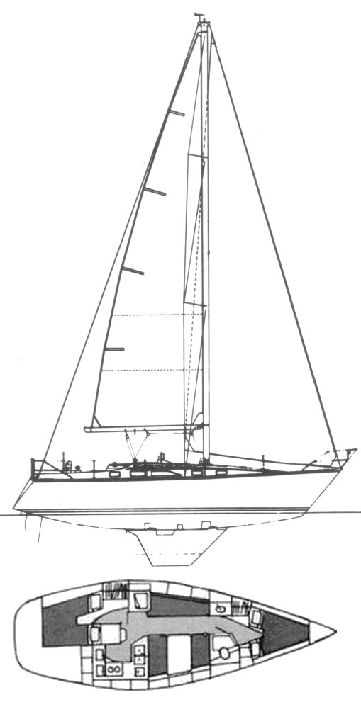

The Hunter would be better for 4 people that used it in the marina as a small condo. The true dual staterooms give it that honor. ALL C&C of that vintage had an exposed small-to-big quarterberth aft. For all other purposes sailing, looks, and resale, the C&C is a better boat and a better choice.

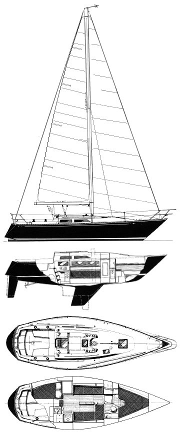

I'd vote C&C. The aft quarter berth appeals to me. I also prefer the 2 full length settees, so the admiral and I can stretch out on each one while reading, etc.

Not having any idea about either boat, just looking at the line drawings Simon has posted, I like the bottom profile of the C&C and the raked rig better with the straight spreaders better too. The C&C just looks like she would sail better on all points of sail. I would be inclined to choose the CB but the fin looks like the better foil.

C&C hands down. Better built, better looking, more fun to sail.
If you want a dock queen instead, then get the Hunter.

I am biased since I made that choice many years ago... The H-34 has more room, so if you are going to have guests aboard, more room is good. I had two boys when I bought the boat back in '91,and wanted the extra room.. I know that Hunters don't have stellar build reputations, but I don't find things that are shoddy in the old Courtland Steck designs..(other than the mast support beam water problem) The old 34 is nimble and sails well to her numbers.. I have a buddy who has a C&C 34, so I am not blowing smoke.. I know the PHRF numbers sometimes aren't useful for anything except handicapping, but check that comparison out for a "rough racing" speed handicap..
In warmer climates, the opening ports (9) on the H-34 cool the cabin MUCH better.
EDIT: The C&C was supplied with an Atomic 4 gasoline engine.. they are good engines but the old Yanmar 3GM's that came in most of the H-34's have a much better reputation.. Yup, I helped my friend repower his with diesel.( Some early H-34's had a Westerbeke 4 cylinder diesel)

Having owned a C&C for 20 years, I suppose I'm a bit biased ;-) I raced a centerboard C&C 34 for a couple of years and it really was a great boat. Solid build, sailed very well, easy to handle and the finish below was quite good for that vintage. Comparing these two on the sail calculator http://tomdove.com/sailcalc/sailcalc.html they are almost identical. My guess is they will feel similar under sail except the C&C is a bit lighter with less sail area, could be slightly easier to sail and more nimble but that would also depend on how each boat was set up. The finish and quality of the C&C may be a bit higher but the interior of the Hunter is a more modern design. I'd go C&C, but like I said, I'm biased.

Wow, 2 different design philosophies . Familiar with both boats. H34. Much better interior layout. Cons- leakage under mast step cause compression post problems. Water gets into grid with no way out. Delam in grid. Iron keel is a maintenance headache. Biggest problem is build. Friend had one and it oil canned so bad in 35knots and seaway that it was virtually unsailable. C&C 34 is a bit tender. Interior is small. Cockpit ergonomics suck. Light air performance is great but you need to reef early. Diesel is a big plus. Construction is solid . Boat sweet to sail. Genoa’s are large so loads are big. Look at the size of the primary winches. Club racing-C&C. Light coastal cruising or dock queen- Hunter
