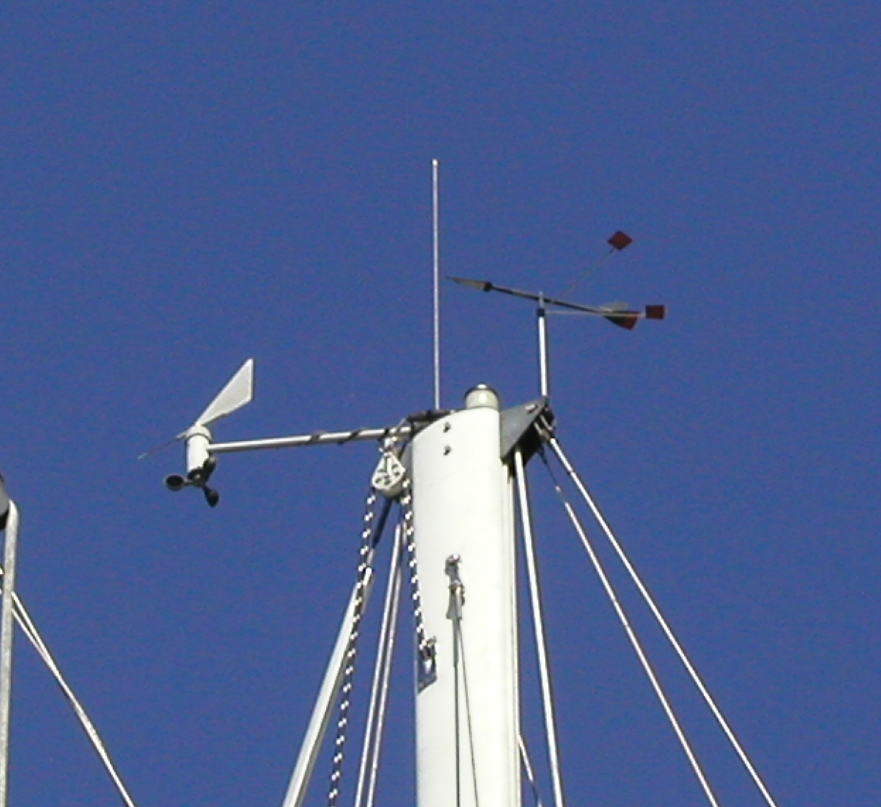

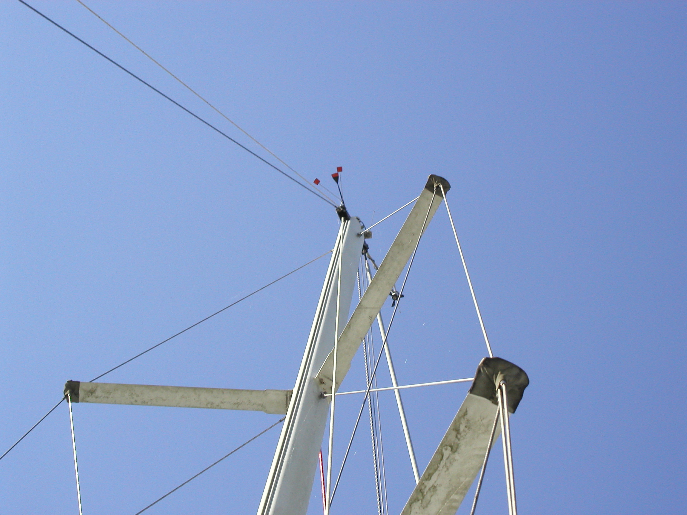

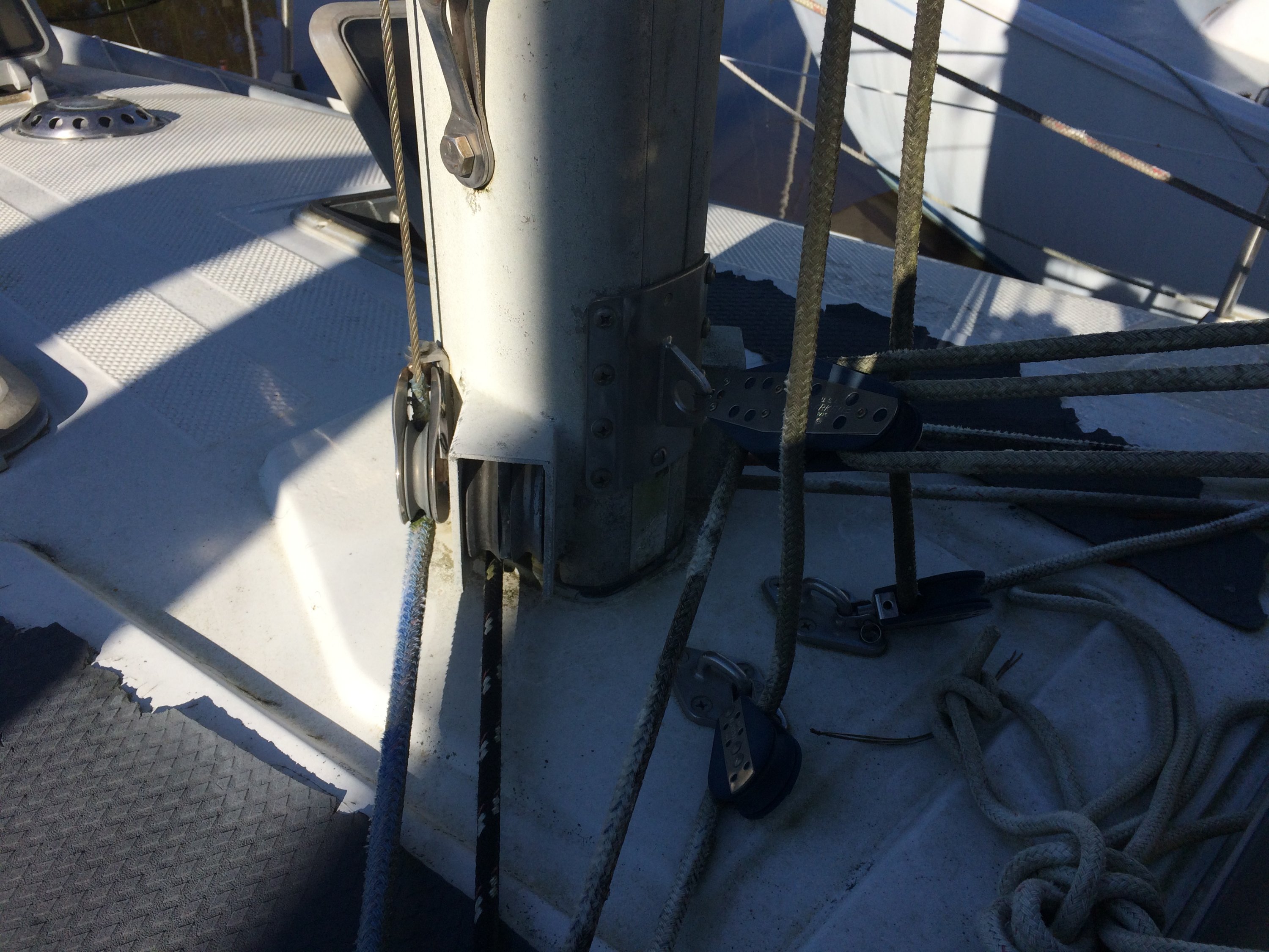

Here is what I have.. not much help, I am afraid:
My main halyard exits the base on starboard side out from the base roller.. (picture is of port side) Pull the pin carefully and take out the rollers and spacer .. not going to be easy! Someone with a bent coathanger can tease the messenger line out the base then run the halyard.. then re-install the sheaves
