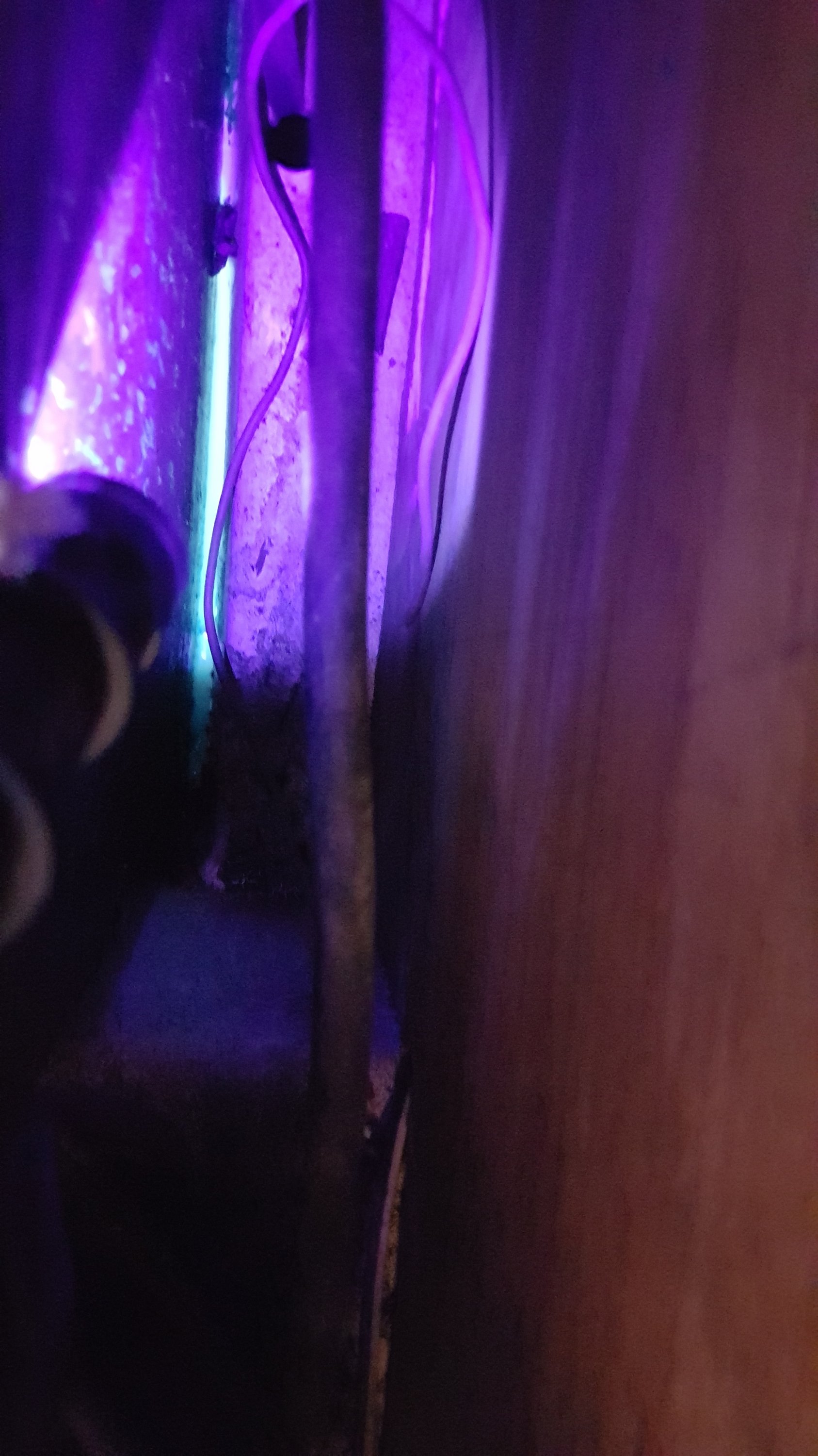

Have any of you H34 owners had to replace your fuel tank? Were you able to remove it through the lazarette opening or did you have to go through the aft cabin?
What did you use for a replacement tank? Custom fab aluminum or plastic?

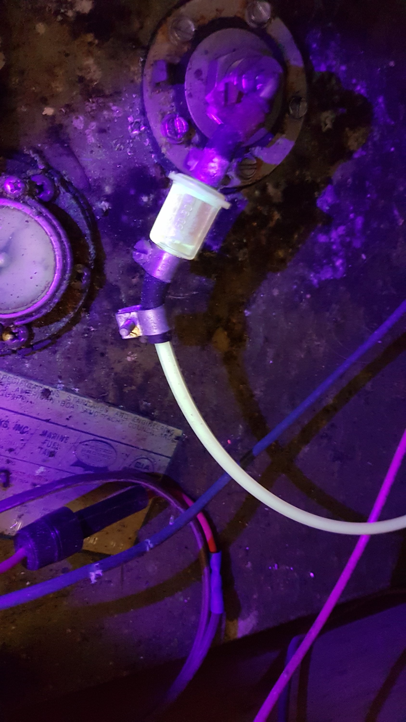

Do you happen to know of auppliers in Canada? I have been trying to track down a small (but smellable) leak and ended up using a UV fluorescent dye and small UV flashlight. Looks like there is a band of diesel along the base of my tank. Photo of the band and positive reference photo of the fuel take off line for the diesel stove. Same fluorescence. Nothing leaking at the fittings so methinks my tank has lived its life

Just realized I hadn’t replied with a follow up. I had to open up access through the aft cabin. Not a problem taking it out and not a problem putting the new one back in.
None of the plastic manufacturers would make up a tank out of plastic. I had an aluminum fabricator make up a tank out of aluminum. He did a really nice job and pressure tested it. He also made it out of thicker gauge aluminum. It has not been a few years and it is working great.

If only it were that. There was visible corrosion on the tank and the fluorescent dye I put into the tank showed it. Swapping out a hose would have been a whole lot less work. Later models of H34 have plastic tanks but I have an early model. The good news on the early model is that the mast sits on a big broad base and they don't have the compression post failures that are associated with the H34.
