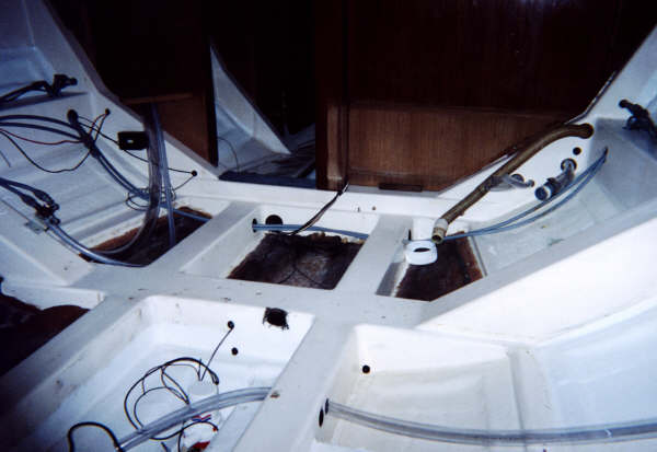

10,244
I agree The hollow grid beams have limber holes for drainage and pipes and a few wires.. Attached is the center section of the boat showing the limber holes.. One of the forum members' boats.. sorry I don't remember who..

If so inclined after purchase you could cut open false bilge area in the H34. Here is a link to a previous post on H34. Also search forum for replacing cabin sole on mid 80s model.
Dec 14, 2003
1,450
As per Klaudie the limber holes should let the water flow back down to the bilge area so only the floors would be a concern. Big job however as the settees have to be removed.
As per jmce1587 the false bilg issue would be a good thing to investigate as you are in a freezing area and water in that false bilge could cause damage. Several posts on this issue. attached is how I addressed the situation.

First project should be cut away the false bilge and flush it out. All the fiberglass stringers should have limber holes. I would fabracate a flexible 3-4 foot hose maybe 1/4 inch diameter with lots of pin holes thru it that is caped at the end, and attached it to a garden hose. Use it to spray and flush out everything. Snake this into the limber holes and any place you can get access to.
