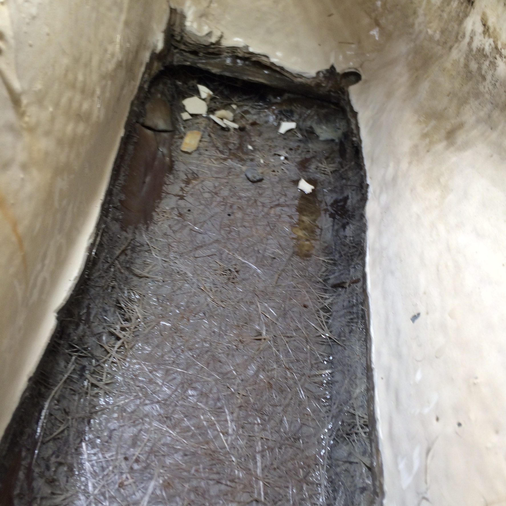

Just started new winter project false bilge issue. Have owned this boat senses 1983 well Over 30 plus years with this false bilge issue. I have always kept the bilge clean, always flushing it with fresh water and cleaning products every weekend.
I never could get rid of this foul odor that seemed to come from the bilge no mater how clean it was. I found a post on this site about false bilge and think I have finally solved the mystery. After probing the bilge liner (aka false bilge) I drilled a small hole into the liner and found that water was trapped between the hull and liner. Used a right angle Dremel tool to cut out the bottom of thr bilge liner and removed it. Found under the false bilge a 30 plus year old piece of rotted play wood along with 30 plus years of the most disgusting layer of sludge. The odor of that sludge was horrific. After flushing the area with bleach and other cleaning products the odor seams to be gone. Next stage will be to paint the area with bilge paint and reinstall the bilge pump and float switch in the spring. A few weeks after I started the project so far no more odors. Looks like the mystery has finally been solved!

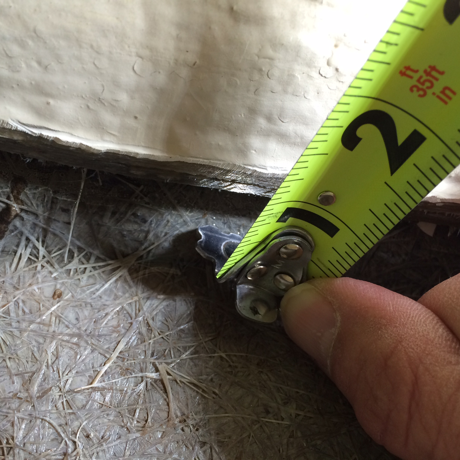

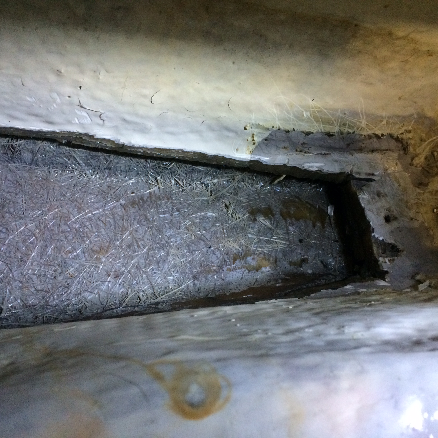

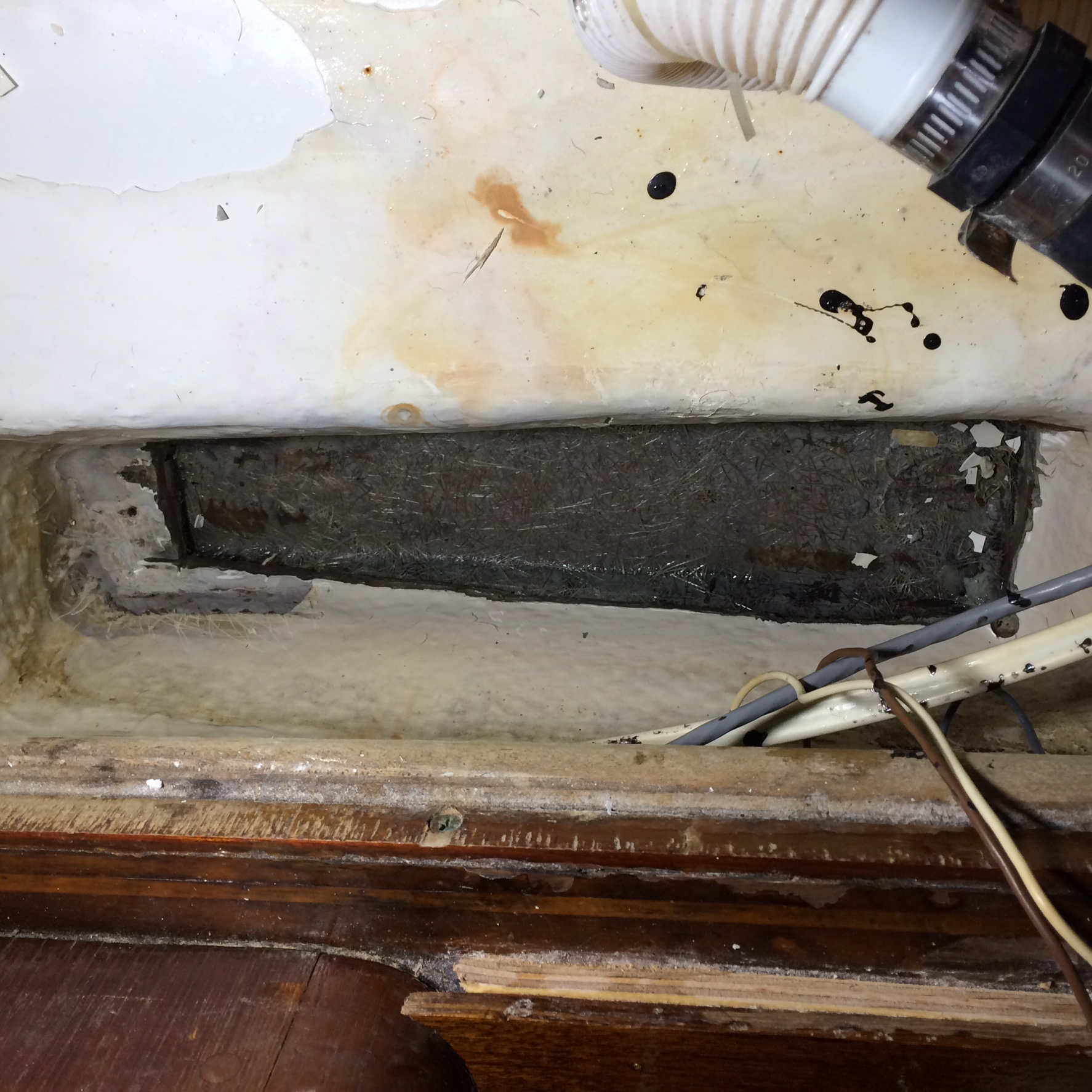

I just found some pics of after the false bilge sect has been removed
Hope this helps.
As I posted previously on the bigger boats section I have my on going project along with other projects I have done.
Unfortunately i am new at this form page and I was told that I posted this thread in the wrong section. Now most of the post are in the bigger boats sect.
Never the less hope this helps.

Yes, and not just water. I had 30plus years of the foulest smelling crud and water you can ever imagine. I thought one of hunters workers got trapped and died in there and decomposed. That's how bad the smell was. Omg!
So far after I did the mod and flushed it out, no more issues knock wood. Still I work in progress, have to reinstall pump and float switch.
