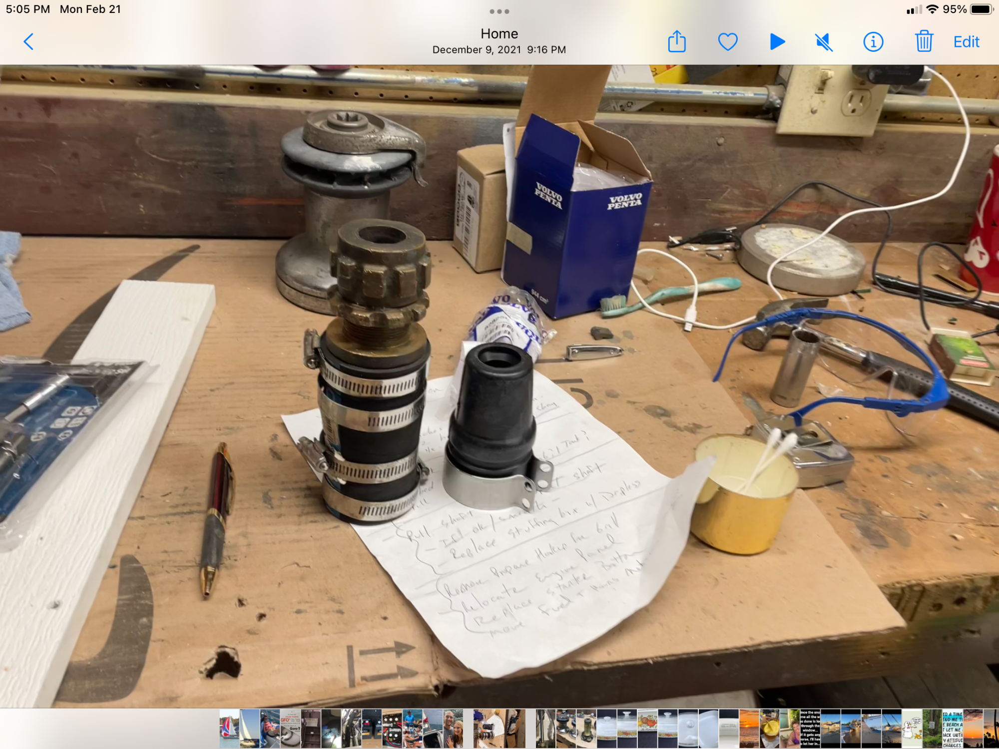

Have had a Volvo shaft seal on my boat for 15 problem free years; has never leaked. Just lubricate it with Volvo grease annually. Mine is overdo for replacement now.
Good to hear. Looking forward to launching in April and seeing how the Volvo shaft seal works.
Big difference in the length between my traditional stuffing box and the new Volvo!
