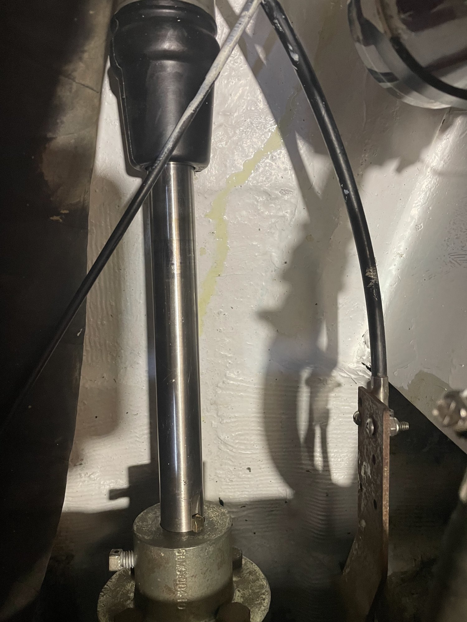

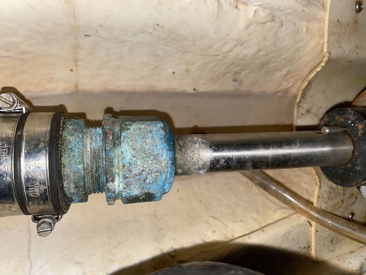

My 2005 H33 has been slowly accumulating water in the bilge over the course of the winter. We are in the lower Chesapeake so she isn't hauled out - just winterized in the slip. After confirming the bilge water is salty, I traced it back to the stuffing box. I would say it drips 2-3 drops per minute at best (not running - engine is winterized), around the underside of the threaded portion of the stuffing box, just before the stuffing box nut. I've been told by local dock neighbors this stuffing box uses shaft seals and not flax packing. I'm hauling the boat out for bottom cleaning, zincs and overall inspection and was going to dig into the stuffing box while it is on the hard for 2-3 days. Does anyone else have a 2005 H33 and have details on their stuffing box makeup? The shaft is 2 1/2". Thanks!

That certainly appears to be conventional to me, clean the threads and nuts using brass wire brush and soak with penetrating oil for a day or two. Loosen lock nut while holding packing nut in place then tighten packing nut just a little, 1/8 of a turn maybe. Retighten lock nut while holding packing nut in place.
