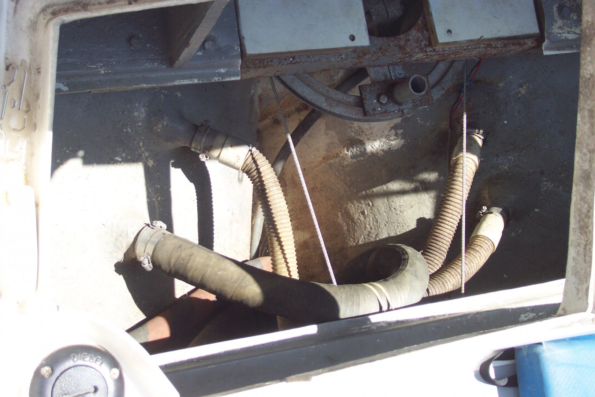

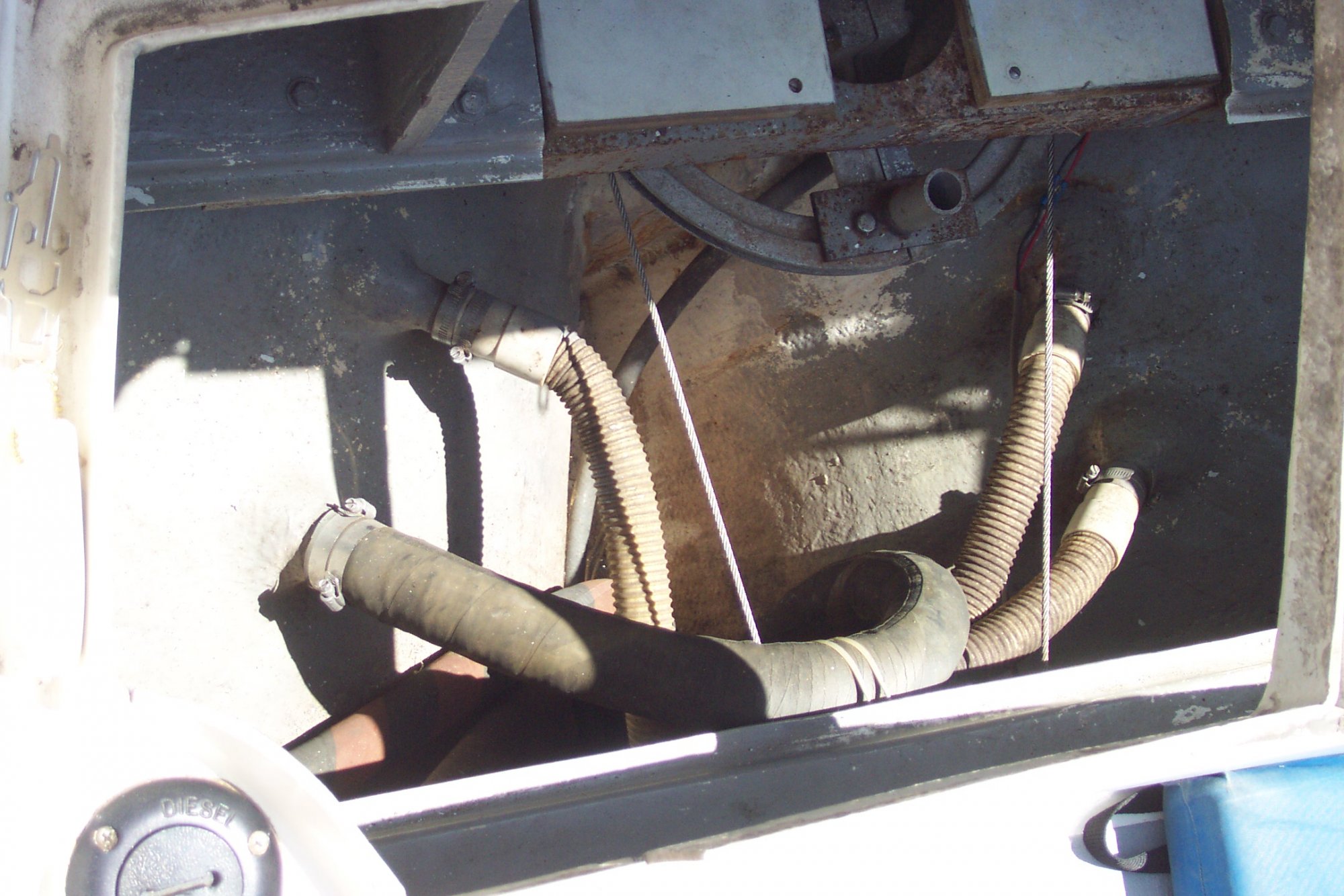

On my boat the stop is on the rudder shaft quadrant. You can see it in this picture I took while renewing cockpit drains.

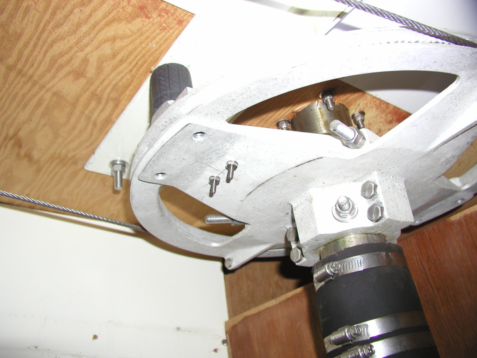

Must be a stop.. here is the one on my 34.. Angle iron bolted to underside of lazarette that the stop hits..

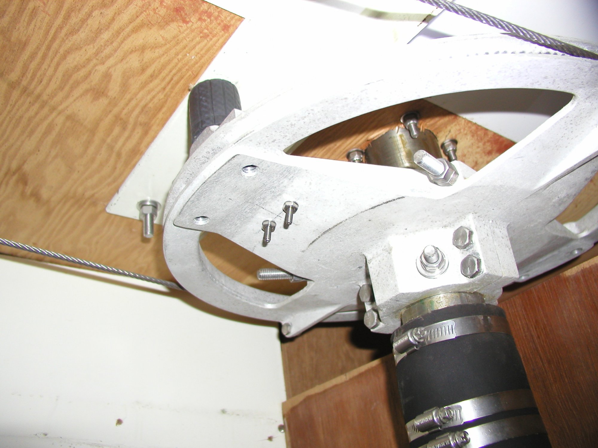

My 1979 Hunter 30 C did come from the factory with an Edson system.
The stop was a male projection (think plastic prescription medicine bottle sized),
attached to the quadrant and was stopped by a block of 2x4 attached to the deck.
Not elegant, but it has worked flawlessly for 41 years.
