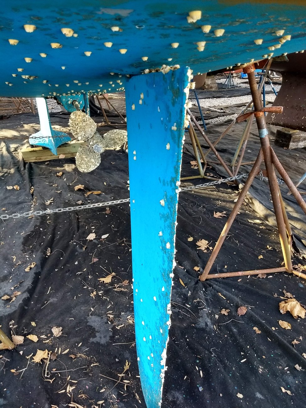

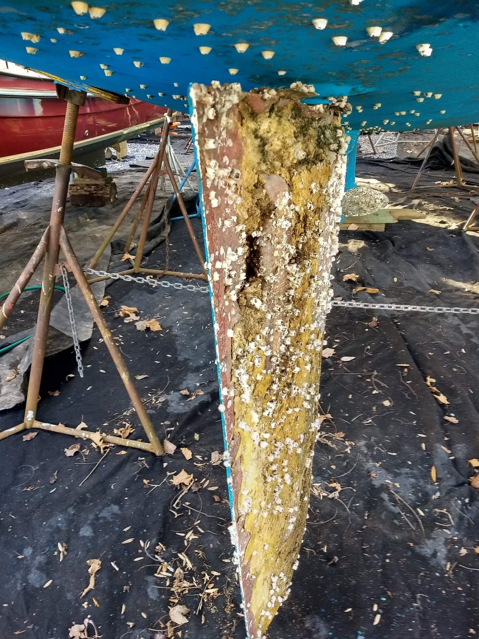

We keep our 2008 Hunter 33 in the Severn River, Maryland. We pull it every other year. When our marina pulled the boat in Nov 2017 they contacted us to say that half of IMG_20181203_150318818_HDR.jpg IMG_20181203_150315163_HDR.jpg our rudder fell off. What happed is one side delaminated and fell off. We have an estimate to replace of $4200. Progressive insurance would not cover it. It could happen again. Does anyone know of insurance that would cover this problem?

Are there any fragments of fiberglass on the ground below the rudder? I am wondering about the two of the holes in the foam at same level in the middle.
Noticed barnacles on damage area. Do you have any other photos of a close up of the edges. What is cost of surveyor to look at the rudder. Did insurance company send out anyone to look.
I bet something hit that rudder. This is why for detailed rudder edge photos and hull too. In my years as a dealer I never saw anything like that delaminating
