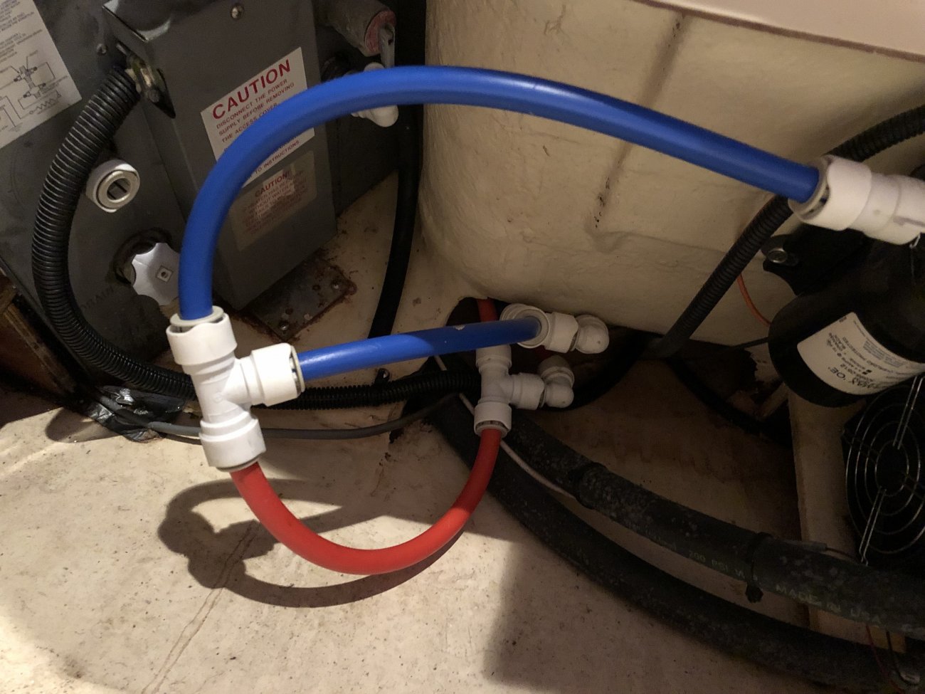

Our Hunter owner's manual shows plumbing laid out as being 1/2 Whale plumbing. The push fittings are marked as being 15mm (Whale fittings as well). This leads me to ask if perhaps the plumbing is 15mm, not 1/2 inch, or that it's close enough in size to not matter (i.e. the 15mm fitting fit fine on the 1/2 in plumbing).
I'd like to know if I can just use some 1/2 inch PEX for a few changes. We're removing the HW tank due to a leak and I've bypassed the plumbing for now, but would like to make it a little neater.
Anyone gone through this with their plumbing?

The 1/2" fittings will not work. 1/2" is 12.7 mm.

1/2" ≠ 15mm. Close but not close enough. Maybe see this thread:
https://forums.sailboatowners.com/index.php?threads/pex-size-fittings.194531/#post-1502592
but rather than Marine Outfitters (shipping will kill you unless a big order and no PST covers the cost) see Harbour Chandler. I know they can get them in through Paynes (Whale) or Western Marine (Seatech).

Thanks for the replies. The parts list is helpful. I found some 15mm pipe in town so things are looking up. As for the plugs, I'm not an expert and wasn't sure if the whole engine was cast iron or maybe some aluminum in parts so I just thought SS would be a safe bet.
