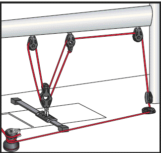

Trying to understand your words.
Dual Ended...
Do you mean:
Or that the line ran continuously like furler lines are sometimes rigged.

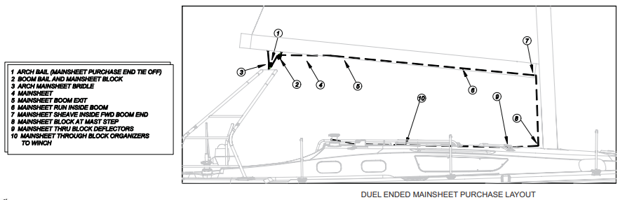

Just came across your post now. I have the same model, I think (2007 H31). I bought mine used, and the mainsheet was not controllable on both ends. It's only controllable from beside the companionway, and in all but the lightest winds it requires a winch and handle to bring in the main as there's only a 2:1 purchase on this set-up like this (if that).
This diagram below is from the original manual. It says "duel ended" in the Hunter manual (including the typo), but it's only controllable from the one end near the companionway and away from the helm station.

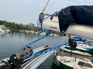

This is how the boom/traveller end looks on mine currently: I'm not sure that even provides 2:1 purchase.
I'm about to try it with this setup below off the traveller, only I'm going to use a fiddle block with a cam cleat at the traveller end so I can control the mainsheet from the helm when I'm single-handed. I'll move the single block on the boom to the boom bail nearer the end of the boom, and add a single block with a becket where the single boom block is currently.
(This diagram is from a Juneau, but the setup is similar, only the mainsheet on the Hunter is through the boom, and the traveller on the Hunter is on the arch above the cockpit, not on the cabintop at the companionway.)
I think only tall people (I'm 6'4") will be able to control the main from the traveller end, as the traveller is on the arch high above the cockpit, above even my head, but well withing reach, although cleating it may be a challenge. When the traveller is all the way up or down, I'll likely have to stand on the bench to reach it, or centre the traveller first, even at my height.
I'll need to get a longer mainsheet too. I figure about 90 feet instead of the current 60 feet to allow for the 4:1 purchase this will provide instead of the current purchase, which is 2:1 max (and maybe not). I'm hoping that's enough purchase to be able to bring the mainsheet in by hand. If not, I'll add more dual and triple blocks to increase the purchase further.
