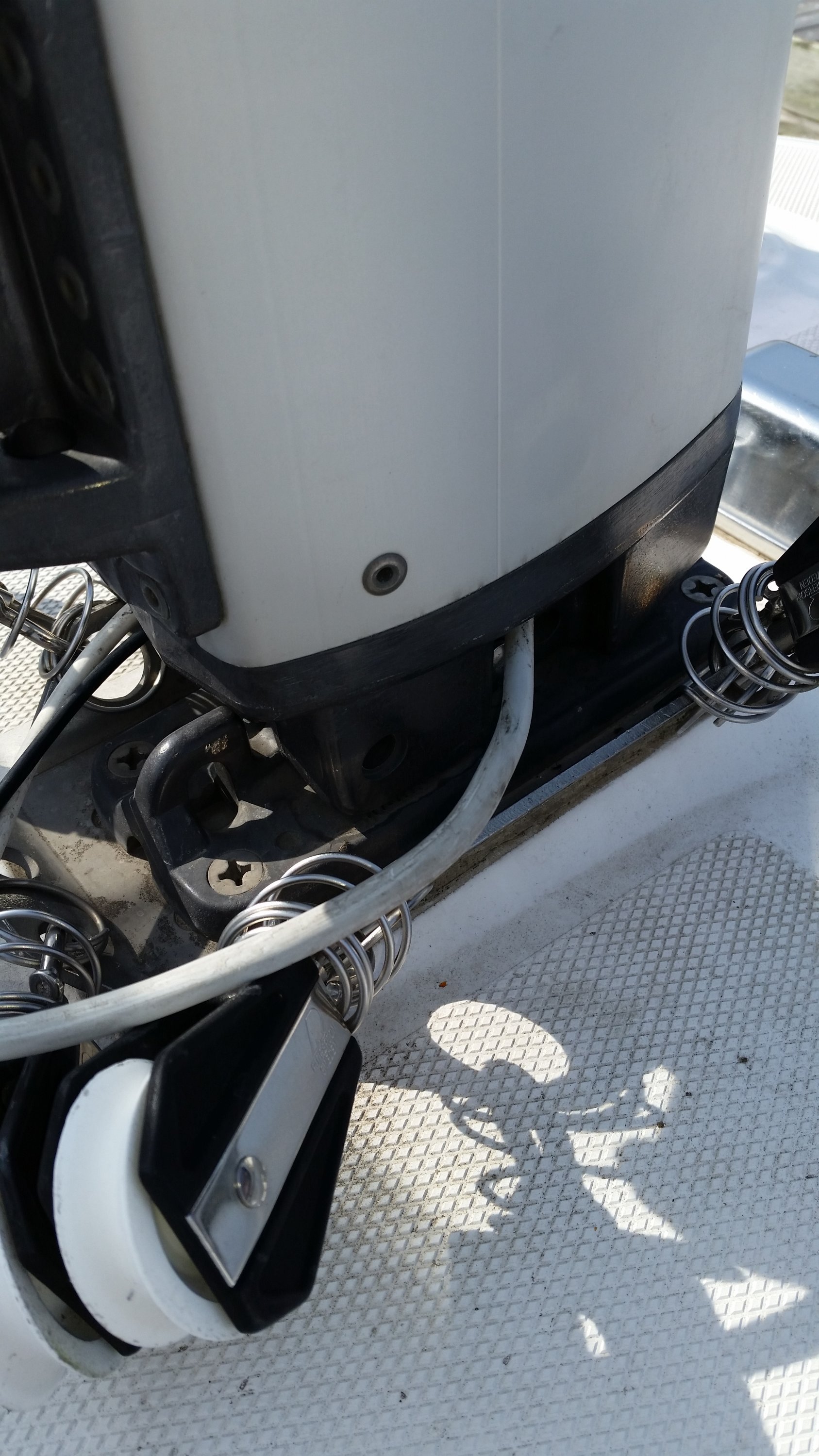

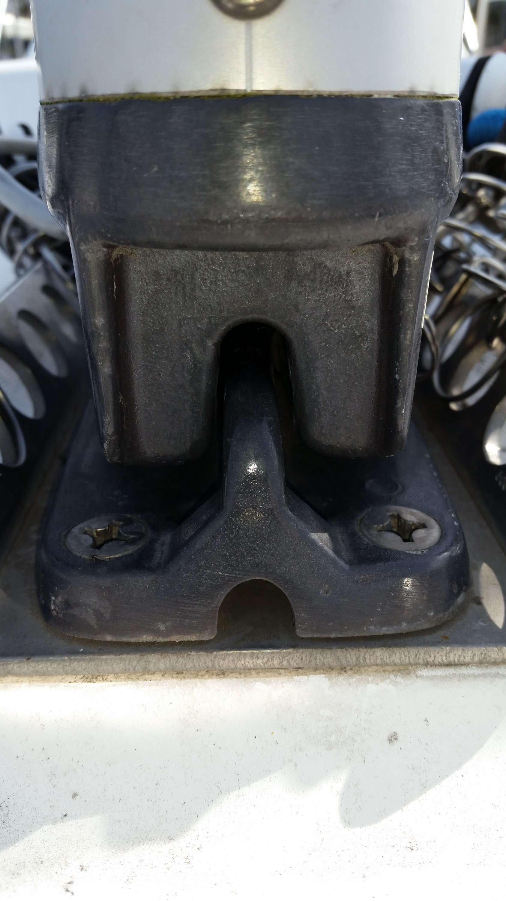

First view is of the rear of the mast and step. The second is of the front of the mast and step. Can anyone tell if the positioning correct? I have hunted for a reference in manuals but no luck.

You may want to research this with the mast manufacturer. It will either be a Selden or U.S Spars but think it is a Selden. Anyway, Selden is located in Charleston, SC and US Spars is located in Gainesville, FL as the mast step would have been supplied by the mast mfg. I drew a blank even though as a former dealer I introduced the 306.

I had 2001 290 and yes is selden but can'take see where a pin may go.
But keep asking here from other 306 owners or go to the boat
owner info and contact them email for help,I have done that in the past for help.

Both are great ideas. I will follow up with Selden and the 306 owners. Thanks guys.
Rob
