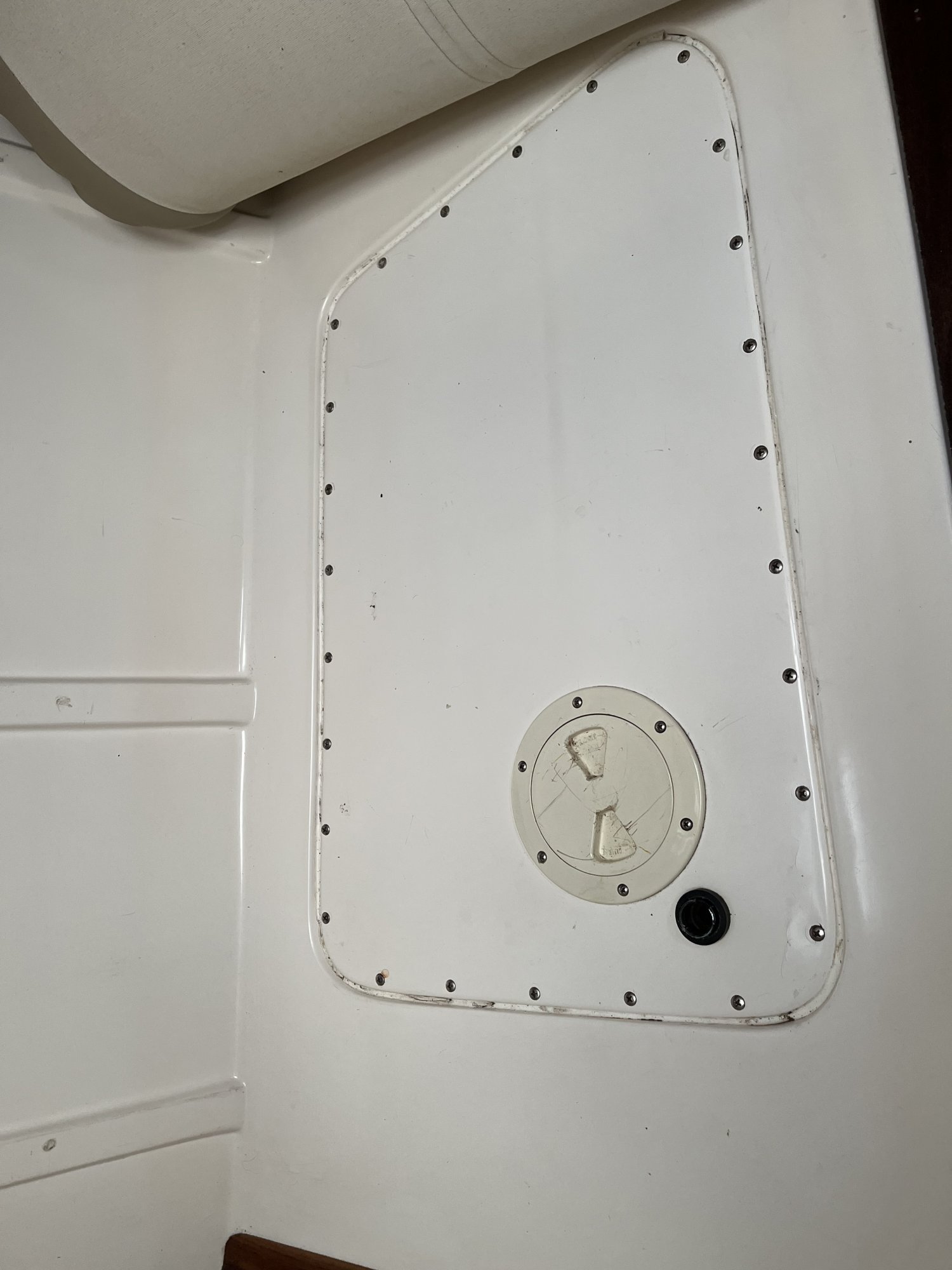

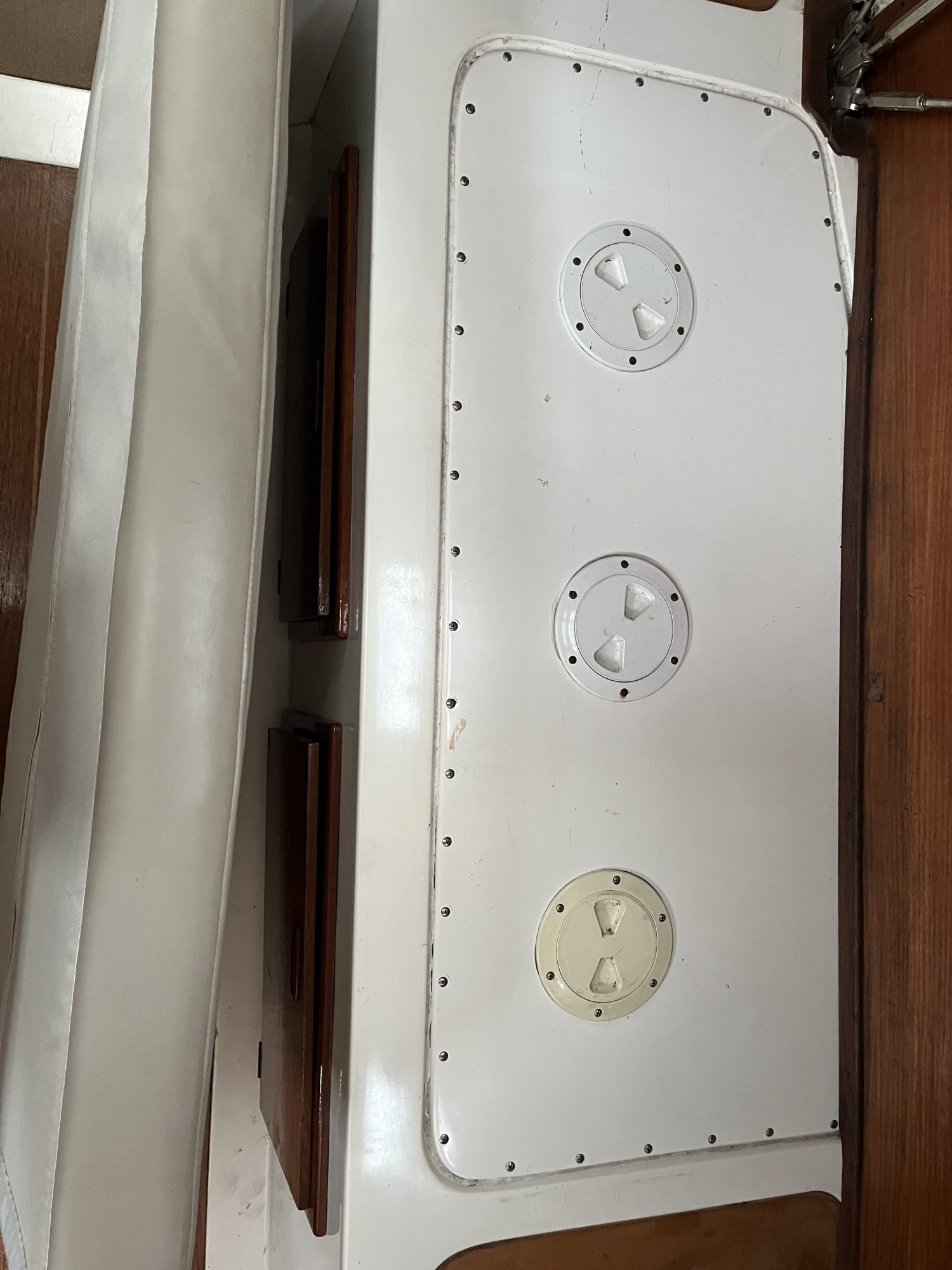

Holding tank, under port Vberth, and water tank, stbd. settee, appear to be molded to the tops of each bench. There is a large fiberglass plate screwed into a recessed lip on each and each one has a leaky inspection port. Based on each lid being covered in white caulking and many tubes of clear silicone then covered in gorilla tape, I suspect that effluent discharge through the tops has been an ongoing problem. How have other H30 owners dealt successfully with this construction?
I am reticent to criticize the design. It could be fine, or perhaps not. It is a new-to-me 44 year old boat. Looking for thoughts and wisdom.

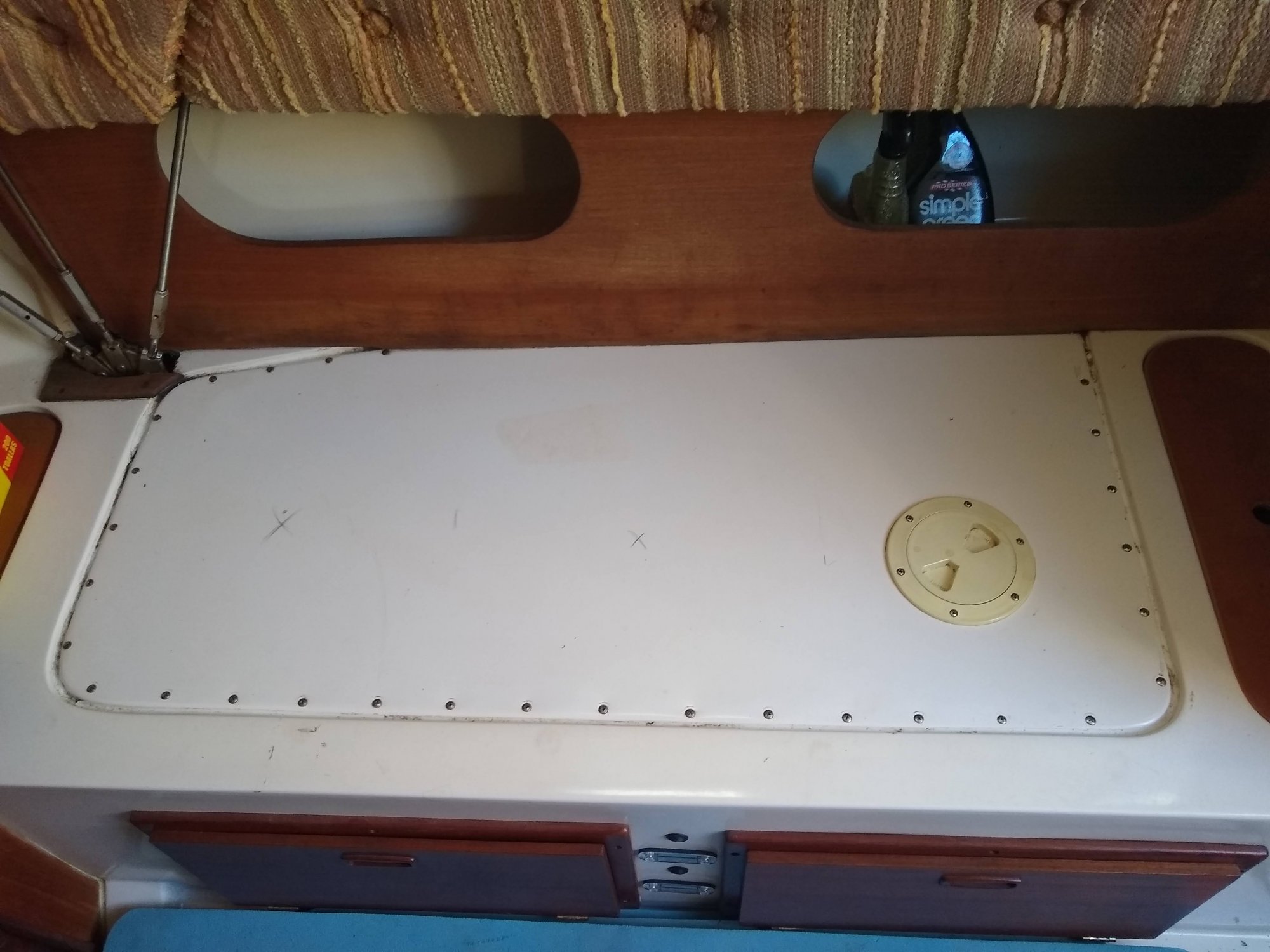

I think the design of the tanks are sound. They save space in the boat, versus a tank that is designed to fit in an odd space and hold down straps are not needed. The fiberglass lids to the tanks are quiet large and take a while to remove all the screws to inspect and clean the tank, but once removed you have excellent access to the inside of the tank. I did install a Beckson port in the water tank lid so I could quickly add water and not overfill the tank. Never had any leaks on my H27.

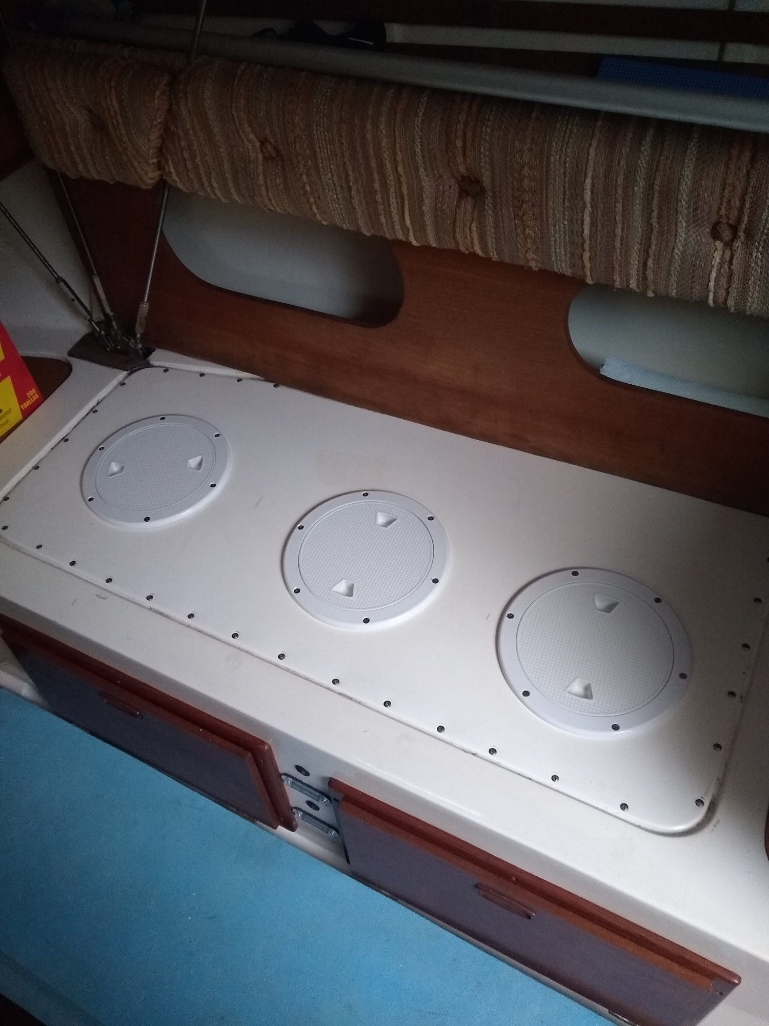

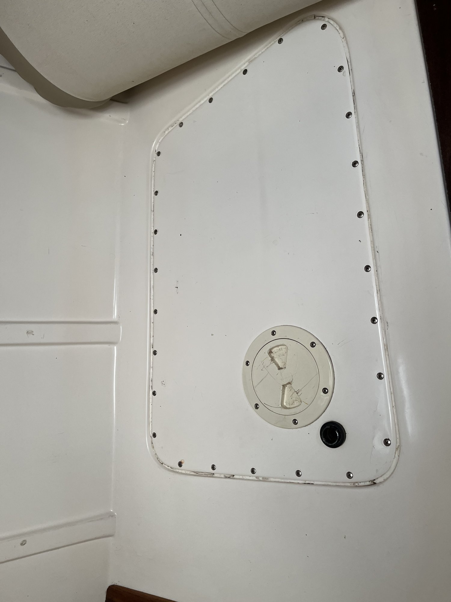

Same design in my ‘82 H30 for both water and waste. Definitely original. Custom fiberglass tanks tabbed into the hull with full size fiberglass lids set in a flanged sitee platform with silicone sealant and screws about every 3 inches. The tanks are an integral part of the sitee platforms which are part of the one piece dropped in interior hull liner.
I’ve been lucky to date. No leaks. If the lids ever do leak, I’ll be removing a lot of screws, digging out old silicone sealant and resealing with the same. I think that’s what you need to do. I don’t know if the silicone around my tanks lids is original or not, but it appears the PO of Dalliance added two more access ports to the baffled water tank for cleaning. If an access port is leaking, it might need a new O-ring, re-bedding or replacement if it’s cracked.
My worst case concern has always been what might happen if one of the tanks underneath fails. Then it’s either a fiberglass repair job or cut out and replace with a bladder type tank I guess. Though removal might compromise structural integrity of the sitees and possibly more, so that’s probably not the direction I would choose. Fortunately they seem quite sound so far at 43 years old.
Overall I think it’s a pretty good design and very space efficient.

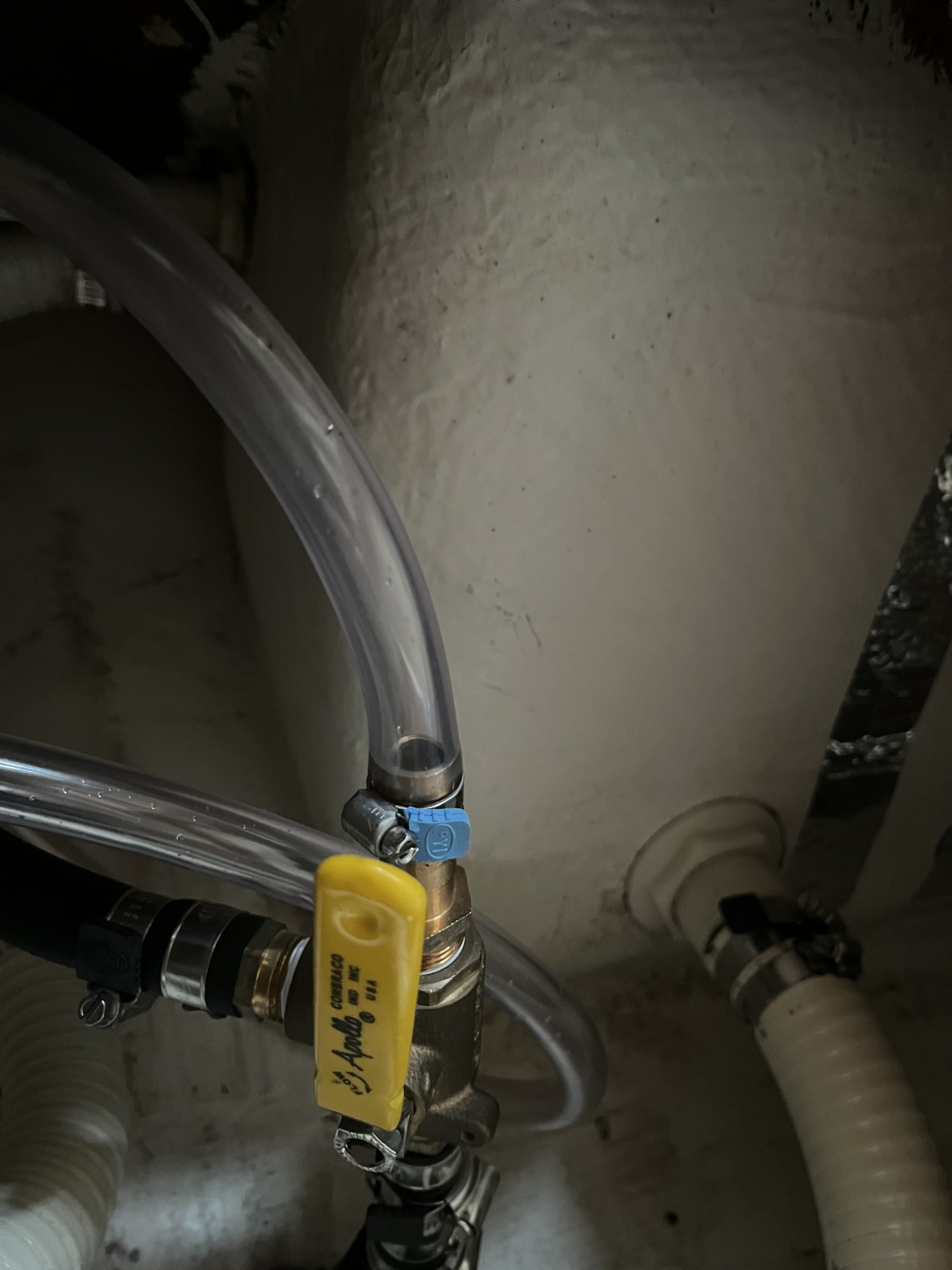

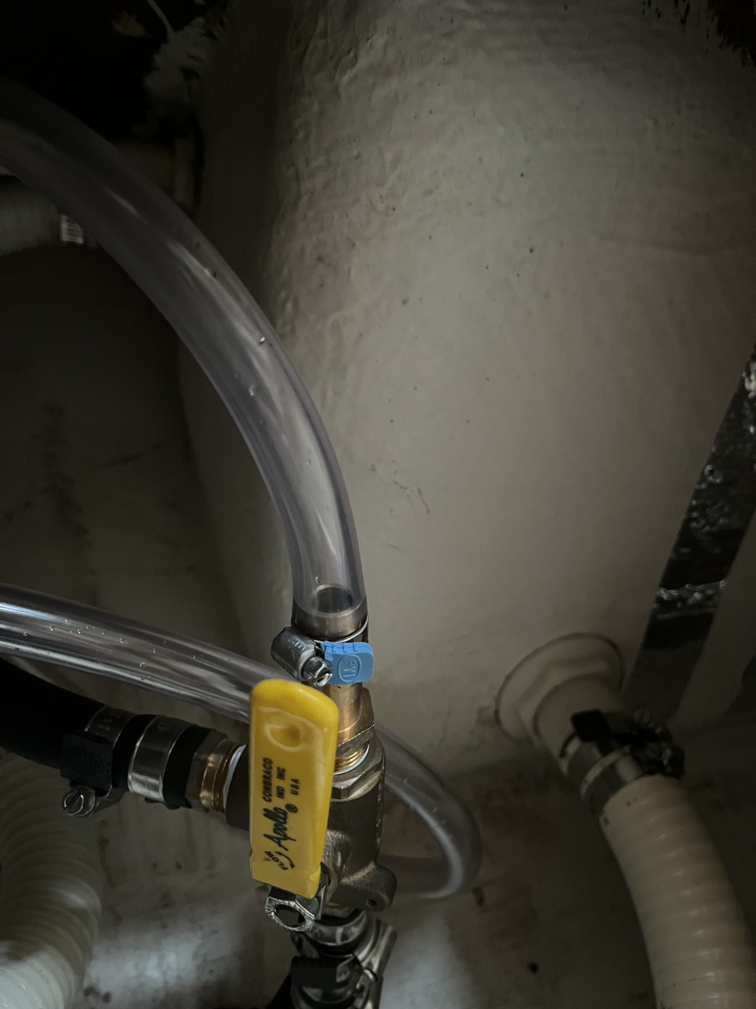

PS: Before anyone comments on the clear vinyl hose in the waste tank photo, it’s a permanent winterizing hose attached to a three way valve just above the intake through hull valve. Not depending on it to handle below the waterline water pressure.

Thanks for the suggestions, replies, photos. Faith restored. Hoses are pretty new and don't smell. I think cleanup and rebedding is all that is needed. 3M4200 or sikaflex equivalent suitable? I DETEST silicone.
If I were to go composting, which a number of my colleagues have suggested, I would still need to clean the tank. Mask on, dig in.

Flushed the holding tank with water and bleach. Got the lid pried off. Rebedded in butyl tape. My fear with a 3M or Sika caulk was that because there is little access to pry, it could be impossible to remove at a later stage. Some of the screws had stripped out of the coring.
Interestingly, the pump out hose attachment point is several inches above the bottom of the tank. That means that unless you insert the vacuum directly through an inspection port, you will never completely empty the tank. It is a through hull fitting and is placed on the lowest flat surface available. Hope this is useful info.

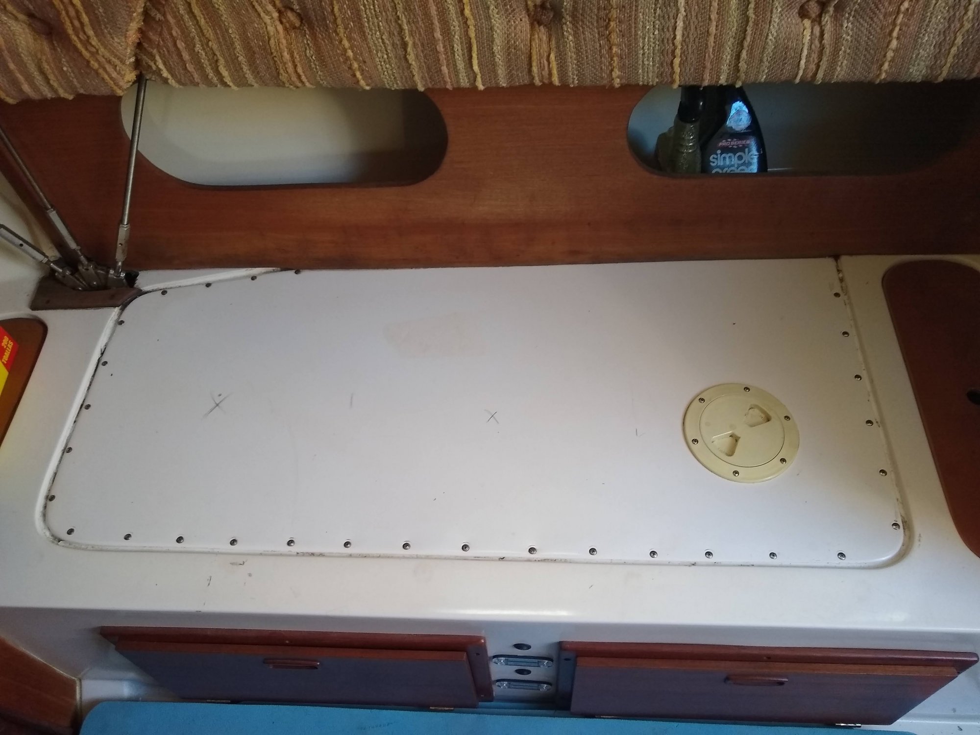

my '78 30' had a poly tank for the black water and has a factory alum. freshwater tank under the port settee. I removed the toilet system for a desicant toilet and will not go back. My freshwater tank was leaking from the outlet neck. I cut a access port in it , cleaned the inside as much as possible and 5200'ed the heck out of it. i didn't consider the system potable from the beginning and defienlty to not now. When that fails, I'm going to cut the top off the whole tank and install a freshwater bladder bag, replace all of the plumbing with pex and switch to potable.
