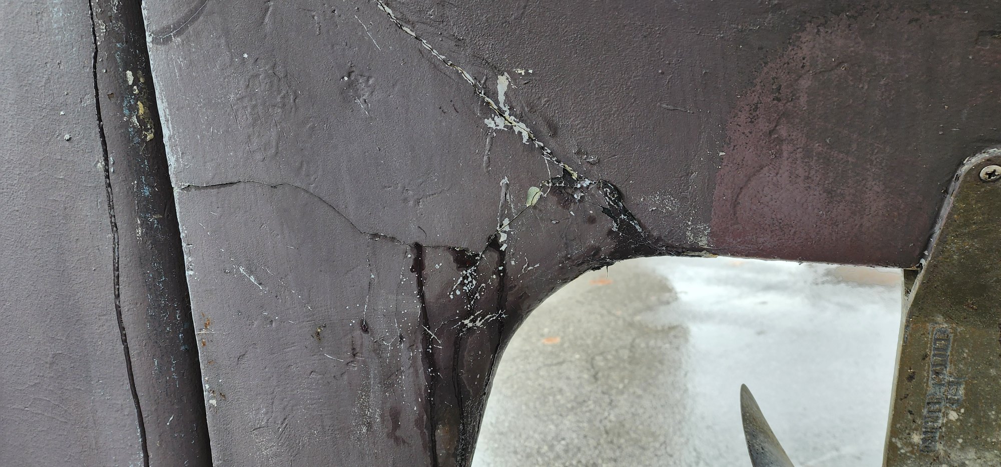

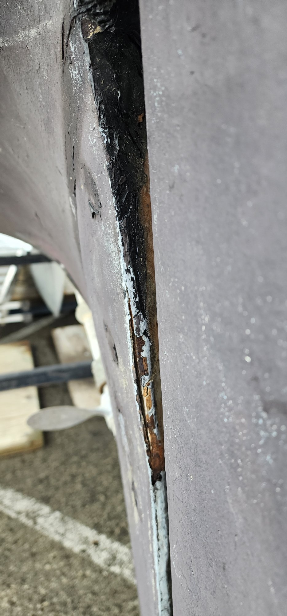

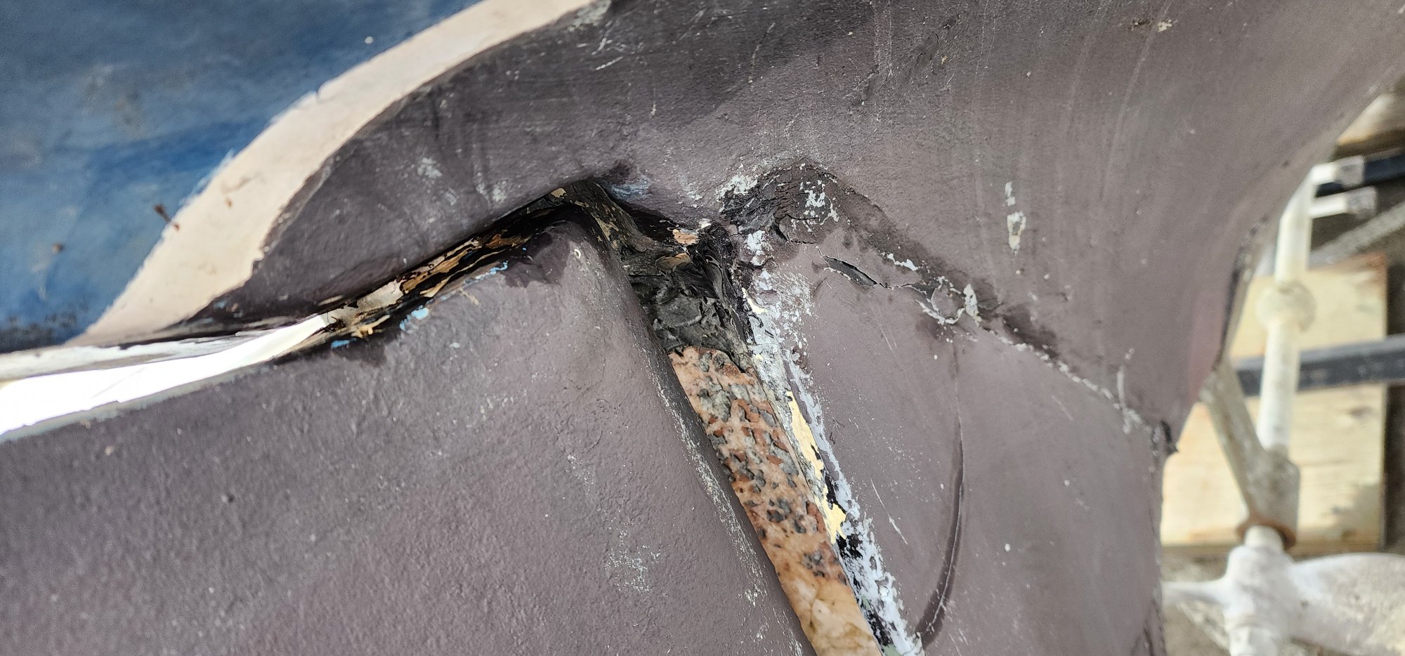

Hi group, first time poster. I bought a hunter 30 1979 last year and everyday is a new discovery!
with the mild temperatures all the snow melted (Montreal) so i took a chance to remove my handrails and when inspecting the boat i saw kind of a delamination of the skeg. You can also see that the previous owner had some kind of black silicone in the inner joint.
I do not know what to do with this. what would you recommend in the short run and the long run?
thank you

hard to tell if that is the skeg or something else, skegs don’t delaminate. The efficacy of any attempt to repair is dubious.
24,926
Welcome to the SBO Forum. Congrats on your “new to you” boat acquisition.
My first rule of boat ownership… Keep the water on the outside of the boat.
It looks like the former owner tried but did a patch up job. This job is in the process of failing.
You asked “what would you recommend in the short run and the long run?”
Short run.. Learn about boat repair. Then repair the damage so that water does not enter the boat.
The delamination in last image is serious. Water is under the fiberglass. This is a rebuild project. It will not get better. The black goo was temporary poor fix.

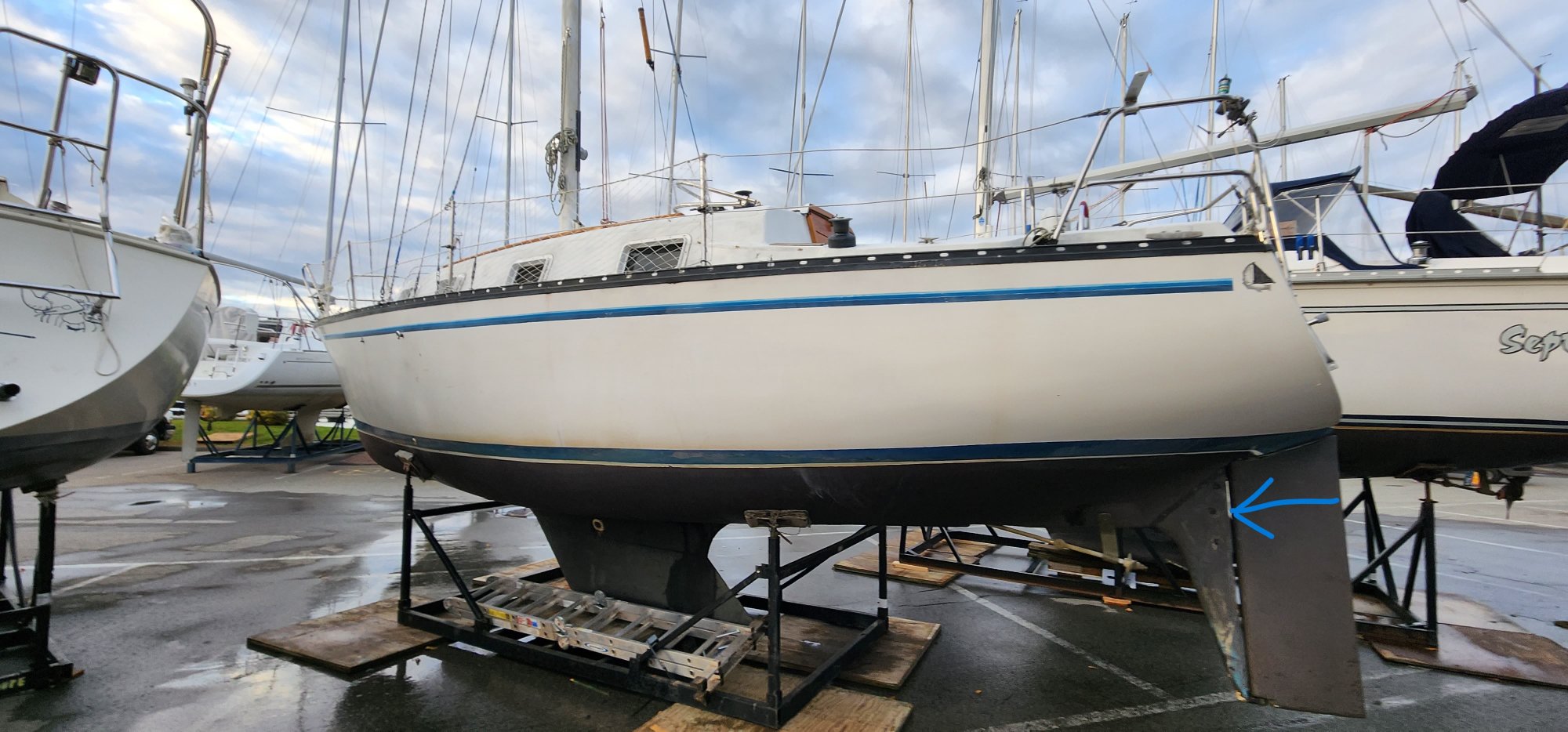

I am having a hard time picturing where that is on your boat... and what it has to do with handrails. Maybe stand back a few feet and take the pic again.

I have the same boat although a '77. I had to replace my skeg several years ago due to a hard grounding and ripping the skeg off. It floated away. ( Long story). Good news is the skeg is bolted to the hull. Access the nuts inside the hull, back them off and remove the skeg, repair and replace. If you should lose the skeg while underway, you will in all probability also lose your rudder making a bad situation even worse. Sinking is a real possibility here. Take care of this before you splash.
I added a picture, the arrow shows the place where the photo was taken. I might add that is seems that on this photo there are 3 kind of cercles on the skeg showing a probable previous repair.
