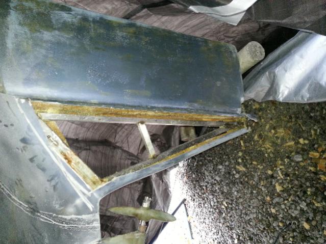

Also (and speaking as one who just recently repaired one, post-Sandy), the skeg-hung rudder is much stronger and provides some sacrificial or defensive material (the skeg) in the event of surfing through an inlet and whacking the rudder on God-knows-what under there. I actually substantially stiffened my spade rudder's rudder post sleeve inside the lazarette and added a short bulkhead damming off that space from the rest of the bilge, in the (however unlikely but entirely possible) event of the rudder shaft's ripping aft into the hull skin. As it is now, I have at least a fighting chance if I hit the rudder fin on something. It's an old-boat fix I would recommend to anyone cruising where you can't walk ashore or get help in 20 minutes.
