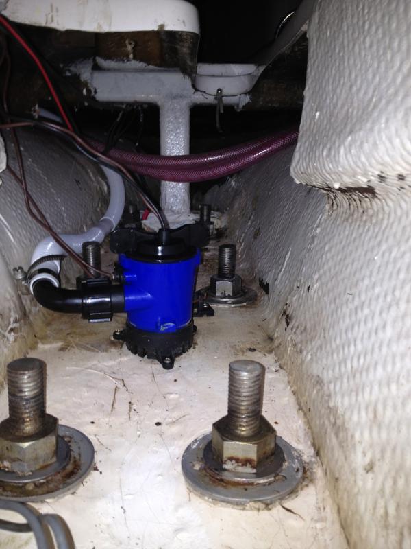

Hello
I recently purchased a Hunter 30, 1981, it looks nice and clean. However inside the cabin under the floor near the keel I noticed a lot of corrosion to the structure that support the compression post, there is fiberglass that cover part of the structure other part are exposed and you can see the corrosion, both end of that structure is attached to the rigging. I did some research and it appears that many Hunter owners have the same problem. I would like to know if the structure can be replaced. If so any instructions will be much appreciated, also can the work be done while the boat still in the water
Thank you for your time

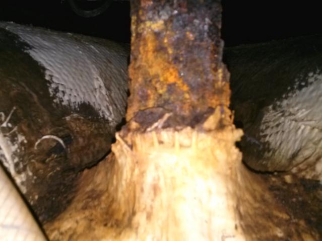

Thank you for your reply, the problem that i am worry about is not the mast base but a corroded core near the keel. I took some pic today and i made a hand drawing that hopefuly is better than the way i explained( sorry i am not a native speaking english and i am learning the right terminology) any way the core is made of square beam that is horizontal but take the shape of the hull at its end , at the center of the horizontal part, there is a vertical beam may be 10in long connected to the keel and welded to the horizontal beam. The part that are visible are coroded , other part are not visible under fiberglass , but corrosion spreade and nothing can stope it. I attached some pic, please give me your opinion.

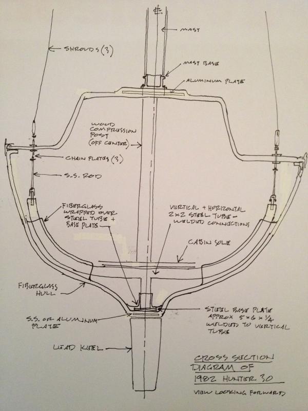

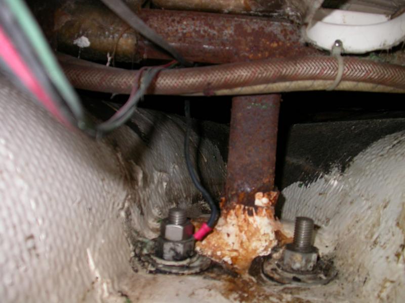

Attached are three photos; one is a sketch I posted about three years ago in response to a similar question. It may help a bit with terminology and a few more details about the structure. The other two show the conditions I had six years ago and what it looks like today. You definitely have more corrosion than I did in fresh water.
Steel expands when it oxidizes. Corroding steel re-bar in a concrete structure will expand enough to fracture and push the concrete right off. Just like it's doing with the fiberglass around the base of your vertical steel tube in the bilge and just like it was doing in mine. The good news is that, from what I can see in your photos, the fiberglass around the horizontal tube looks like it may still be firmly attached, which would suggest little, if any, corrosion beyond the steel that has been exposed for 30 years. What I see on the horizontal tube looks like it could be just be heavy surface corrosion. The walls of these tubes are pretty thick, 3/16" or possibly 1/4", so you can lose a little steel to surface corrosion and still be OK. Unfortunately, the vertical tube looks pretty bad, and you will find the worst corrosion at the base, under the remaining fiberglass. You need to cut that away to see what you really have. You may need to replace the vertical portion, but I'm not convinced you need to replace the whole structure.
What I did with mine is a bit of a calculated risk because I can't know for sure what, if anything, is going on underneath or inside the tube, but it was recommended by an experienced marine surveyor, and I keep a close eye on it. Being a worrier, I developed a plan a year or two back with a boatyard contractor I trust to replace the vertical tube. I haven't pulled the trigger yet, but the plan is to have a welding shop make a replacement post with a base plate to match the dimensions of the existing and a top plate of about 3"x6". Materials would be 2"x2"x1/4" tube and 1/4" plate, all stainless steel. With mast down, cut out the vertical tube, grind the old weld smooth, wire brush and coat the horizontal tube with epoxy, set the new post assembly in place with thickened epoxy under the base plate and 5200 between the top plate and horizontal tube. I'm not sure we had settled on exactly how to temporarily shore up the horizontal member, or if it is even necessary, but space down there is limited.
Since we haven't actually done this yet, I don't know what unidentified pitfalls there may be to this plan, so I'm interested to hear what others who may have tackled such a project have to say.

Thank you for your elaborate expanation, the blue print looks very accurate. I was out of town for work just came last night. I am going to do a second assasement and see how far the damage is spreading. I will post more questions this weekend. Thank you again

I read your post from a couple months back and understand what you mean about not putting mast compression load directly onto the keel. I also found another intriguing post from about a year back about replacing mid-deck chainplates with u-bolts at the toe-rail. So you have got me thinking and re-thinking this.
I have always seen this unusual structure in the 81-82 (83 too?) Hunters as being, theoretically - picture it disconnected from the hull - sort of self-contained. That is to say that the downward compression vector of mast compression would be counteracted by the upward tension vector of the chainplates and shrouds through the horizontal member. Should I be calling it a stringer?
In reality, the loads are being transferred to the hull both through the tension rods to the chainplates, side decks and toe rails; and through the fiberglass that wraps the member and tabs it into the hull. I'm not sure how much compression load is really being carried to the keel by the little vertical steel post. Hopefully very little. I do know that Dalliance has a tight hull to keel joint; no "smile", if that's an indicator. It seems like a design that, in theory anyway, might actually transfer less compression load to the keel than the earlier "I-beam" design.
As for it having been executed in steel instead of aluminum or stainless steel.... Well, as an architect who sometimes sees clients & contractors try to save money without considering all the ramifications, it's obvious what happened. They call it value engineering. I call it value removal. No way would your father have done that. It occurs to me that the vertical post could even be an addition to compensate for a downsizing of the horizontal member, but that's pure speculation.
Anyway, my approach to finding a fix for this, has been to look for the least invasive way of replacing an inappropriate material, only where it must be replaced, without changing the designer's intent. I want to avoid inadvertently changing something that I did not recognize the ramifications of.
That said, I am very curious what your solution would be. From your post a couple months ago, I'm thinking it might be some sort of new stringer(s) inserted just under the horizontal steel member, if it's in good condition, to transfer any compression load to the hull rather than the keel. Or would you abandon the steel structure entirely, in favor of a new stringer and relocating the shrouds to the toe rail?
What would you recommend?

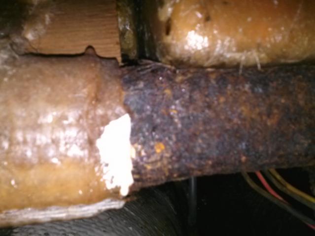

Hello everyone. A friend of mine a good sailor and with experience and knowledge came to help me to have clear idea , he inspected the horizontal port side and the vertical part under the compression post , the starbord side is impisible to inspect but since the drainage of the shower is to the port side and runing water make more corrosion, then lets assume that the condition of both end are similar, any way he inspected with hammer and he said there is still a good part that are ok . But i am skeptical. I think i have 2 options, either i performe a major surgery and replace the whole structure but with stainless steel , the advantage of that is i will keep the same design and that is important since many hunter owners are talking about the load distribution and so one, the downside of that is the starbord side is not accesible and i dont know how i will be able to extract that part without cuting some fiberglass that may weakeen the hull. The other option is to change the design and use the rail and U bolt to attache the shroud, and use a shorter horizontal I-beam instead of the existant one to hold the mast against the hull, easy to do but i dont know how much stress it can handle, but thinking about the backstay that is attached to the rail with U bolt this idea make sence, however i need your opinion and expertise to make my decsion. Also ladyof burlingam any help is appreciated
Thank you

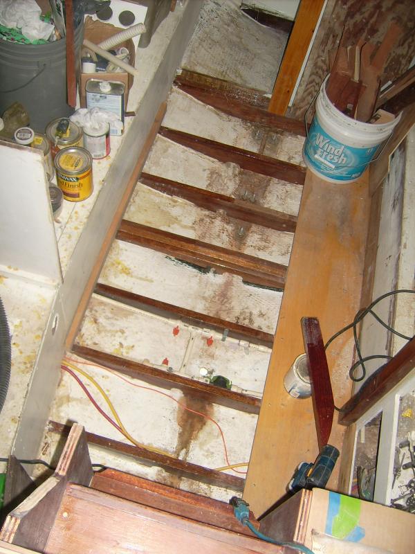

Here are some older pics of the structure I made. This weekend I will take some more photos of the boat and see if my meagre handiwork can illustrate what I am talking about with the compression post and crossmembers.

To replace the metal structure you would need to open up (tear out) the interior of the boat from the floor all the way up both sides to the chainplate attaching points. You probably don't want to do that right now, and I seriously doubt it is necessary. That would be a huge job.
I recommend that you wire brush all the exposed metal to remove loose rust. Paint it with a rust stopper like POR-15, paint with primer and a cover paint like Dalliance did. If the vertical section between the horizontal pipe and the keel is beginning to collapse, you would see deformation in the horizontal section. You could cut out and replace the vertical section, but I wouldn't recommend it at this point. Though it is not an ideal design, your setup is quite sturdy.
So in short, remove visible rust, repaint, keep an eye on it and Go sailing.

Thank you Tom for your help, the horizontal beam is not bent, i agree i should enjoy sailing and worry less while the boat still in good shape. Once things start to go wrong then i will find a way to solve the problem. One question thou, how i brush clean whatever under the fiberglass? I am talking about the horizontal beam most of it is cover with fiberglass. Thank you

You can't get to it without cutting off the fiberglass that tabs the member to the hull. I'ld avoid that if possible, but there is a gap between the underside of the horizontal member and the hull that could be useful. The steel curves upward roughly parallel to the curve of the hull in this area. Perhaps you could spray POR-15 into this gap to at least coat the most exposed areas of steel. I haven't had to deal with that area myself being a fresh water boat that spends half the year on the hard. Tom, what do you think? I haven't used the POR-15 you recommended, but it sounds like a great product.

I haven't used POR-15 either, but I have 2 MGs. These British cars are notorious for rust and the mgexperience.com website people all swear by the stuff. From everything I've read, it and similar products are excellent for arresting rust and establishing a paintable surface. Seems to me that Deck Department used it too when I was on the USS Kearsarge.
I agree to apply it to all of the exposed metal. If the fiberglass is well adhered to the post, there would be little air (you need iron, water, and air to get rust) and the post may not be in such bad shape under the fiberglass. Seal the transition area with POR-15 and enjoy!
