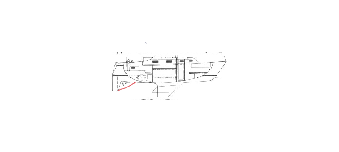

Nothing specific other than the mechanism is a vulneribility. Being skeg hung lessens it for sure. I'm not a fan of the upper wood bushing that supports the end of the tube or the wood stearing stops but I guess simple also has its advantages.
dLj
Mar 23, 2017
5,186
Looking at a side profile of the H30, one might want to add in a support piece, as drawn below in red:
