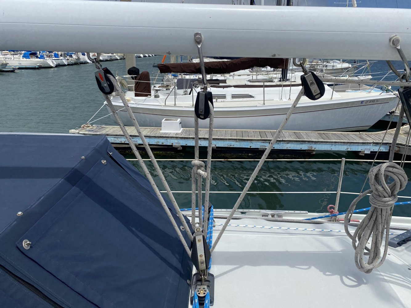

Would someone be able to share a picture of midboom sheeting and what hardware is used?

Here is an image showing the hardware needed. A 4:1 to 6:1 purchase system is common. This might include a triple block or fiddle block on the boom (e.g., Harken or Ronstan 55-75mm orbit blocks), a ratchet block with cam cleat on the traveler car for easy trimming, and turning blocks if routing along the boom. Opt for ball-bearing or ratchet types to reduce friction. Friction is your enemy. Choose your blocks wisely.
