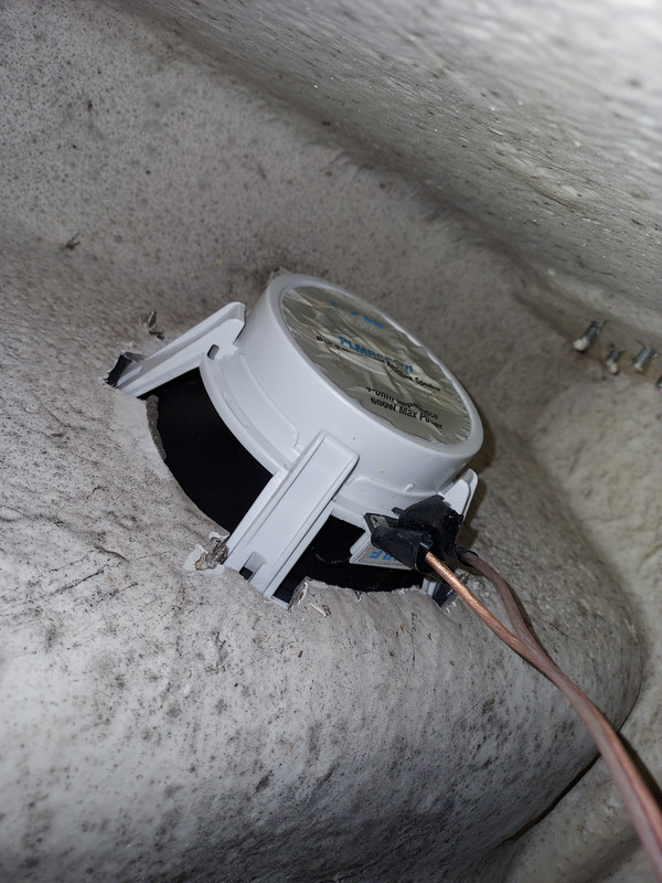

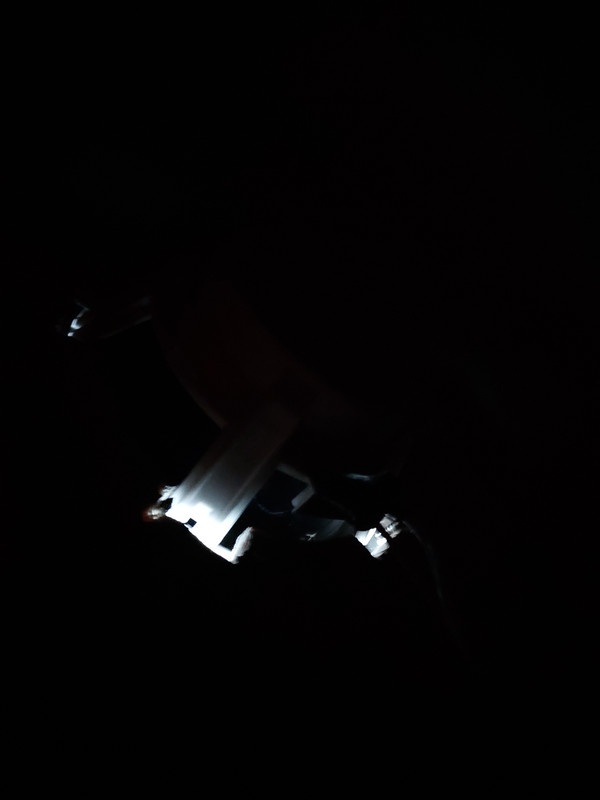

Ever since I purchased Prometheus I have had leaks into the quarter berth. I have suspected that part of the issue is the aftermarket speakers installed by the POs.
From the inside it looks like this using my flash
From the inside without the flash
Now I may not be the sharpest knife in the drawer, but I think if you see daylight, it can leak water.
I would really like to repair this by removing the speakers and filling the holes. Between the now and the time that happens anyone have a suggestion of a temporary repair until that time comes?

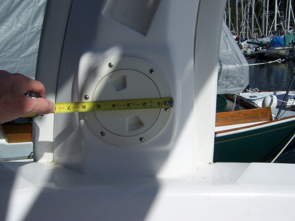

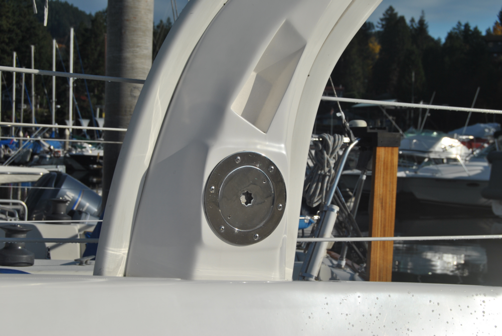

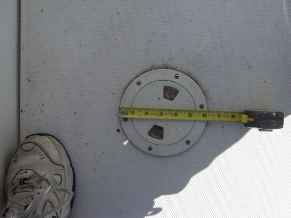

An alternative might be to remove the speakers and install inspection ports. This will be an easy and inexpensive way to seal the hull. If there is an inspection port that fits.
Here's an example, there are other sizes.
