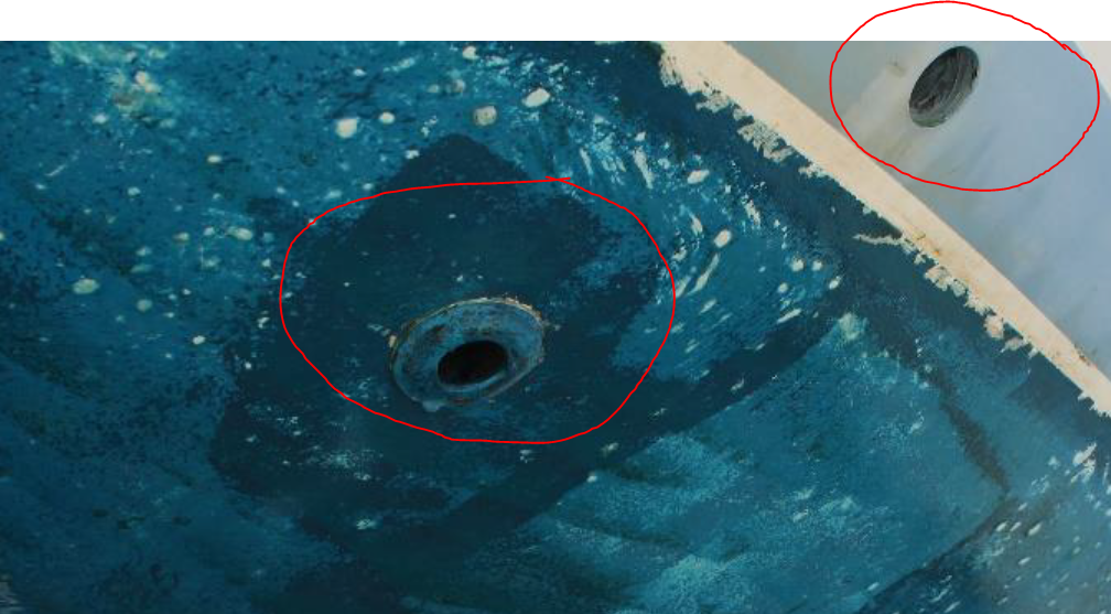

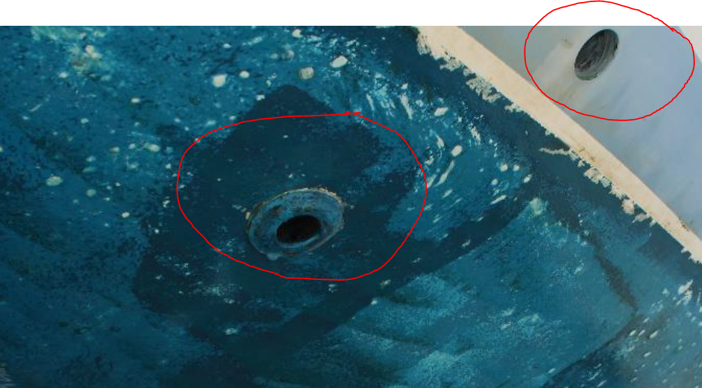

The bathroom sink drains to a thru hole above the water line but the galley sink drains below the water line. So the malfunctioning valve is the one that attaches to the thru hull below the water line. My thought is if the top of that seacock is below the water line, when I remove the hose water is going to come in the boat until I put it back or plug it. I was thinking I could possibly plug the thru hole under the boat though while attaching a new valve. I wouldn't attempt to replace the seacock while in the water since I have never done that before. I am pretty sure I would sink the boat in the slip or be putting to the boat yard with a plug. lol

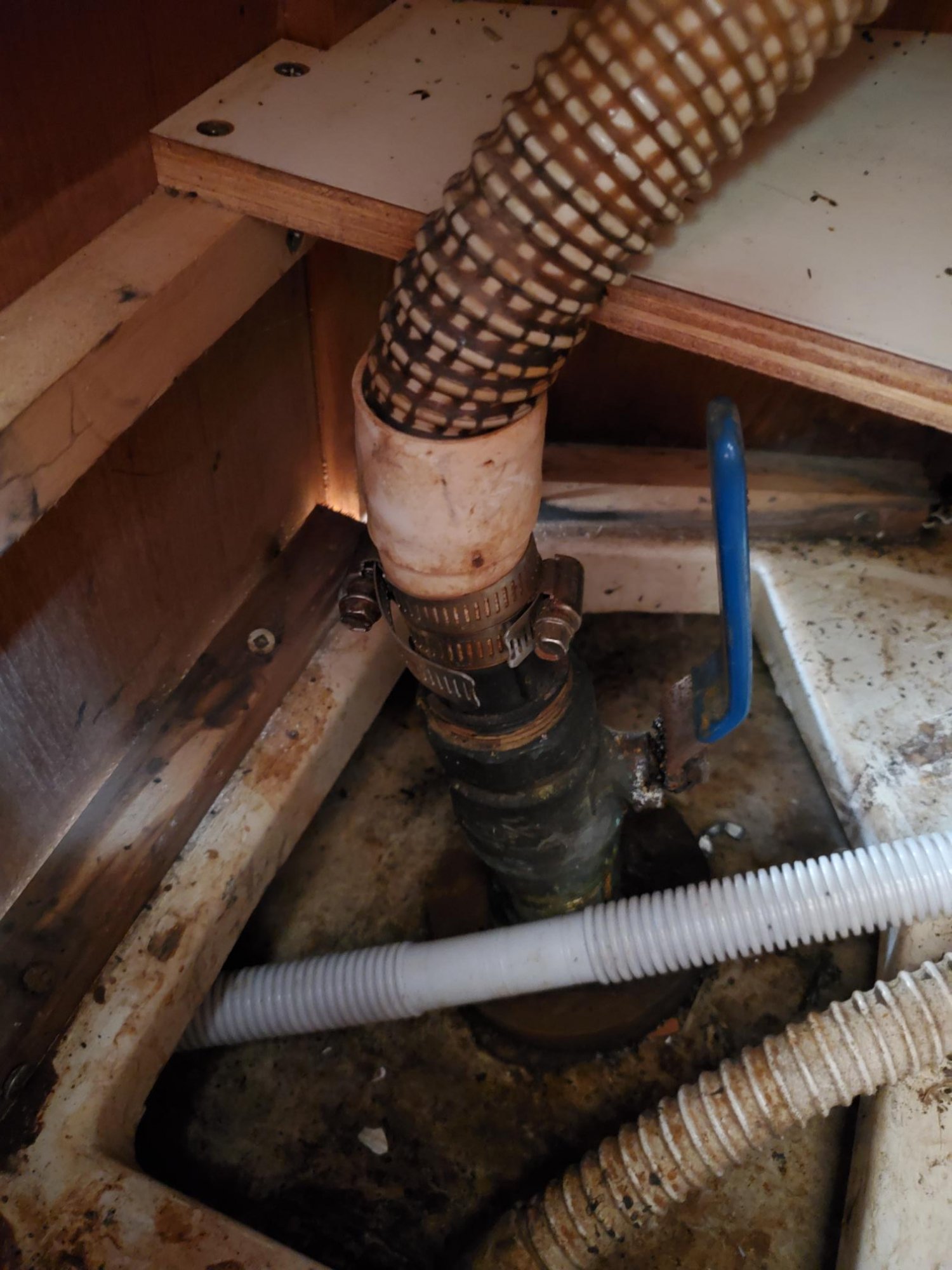

The hose is in good shape. The lever that turns the valve spins freely and is heavily corroded. If the stem is what connects the lever to the shutoff then I suspect that is what is broken. The valve doesn't have any leaks so the surveyor said a temporary fix would be attaching another ball valve to the top of that valve so you have the ability to shut off water from coming in. That said, exactly what you talk about is my concern. Heaving on that has the potential to create a leak that isn't there or break something. I am attaching a photo, it isn't pretty. lol

Yipes :yikes:, I wish you hadn't shown me that picture. I still see it every time I close my eyes.
But as you say, it's mostly dirty and not heavily damaged. It's most likely that the stem has been over-torqued in an attempt to open the jammed valve. If there's no leakage now, very unlikely it will start in a big way.
Looking at its lousy location, I would classify the removal in the water as a very high risk project. I would classify leaving it alone until haul out as very low risk. If you are planning a haul out at the end of this season and not the usual zinc replacement and underwater repairs next spring, I think you are looking at near "0" risk.
No harm in looking at it every now and then just to prove yourself right.
