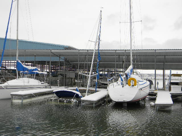

Hunter 28.5 Sank at our marina
Aug 5, 2009
333
Hunter h23 Dallas Tx.
We think its a Hunter 28.5
Its hard to remember what boat goes where when they are gone
It was sad to see this morning
It went down Tuesday during our ice storm
It has not been above 25deg since
We had 5" of snow last night and this morning

That is sad. From the torn headsail I might presume an absentee owner. We have one at our marina that is a sailboat that something is always tearing loose and flopping in the wind. Very annoying for us live aboards. Unusual as the manager generally does not permit problem owners.
What is causing the boat in the next slip to sit so high?

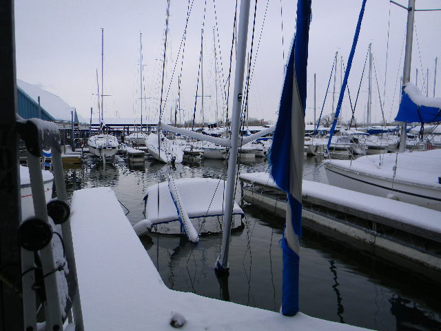

That is a shame, I walk by that boat every time I go to my boat. I can see that the stern lines are holding up the sturn. But I did not see any bow lines. I will check it out when I go out there tomorrow. One good thing is that I can see the mast of my boat on K dock so I know that I am still ok

this is painful to see. why was the bimini still full set?. I wonder why it happened with such little snow. it probably had plugged scuppers and the intrusion into the cabin with rainwater - as I've seen h28.5 wiith snow to the top of the cabin and it just sat heavy but level in the water and the boot line thru hulls were just above the water line. If those bootline mushroom scuppers were old and brittle and there was wind rocking the "loaded" boat, it could be that ice might shear the mushroom head on the thruhull and then its all over.. There will be a post mortem on it and we all would like to know/learn. Last year a pal of mine had an oysterboat( a very different design of course) with a long open aft deck. He came down to check the lines the night before we got 20+ inches of snow. Overnight the weight of the snow had pushed down the aft end of the boat til the aft scuppers were under and he sank at the dock too. the 28.5's cockpit scuppers are crisscrossed and much higher than the thruhull exhaust end , I can't figure that this boat foundered that way unless icing busted out his hoses at the thruhull.
BTW, how is it that the boat to the right is appearing to be stitting up and high on water - did his keel fall off???

Tim, Caliente sits on a leaking hydro hoist, that's why its sitting high.
It's really lower than it should be. The Hunters owner appears to be an absentee owner

Photo Bug, glad the picture showed your mast, I'm on R Dock, drop by some warm day

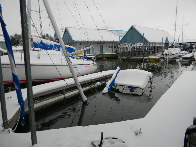

The boat sunk because a seacock was left open for the engine

In this case, the sump pump discharge line had a low point, which held water and froze. Check valves are just as bad, since they hold water in the line. I'm guessing this is a common factor in many first-freeze and snow sinkings. Since the boat had seen very few freezings, I bet the owner never thought of it. In fact, many cold climate sailors don't either, because they are not near their boats in the winter.
Check those sump pump hoses for low spots and check valves!

It was a Hunter 28.5. Unfortunately about two years ago I allowed a friend to use the boat whenever he wanted if he would keep up with the maintenance, I paid the marina fees and any cost, etc. Between traveling and four small children our family had been unable to use her in the last several years.
So here's the scoop, it appears he did not shut off the valve for the lake water to cool the engine. I believe it burst and ...............

We've had our 28.5 since new in 1986, and like most boats that age there are components that deteriorate over time, some of which could see accelerated damage under winter conditions.
The cockpit scupper hoses are cheap thin corrugated hose , so any plugging and freezing will result in quick but unseen damage at the waterline that could flood the boat.
The OEM engine, galley sink and head gate valves were subject to freeze damage or electrolysis at their shafts, if not replaced with Seacocks or ball valves.
The engine intake strainer body is glass.....leave a seacock open and have that strainer freeze-up....same predictable result.
The OEM head sink drain had the same type thin corrugated hose and no seacock, and a plastic thru-hull at the water line. Ice damage could result in a broken thru hull fitting.
Keep an eye out for these types of weak areas and correct them where possible, and haul boats where winter freeze ups and snow /ice overloads could sink them in their slips.
