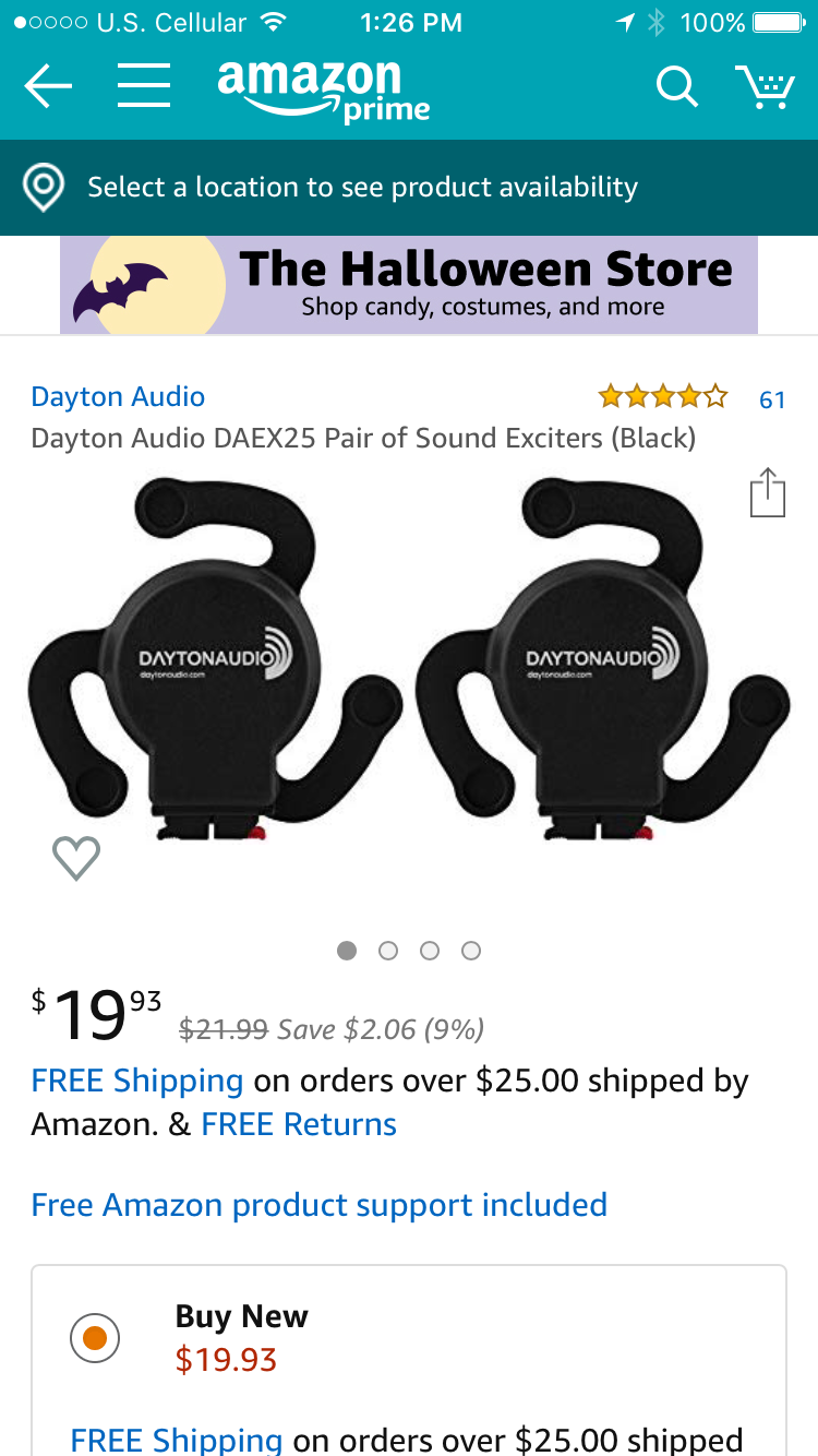

I installed 4 exciter speakers in my S2 cockpit. One on each side seatback just batt of the cabin and on the stern either side of the rudder post. No holes required, you epoxy them on the backside of the fiberglass and they vibrate at a very high frequency to produce the sound.
