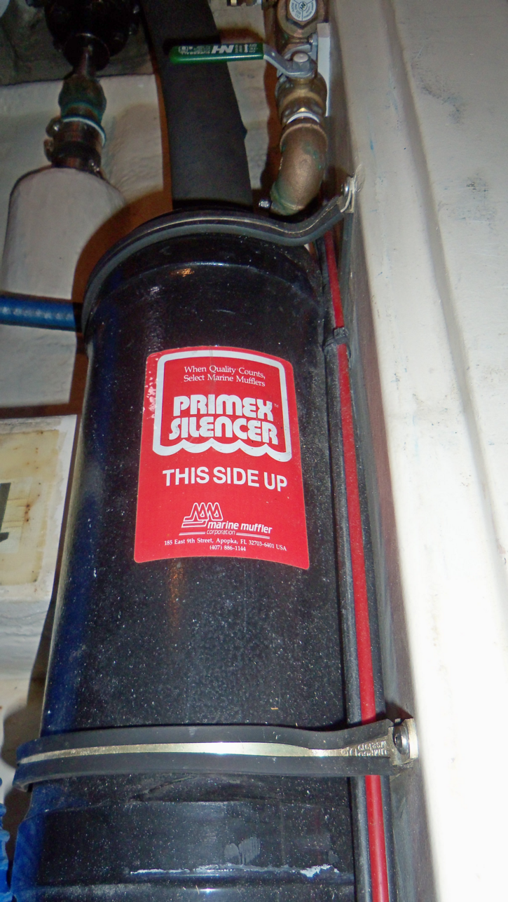

Thank you Ralph Johnston for your reply. Harsh, but useful in my continuing search for perfection on this old boat. Note: its original name was ALOPY where the previous owner managed to only erase the J. The soot in
the bilge is carbon black and seems to be washing into the relatively small bilge from under the floorboards..it only appears after running the engine. The Clearwater leak is indeed lake water. Both of these are manageable no big deal. Have not detected any exhaust smell so CO is not a concern at this time. Apparently, earlier (1985 to ?) versions of this boat did have a problem with exhaust water getting into fuel tank- go figure. Hunter had a retrofit plastic tank available to correct the problem.
I’m assuming that this black soot is coming from some sort of exhaust system leak and would make sense that it would come from the muffler where the exhaust/water mix has solids sinking to the bottom then slowly leaking from a cracked muffler. My thinking is replace the whole system as long as I have everything pulled apart with a new muffler and hoses and anything else that be currently at fault or on the verge of being at fault ..So im fishing for responses that may provide that one small clue or bit of info that makes addressing the issue more achievable. Since I’ve already purchased one of those perpetual motion machines I figure one is enough and i would rather spend a couple of bucks on redoing entire exhaust as opposed to doing it on piece at a time based on the age of this Yanmar 2GM20F system. Again thanks for the help

Good. You've established it as carbon black and not just garden variety dirt. When mixed with water, we know it's coming from the wet exhaust system. Finding the leakage point should not be an impossible problem. Firstly, what condition does the exhaust hose look to be in ?
Before leaving the dock, ensure everything around the exhaust system is bone dry and as clean as you can get it. Take the boat out and run it hard for maybe 15 minutes. Slow down and slowly shut down the engine where you can drift for about 10 minutes while someone keeps watch. Go below, and while wearing heat resistant coveralls, run your bare hands over the exhaust system. The entire exhaust system should be cool including the mixing elbow or if hot, you have a problem with injection water flow. Did you find a wet spot in the exhaust system ? Also check the incoming cooling lake water and the antifreeze hoses. The AF hoses will be about 180° F so search gingerly.
The Golden Rule of problem solving :
Your boat is now 36 years old and some of this exhaust equipment may have already been replaced previously. You will then wind up replacing equipment which does not need replacing and may still not solve the problem. What does your muffler look like ? Anything like thist ?
