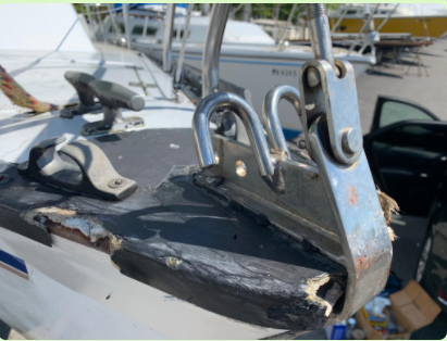

Someone hit is. Hull is fine. The black fiberglass "bow cap" is cracked.
Does anyone make a Hunter replacement cap ? Maybe I'm dreaming. Looks like a lot of people fabricate out of aluminium.
Thanks !

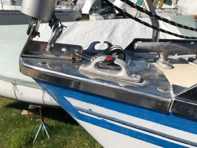

Got up to the boat this weekend and got a pic of my Bow Cap,
I think this is what your looking for. It appears to be original equipment. This is on a 1984 Hunter 27

Wow that's nice. Ours looks the same - just a fiberglass "cap" vs stainless - one cleat, two guides, etc.
Thanks.
