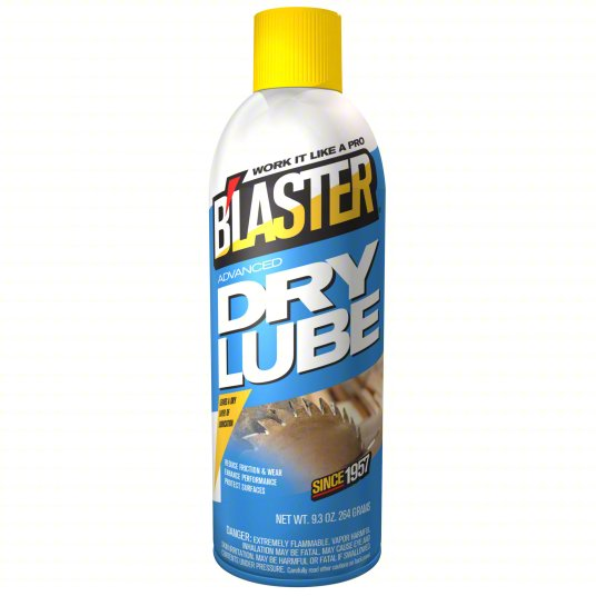

Sounds like you are not getting deep enough with the trailer but..
Have you tried spraying the skid carpet with something similar to this...?
I always spray my bunks once a season or more.

Thanks Rgranger. I'll give the dry lube a go.
