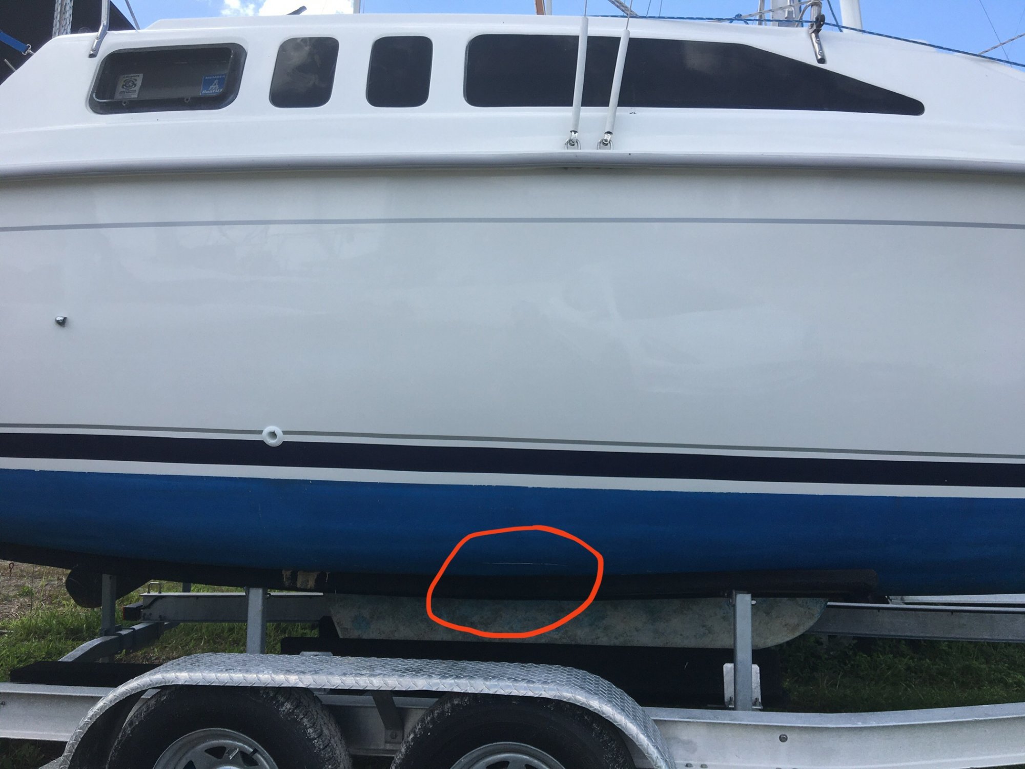

Hunter 260 Hull Crack Below the Water Line

... blow air into the ballast tank vent hole with a shop vac exhaust, leaf blower, or compressor. .... Have a second person on the outside putting soapy water on the crack to see if you make bubbles.

Used a small shop vac to pressurize the tank which actually worked perfectly. A+ suggestion!
Good news is no bubbles outside so hopefully this is just a cosmetic repair we can do from the outside.

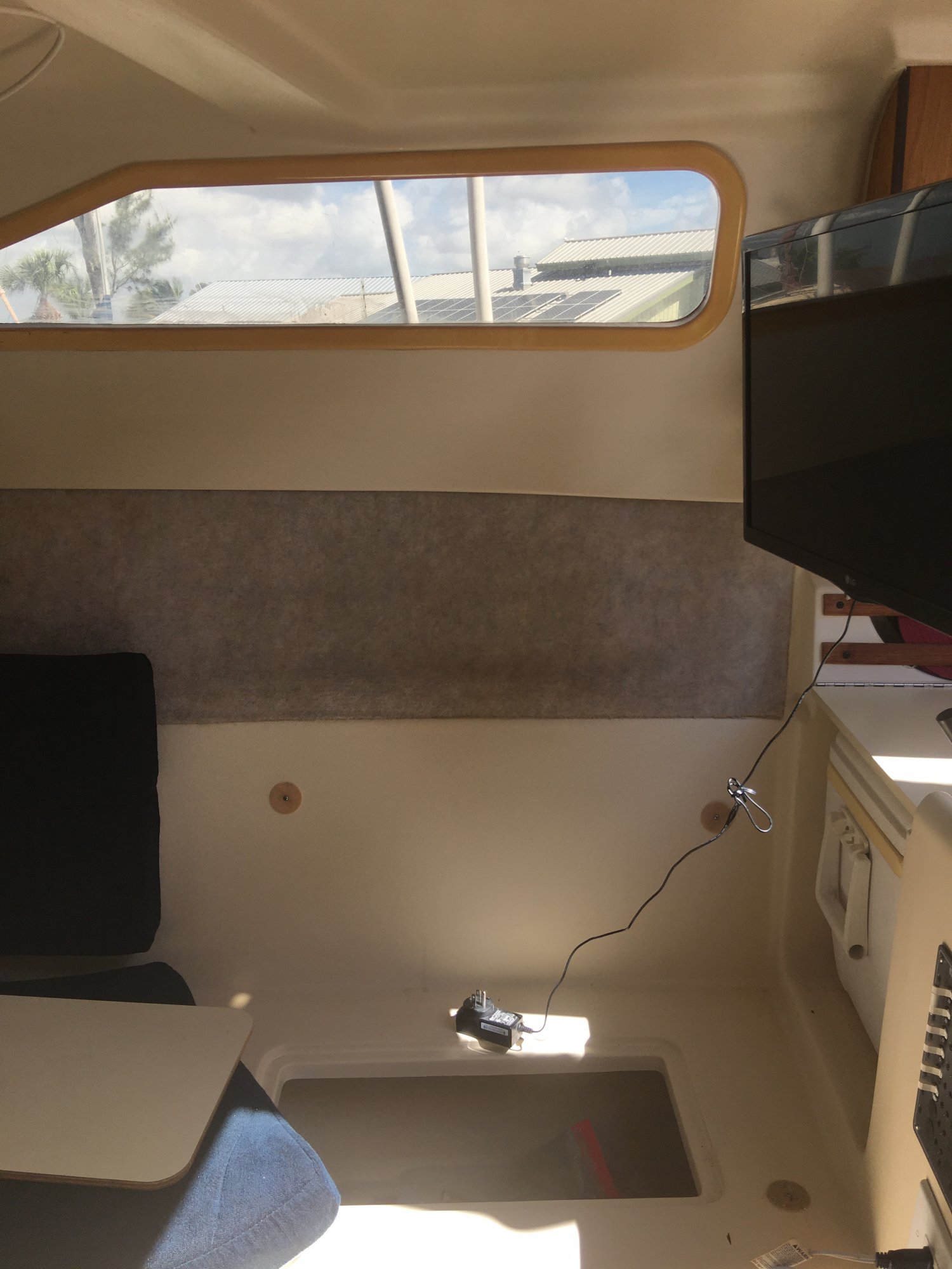

The crack is directly in line with the first storage compartment to the left of the cooler area. In the event we had to go from the inside - is it safe to go through the floor of that compartment and does the ballast tank extend that far?
12,370
Glad to hear you got some good luck. I'm wondering if a hard spot created by the setee (seat top) against the hull, created the crack.

Crack was repaired today. Good news is it did not go into the fiberglass and was just the gelcoat. Now I just need to figure out bottom paint to go over that area... pretty sure it is Micron 66 blue but hate to have to go spend $300 on a gallon of it, especially when I want to use something else on the next repaint.
