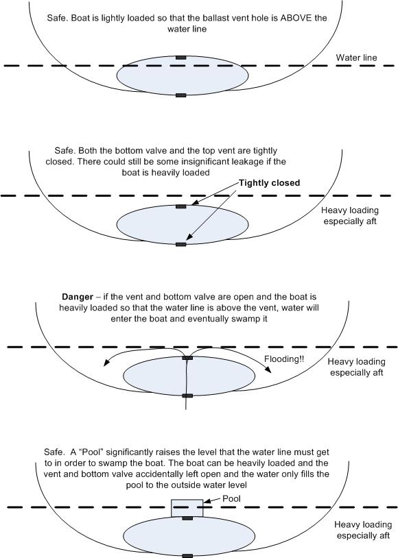

I have not been following this thread since I dont have this boat but Doug is familiar with my boat (water ballast Mac 26S) having owned it along with the Hunter. On the 26S, you can leave the valve at the bottom of the boat and the vent completely open while the boat sits in the water and as long as the vent at the top of the tank stays above water line, everything will be stable. Valve open or leaky.. no water comes in the boat. This is illustrated in the top figure in the picture. You probably also remember earlier when someone with a 23.5 had a big hole in the bottom of the hull (in the water tank location) and the boat floated just fine.
But.. if you heavily load the boat in the area where the tank vent is - and the bottom valve leaks or is open and the vent is open or leaky.. you will flood and eventually sink the boat. The third figure shows this.
So.. I would be surprised if improving the valve seal would have any influence on leaking when the boat is just sitting in the water (ie, in the slip). If the OP had the water come in when the boat was very heavily loaded (like a bunch of people) and the boat has a vulnerability for this.. then the valve seal would help.
FYI, the old Mac classics do have a vulnerability for this issue when very heavily loaded in the rear where the ballast tank vent is. A working valve seal solves this issue but you can add a "pool" around the top of the valve and vent so that the outside water line never gets high enough to cause a problem.

Great diagram. That clearly explains why our next boat wont have any holes in the bottom. Been burned one too many times by water should not have came in but it did anyway. I am a firm beleiver in the KISS principle of thinking and no holes in the bottom of the hull keeps things very simple, or at least as simple as they can be.
Sam

Your diagram may be correct but I wouldn’t trust open water valves as safe. It assumes flat water and no one moving around in the boat. Sloshing can be very messy. You can talk theory till the cows come home but reality is as reality does.
Same here. Also, as I look at walt's last diagram, it doesn't work for the 260 as any runoff (the would-be pool) drains to the bilge.

I didn't follow enough of the the thread to see if the OP's water came in while sailing.. I thought it happened in a slip? Definitely have a good seal on everything while sailing as the righting moment the water provides comes from it being lifted and even if the boat does not have any issue at all in a slip, you could have leakage while heeled. You probably have a warning sticker on the boat somewhere that says you need the valve tightly closed and the vent hole sealed while sailing. Good advice to follow.
I dont know what the Hunter water ballast setup looks like but if water does drain out of the tank into the bilge, it adds weight to the boat and that will lower the water line. If the leak is caused by the water line being too low in the first place, the problem accelerates. Fill the bilge (and assuming you have a significant leak).. the rest of the boat also fills and if you have flotation, you would be testing it. A lot of water in the bilge that can slosh around is very destabilizing of the righting moment as is a partially full water tank.
I dont know if the valve seal is causing your problem.. but I think its a great idea that you are fixing it. Also a good idea to make sure the vent is well sealed when you want it to be.

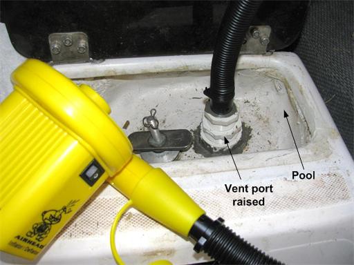

A little off topic for the Hunter but the attached picture is of the Mac 26S setup. The "pool" (shown at the bottom of the other picture I posted) is something I added around the valve and vent after one time having my son (maybe 12 at the time) take care of the vent during a launch. Well... young guy forgot to close the valve and put the vent plug back in and old guy (me) didnt check on things. We had two adults and four kids in the back of the boat and it lowered the water line in the back of the boat (where the vent is also) so that the actual water level was above the vent level. Fortunately I checked before things went too far but had at least a few gallons of water in the bilge and it was coming in strong when I found this. If the vent and valve had been tightly sealed, I would have had only a very small amount of leakage. Regardless, I added the pool as dumb stuff happens..especially if there is a lot going on.
FYI, this picture also shows how I blow the water out of the ballast tank using a low pressure 12V air mattress pump.

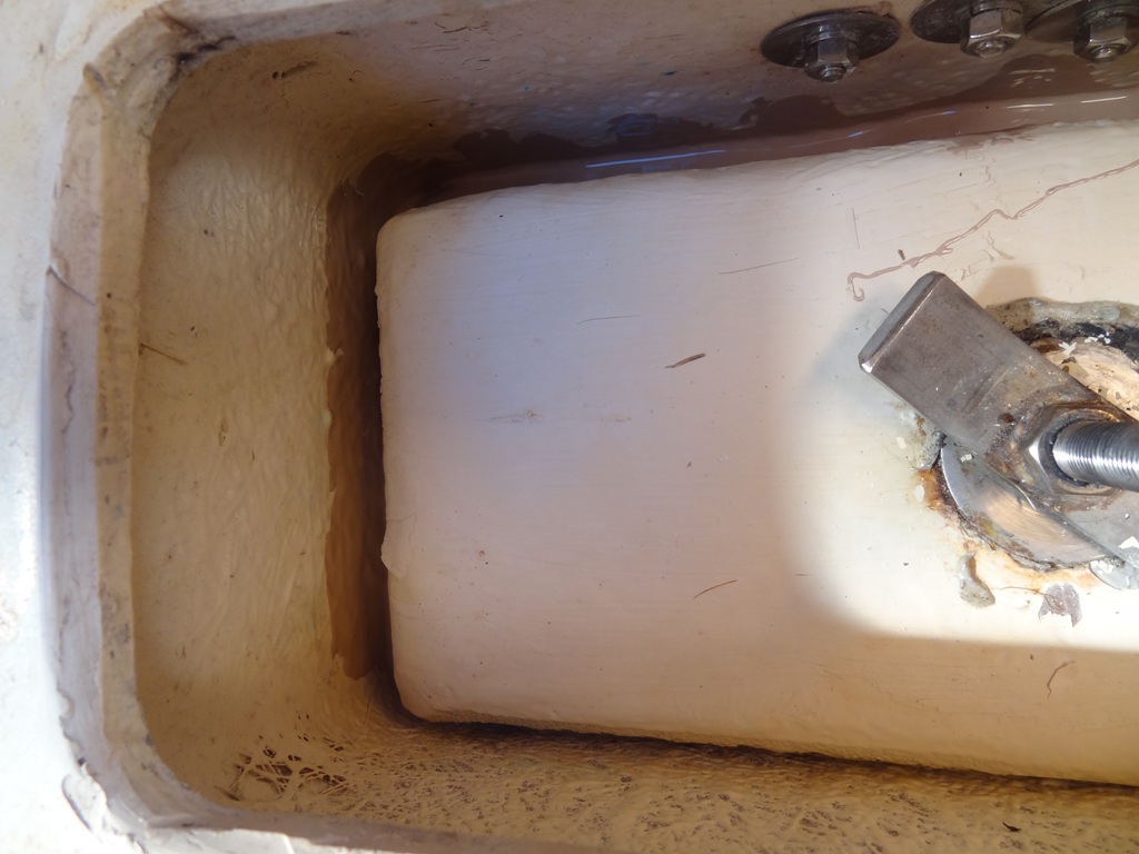

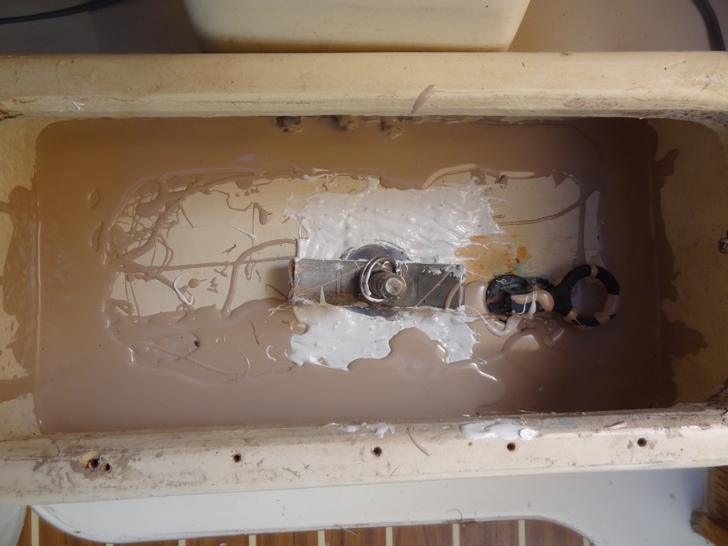

It is a little unnerving that this can happen if not careful.
Regular Guy did what you did Walt, he sealed off the area where the valve is, making a pool area. I think I may follow you guys lead and do the same. I like the technique Regular Guy used.
