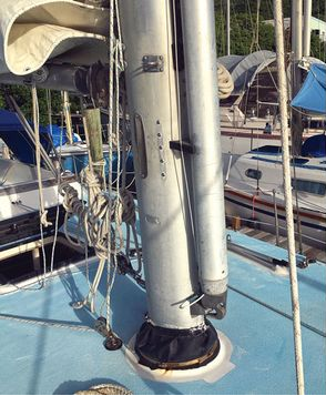

On the mast the way people store spinnaker poles?:
Or maybe just lashed to a pair of stanchions?

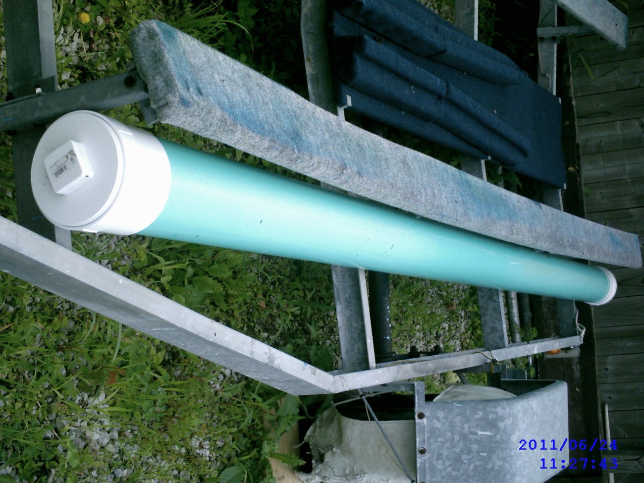

I us a PVC white irrigation pipe . Sealed at one end and a screw cap on the rear. I added a slot so the mast crutch could fit also .
Mounted on the trailer.

I recommend @MaxinCalgary method. I do not recommend the life line or mast. I would not on the mast as the open ends of the mast raising pole and the stainless steel loops will catch or snag lines or sails. Saw damaged sails and frayed lines doing so on the mast and lifeline

Did the same as MaxinCalgary,^ drain pipe mounted on trailer ,Store boom,mast raise pipe whisker pole,Save beating up interior cushions.

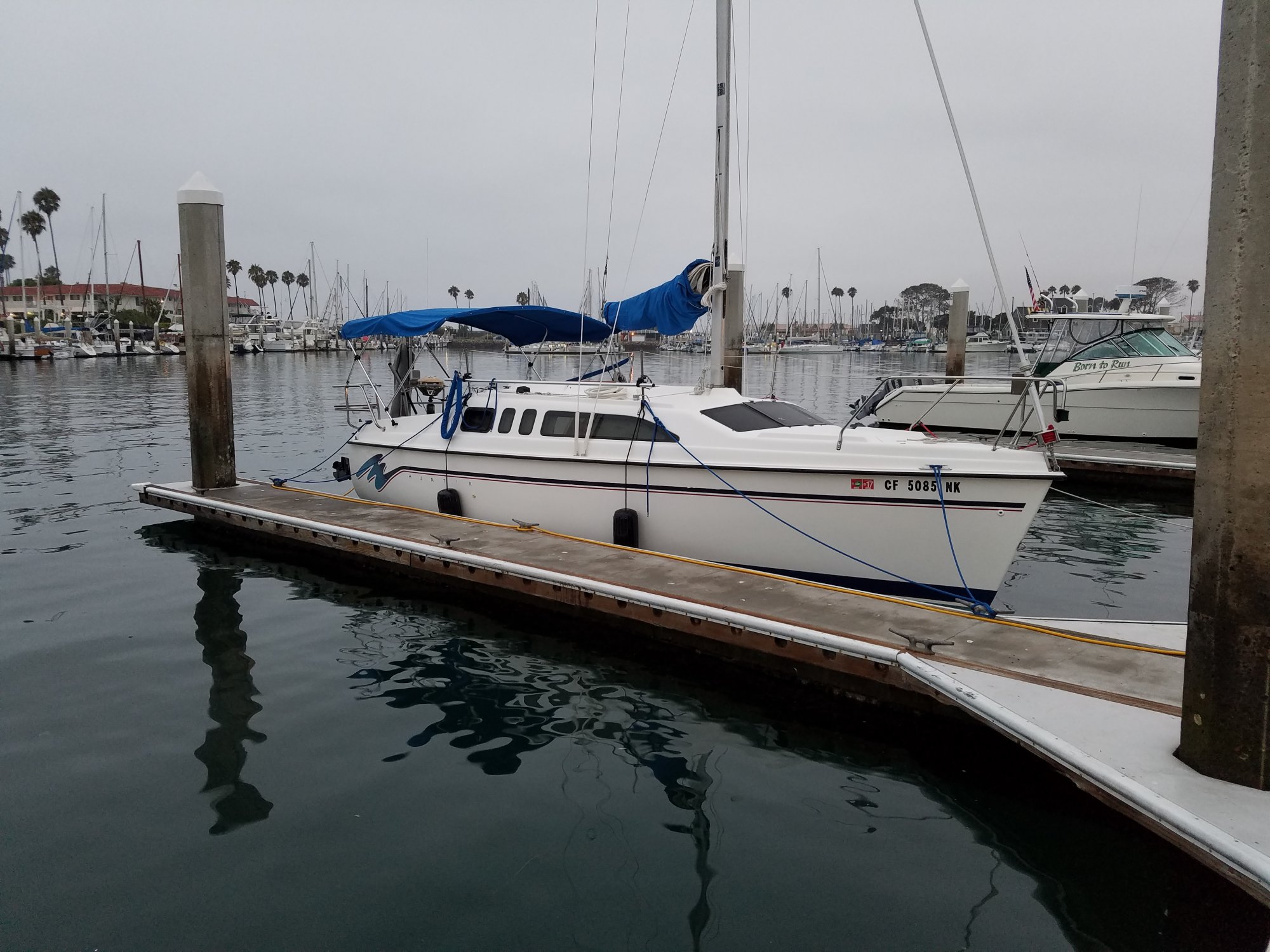

James,
Mine is stored on the starboard stanchions. The PO had it that way. It's been working out okay for me, so I have no plans to change it. It's easy to access and stow. Always on board when I need it. Which allowed on one occasion to motor under a bridge and step the mast on the other side.
If you zoom in on this pic you can see how it is secured with stanchion mount pole chocks.
