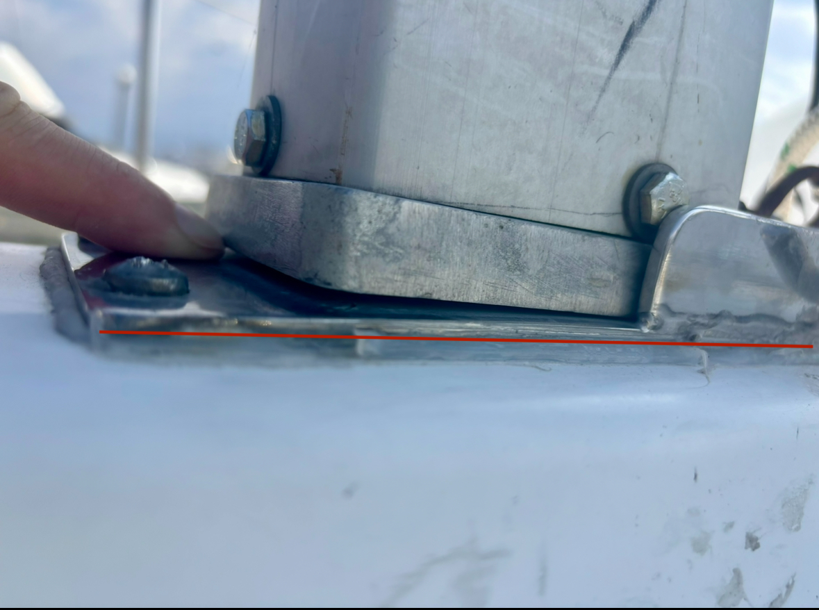

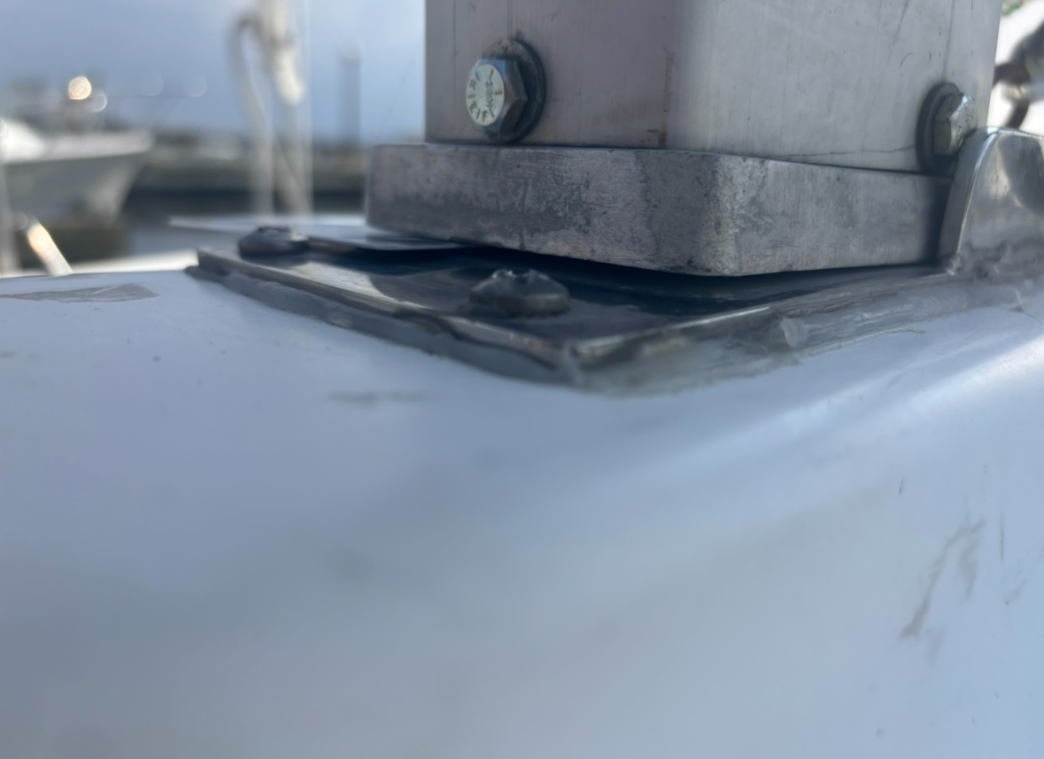

I just noticed that my mast is not sitting completely flush down at the base. The fore part of the mast foot is sitting a few millimeters from touching the mast base. Under sail, especially if sailing with just the head sail in waves, there is some noticeable rocking where this gap will close and open slightly.
Similarly, if I pull on the furler the gap closes slightly and when released goes back to its position.
Attached are 2 pics. I slipped a credit card under the gap to try to visualize the distance.
Is this normal? Do I need to tighten my forestay or adjust my shrouds?

What caught my eye was the silicone sealant around the mast step. It suggests a Prior Owner had a leak there. Perhaps there is some damage to the deck which is causing the step to not be level. It could be an illusion, however the step looks like it is bent. If the step is bent, then the mast would tend to sit on the back of the step, causing too much rake.
14,128
Here's the photo with a reference line added. There appears to be a subtle but definite curve to the step.

It would seem that if the forward base of the mast step is going up it is possible that the aft area under the step has crushed the fiberglass deck upon which the step is supposed to rest. I would be surprised if that SS step has bent, it looks aftermarket and well built.
If it was my boat I'd probably pull the mast out of the step for inspection. Perhaps you can get a boat yard small crane to hang the mast while you inspect the area and restep the mast right then, if all is OK. If it requires work, the yard could store it until the work is completed.

The foot should definitly sit flat on the deck. If it doesn't its putting a tremendous stress on the hinge and/or the back edge of the foot and deck. If I recall correctly, the mast swings back for trailering, correct? Probably a standing rigging adjustment needed.
I removed the mast base put silicone on the base in the spring before launching. The deck does not appear damaged.
The fiberglass did not appear to be damaged around the mast step. I don’t think the base is bent. However, it does seem like perhaps the plate at the foot of the mast has a very slight curve.

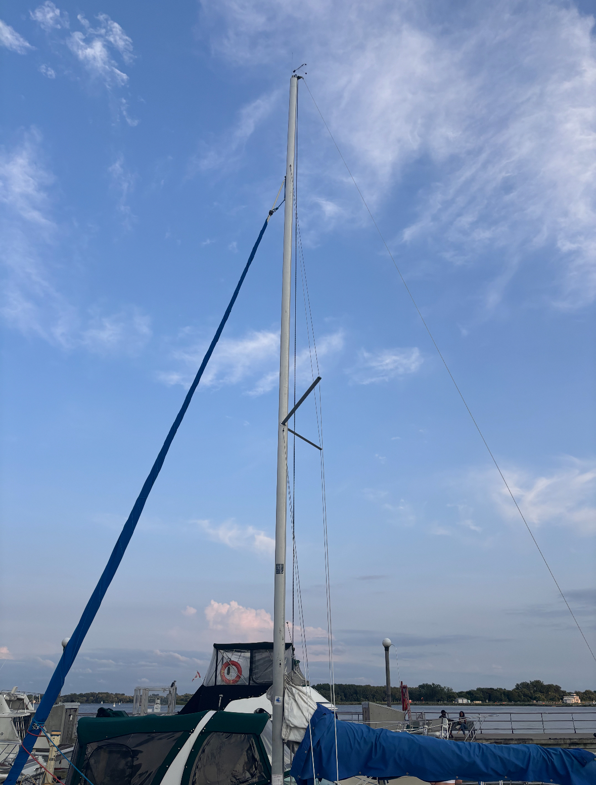

Attached is a picture of the boat side on to try to show the mast rake. I think I’ll need better pictures from further away. I tried measuring via hanging a heavy wrench off my main halyard but it was too windy to really tell.

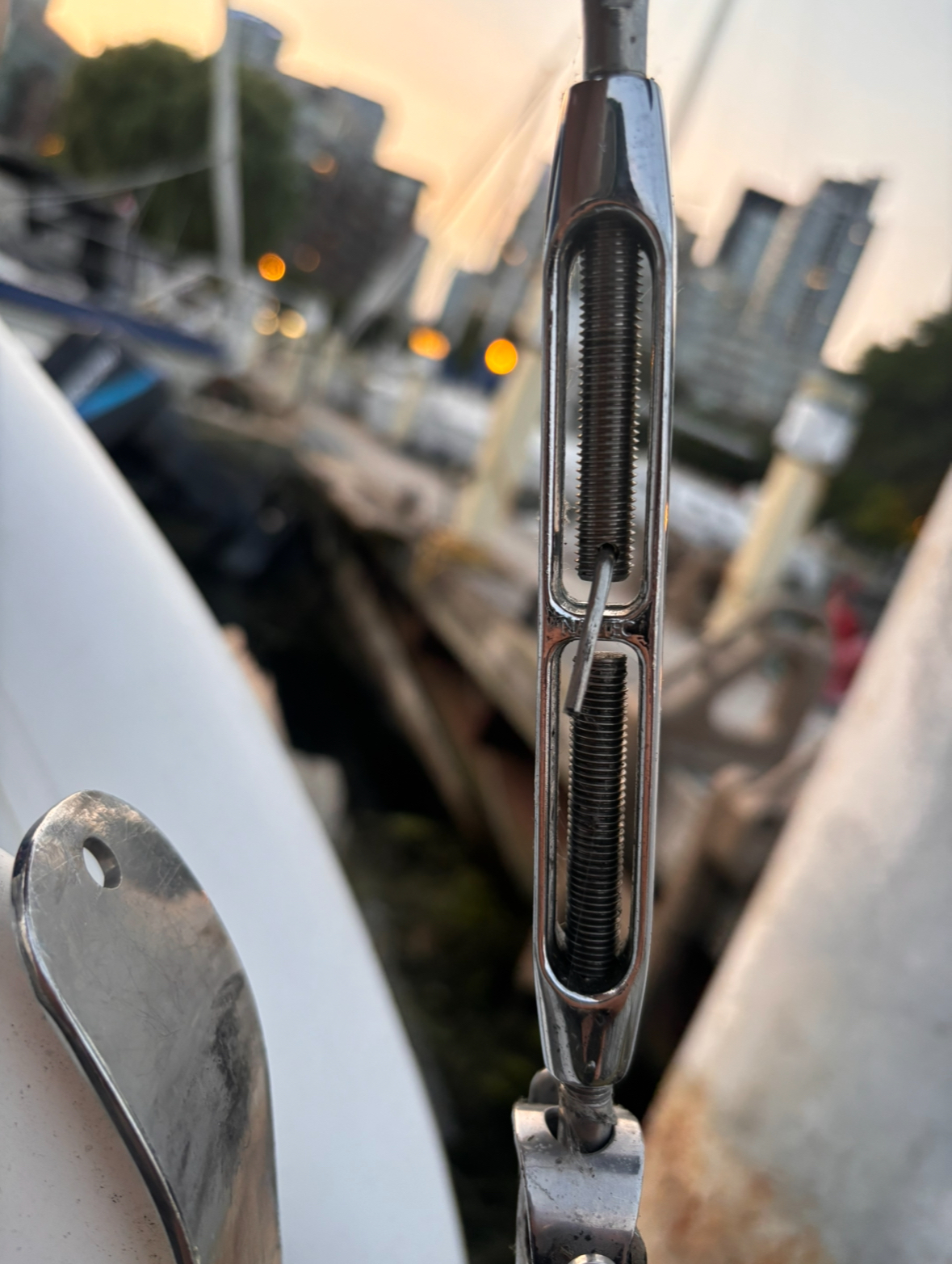

I also inspected the turnbuckle on my head stay and there is no more adjustment room.
Perhaps I could change some of the hardware attaching the stay to shorten the distance slightly and give myself more adjustment without modifying / shortening the stay itself?

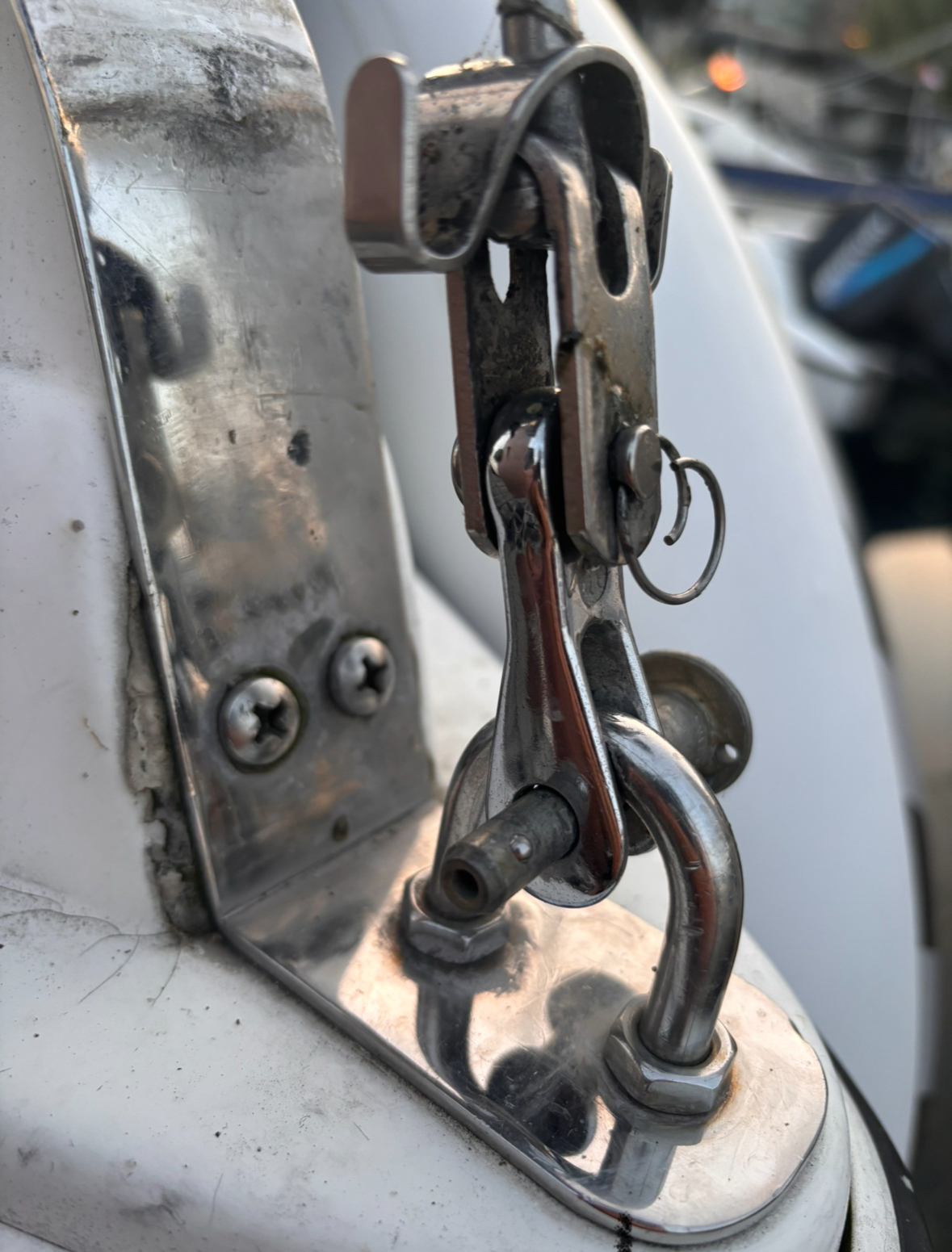

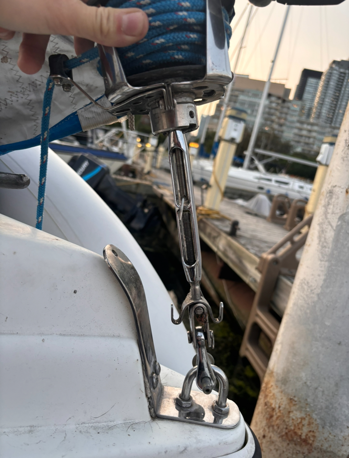

Okay those latest pics are helpful. Where the forestay attaches to the deck you have two shackles from the turnbuckle to the U-bolt. No reason for that. Take off the lower shackle and see if you can unscrew the turnbuckle enough to reach the u-bolt with the the one shackle coming off the turnbuckle. I think that is the original setup. If its a little snug fitting over the u-bolt you can try spreading it a little. If the turnbuckles will not extend far enough , it may be time for a new forestay. Use the mast lowering system (or something) to keep the mast up when you release the forestay. A halyard will work as a temp forestay.
Before doing all that though, you could experiment by releasing the side stay tension and seeing if the mast will come forward. Just count the turns that you unscrew each turn buckle. But it sounds like the stay tensions will all need to be redone by the time all this is over. Not hard, and a great learning opportunity. EDIT: just reread post #1and you said the foot will close the gap in waves under sail. So it will go into position, it just needs the stays properly adjusted.
The previous owner may have tried to create additional mast rake to try an increase performance. Or just didnt know what he was doing. Or the standing rigging is in dire need of adjustment. Either way, you need to pull the mast forward.

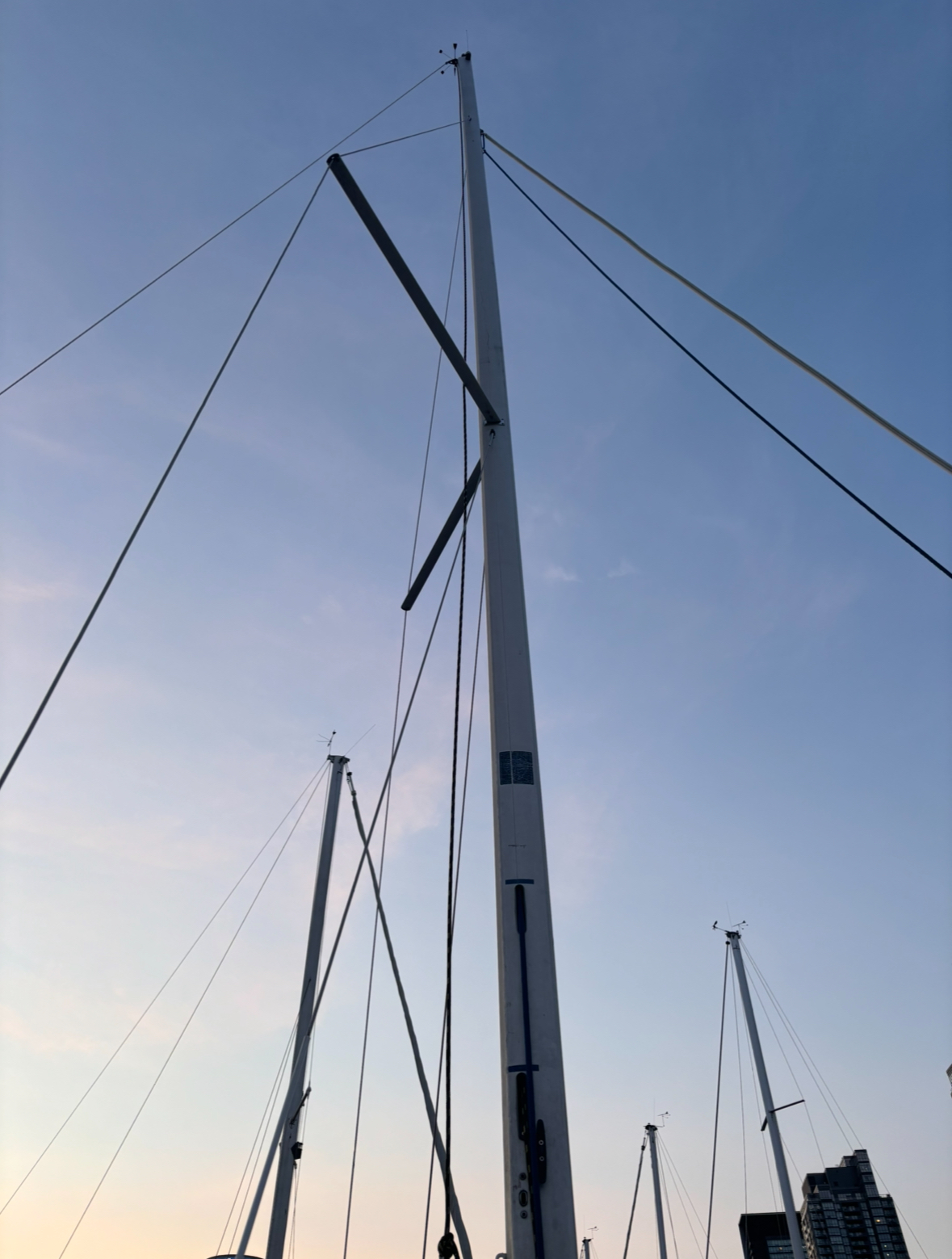

To measure rake, hang a heavy object from the mast head using the main halyard so that is it in a bucket of water. The water will dampen the motion and make it easier to see the rake.
There is way too much backstay tension. The mast looks relatively straight until it gets to the forestay attachment, then it bends back.
The toggle on the forestay is just an accident waiting to happen. The bolt securing the toggle has no cotter pin and the split ring on the clevis pin is shot and needs to be replaced. As @CrispyCringle said, there should be no need for the toggle, remove it and loosen the turnbuckle.
Rake and Prebend are easily confused terms. Prebend is the amount of curvature induced in the mast to match the luff curve of the mast and to reduce the chance of the mast inverting, i.e, the middle of the mast bending aft. Think of prebend as sort of a parenthesis ). Rake is the angle the mast makes with the waterline. See the photo below of the Pride of Baltimore II, a boat noted to have a lot of mast rake.
The photos all suggest there is way too much backstay tension and forestay tension. The backstay is pulling the top of the mast aft and the forestay is pulling the upper middle of the mast forward. The mast is seriously out of tune.
Hire a rigger to tune the mast and teach you how to do it. A boat with a properly tuned mast is more fun to sail than one that isn't. I'd suggest you find a friend in the marina to help, however, there are many who only think they know how to tune one. Ask around and you'll find them, they will tell you " just get the mast straight and tighten it till it feels right," look for the guy in the marina who has a Loos gauge and a measuring tape, there's better chance he'll know what he's doing.

I will try removing the lower toggle with the quick release pin to see if this gives me the adjustment I need.
