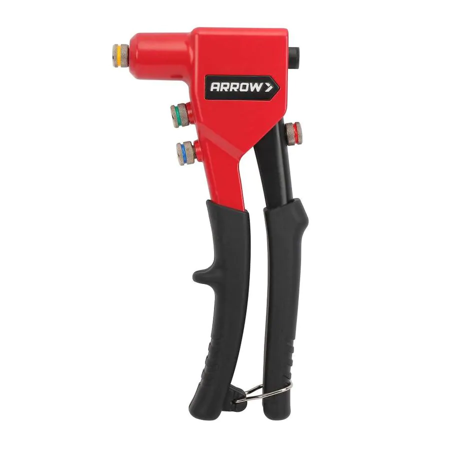

If you have a rivet gun, you could easily drill those out, move it to a new position and pop two new rivets. I got this rivet gun at Lowes...
They are not very expensive and handy for a lot of projects.
Find a bit that is approximately the diameter of the inner dimple and just drill it out.
It is soft metal and comes out easily.
Then take a second bit the diameter of the rivet you are going to use... it will be one that almost fills the hole you are filling in the padeye. Mark where you need the new holes in boom and drill. Move the padeye to a the new position, put in the rivets and two or three pulls on the rivet gun and you are done.
