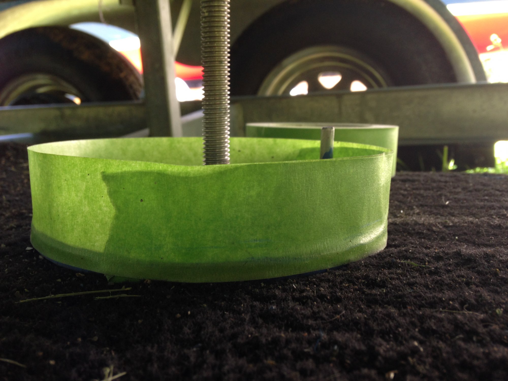

I made a gasket out of "goop". I used masking tape to make a damn and then pored it in. That was 2017 and it is still holding up well.

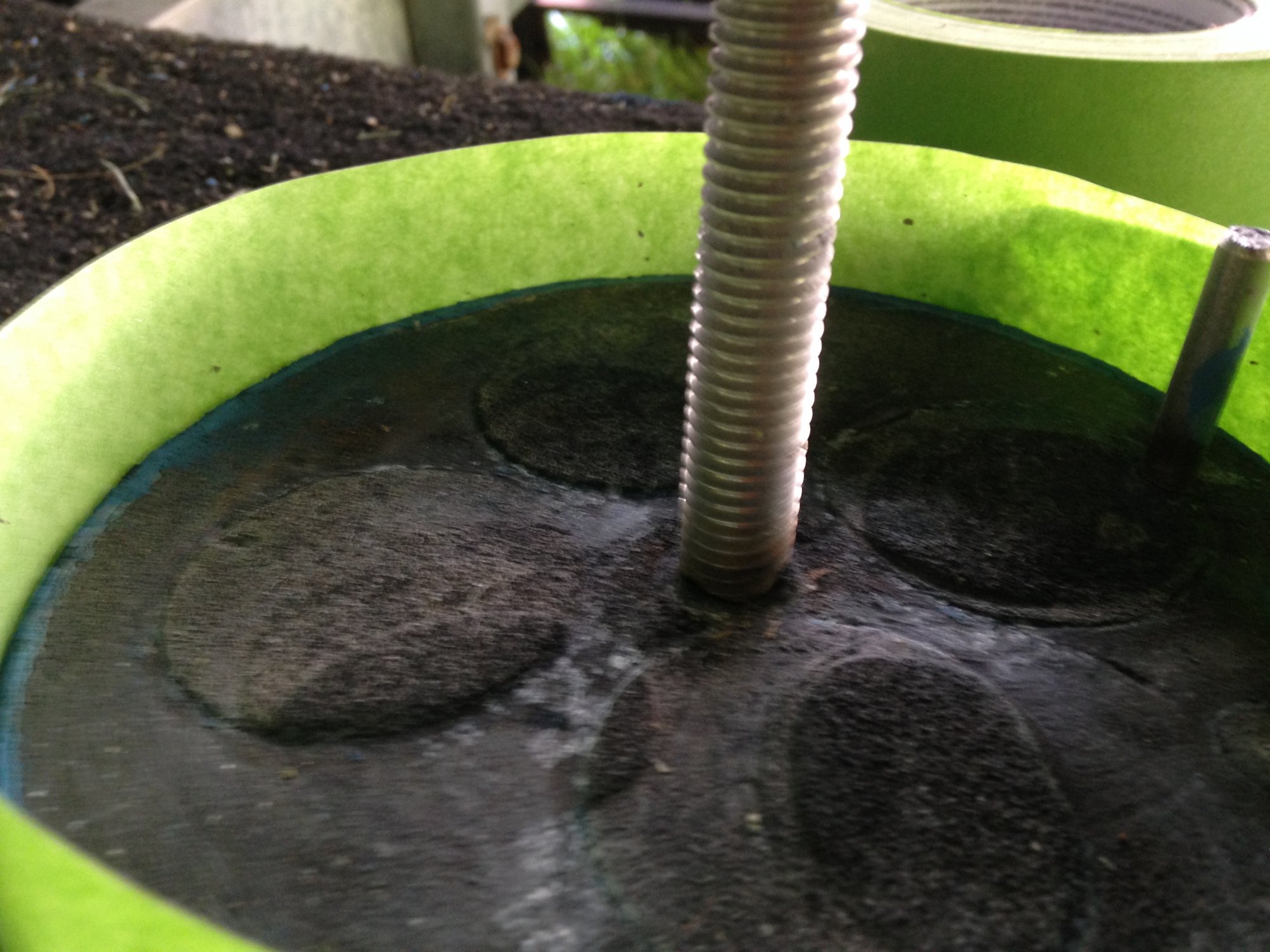

Some questions:
How thick is the gasket that you poured? Was one 3.7 oz/109.4 ml tube enough?
I think I read that Goop is runny enough to self-level to make a smooth surface. Did you find that?
I can see the pattern of the 4 circular holes on the surface of the Goop, as if you closed the valve before it was fully cured. But, that would have messed up the masking tape which appears perfectly intact. Please explain! ;-)

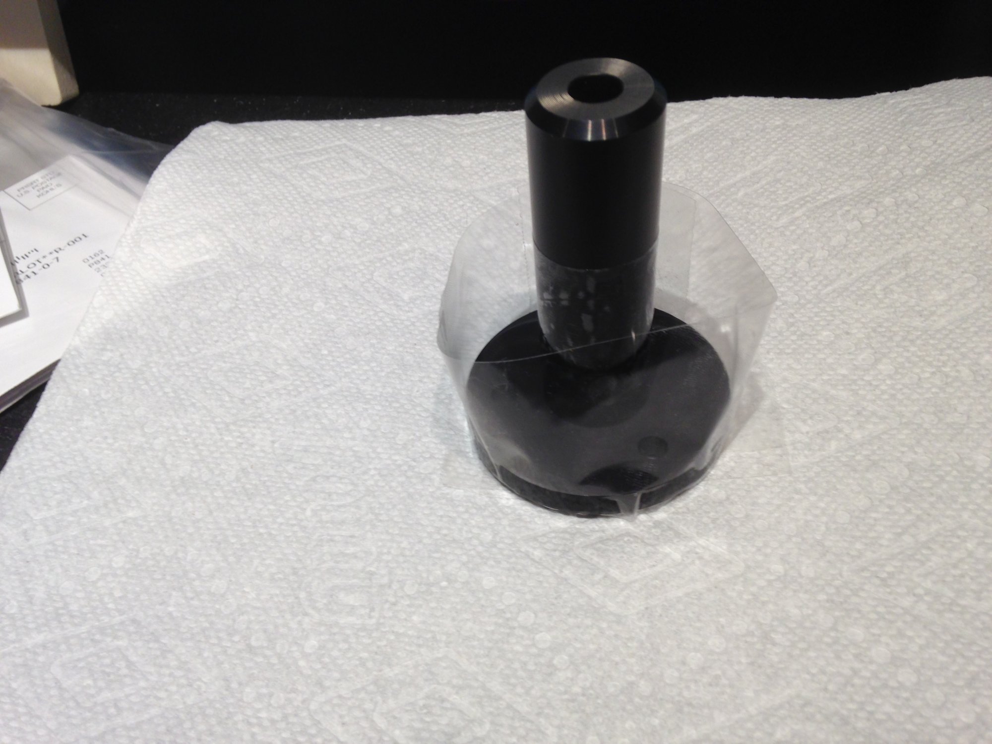

Yes it did self level... and I've done this trick several times. Here is a gasket I made for a keel pin for the swing keel of a Balboa 26... In this picture you can see the cured product a little better.
Here is a pic of a gasket I made when bedding the pedestal mount for my tiller pilot.

To answer your question about the imprints seen on the ballast valve... I don't know what the PO did (I'm guessing nothing) so what you are seeing is the remnants of the old gasket. It appeared to me to be hard glue so I'm guessing that is the 5200 that had been used to glue the old neoprene gasket in place but... the gasket itself was long gone.
And if memory serves me right.. I put two tubes in to make the ballast tank gasket.
Hope this helps. BTW: The goop does stick well once cured. On my boat I waited about 36 hours and then gently closed the valve. The rubber becomes VERY hard in about 72 hours so I wanted mine to still be a little bit pliable so I could get a good tight seal. Now when I lower my valve I do see the imprints in the rubber so... I believe I have a very tight seal.
