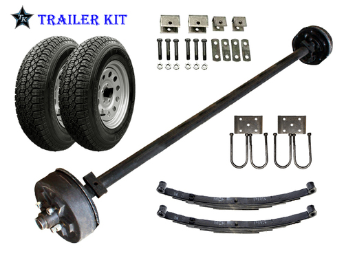

Looks to be 5 stud wheels, plenty enough for that weight, but from the picture axle tube looks light in size, and most likely rusted in the middle from being in the water once too many times. Shouldn't be a big fix, buy a stock width axle that has the same is spring centre bolt to centre bolt measurement and away you go. No need to make this repair any more complicated by looking for a vin #, it's simple, not brain surgery!

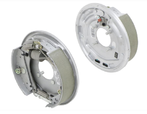

  • Assume it has surge brakes with drums. The drum brake assembly (back side) probably bolts to a square bracket on the axle ends with 4 studs fixed to the back of the brake, or they may be bolts that go through the brake. You'll have to verify you can get the nuts off the back of the axle brackets - likely a lot of rust if your axle really rusted through. If you have an older brake that uses bolts (not studs welded to the brake) you may need to remove the wheel from the brake (via lug nuts) and then the brake drum from the back part of the brake by removing what is probably a crown nut holding the bearings in. That would give you access to the bolt heads of those 4 bolts. I had to cut mine off as a few could not be loosened even with a lot of PB Blaster and a propane torch. I needed to use an angle grinder, and it was a PITA. It is possible you will need all new brakes; not hard to get but keep that in mind as you may have to mail order. If you do get the axle and then can't remove the old brakes without destroying the, you're stuck anyway to move the boat.

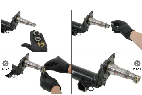

  • If like my H23 KWS brand trailer, it has the spindles as part of the axle, and uses the EZ Lube spindles. I think you may have to make sure you get an axle that has a spindle that matches your bearings. You may need altogether new bearings, or at least some parts (like the tab washer that holds the crown nut on the EZ Lube). I would think you could bring the brake drum to a garage to have the bearings redone (new races and bearings installed) if needed, as it might be hard to do without tools and a workplace (like, not on the side of a field somewhere).
  • If you are lucky you can remove the wheels, take the brake drum/back off the spindle and axle mount but leave it hooked to the hydraulic lines, put in new axle, reattach brakes and wheels, and go. If not, and you need to unhook the hydraulics or install new brakes, plan on having to bleed the brakes.

That's the way to go! Never mind the hassle of trying to match up parts, axles aren't that costly and the new replacement will be great for many years.

This looks exactly like my trailer before I put tandem axles on it.
The axles that came on those trailers were not galvanized and if it were dunked in salt water periodically it would be amazing that it was still intact at all at this point.
All of the components are standard sizes and available off the shelf except for the drop axle. I could get a straight axle but had to get one made to get the same drop.
Once you get into it is not worth putting the old stuff back on. Were it mine I'd cut the bolts that hold the springs on using a rip saw "Sawzall". Even if you can get the nut off the bolt is corroded into the spring eye and a real bitch to get out. Then it is very straight forward.
The axle has three critical measurements:
1. the distance from spring center to spring center
2. the distance from hub face to hub face
3. the drop from the spring to the spindle
If you are making this trip again in the future you may want to consider a tandem axle conversion or upgrading to a #5,000 axle.
