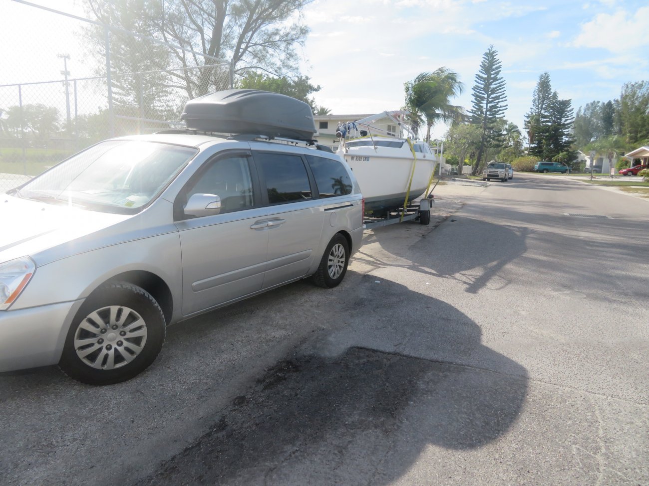

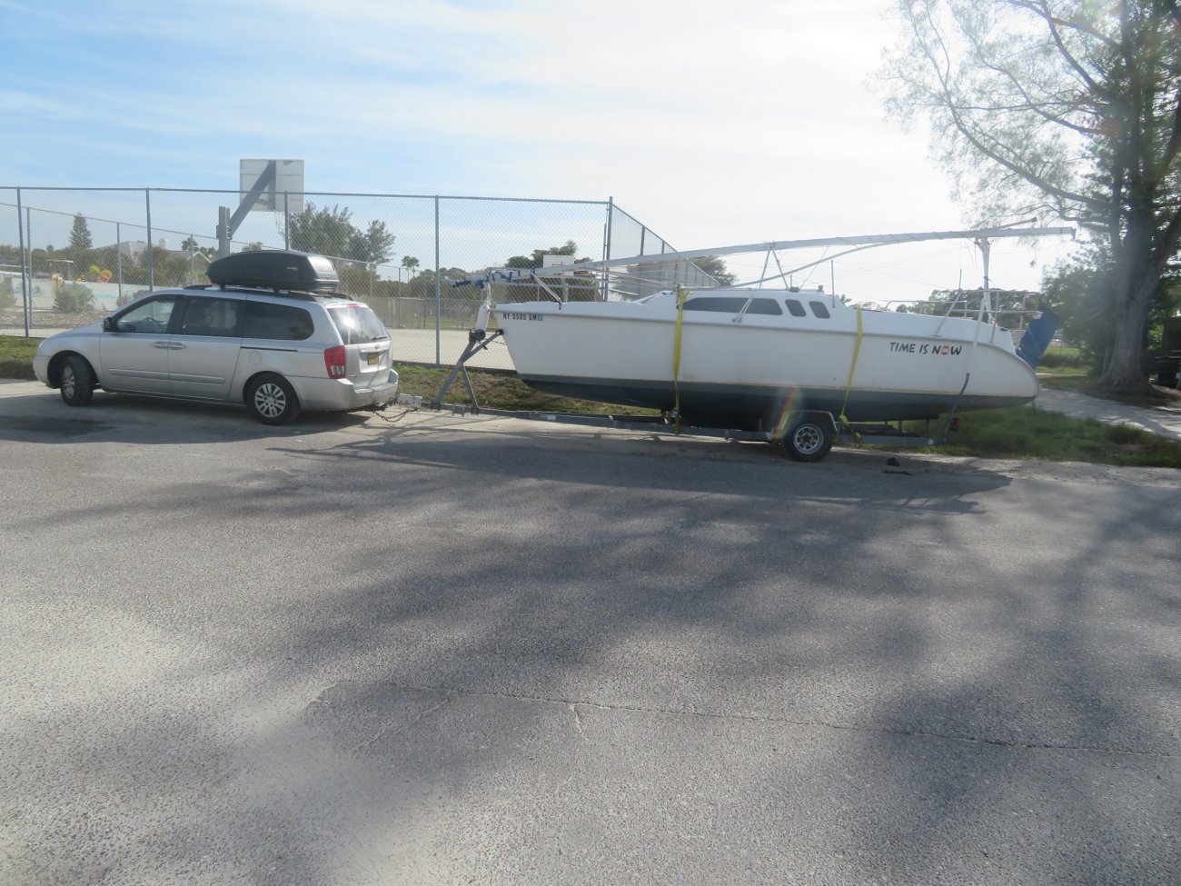

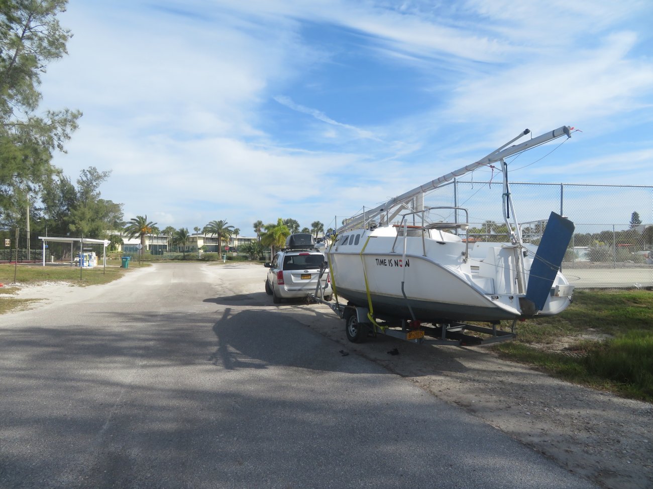

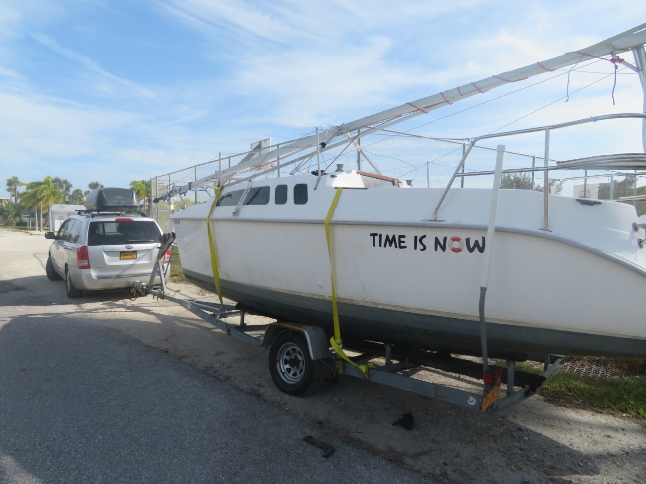

The VIN number is a big surprise for me. Please look at the pictures and tell if it is possible that this trailer is for 12 foot boat. The pictures are taking 10 minutes before we start that journey from florida to NY.
1. At the moment when I the boat was taken out of the water on the trailer certainly she had water. The valve was opened and I stopped 30 yards from the ramp to drain everything.
2. Pressure in the tires was checked and it was normal on both sides
3. Left blown first (pieces of rubber missing from inside because of the axle bent downward) and was replaced by a "new" one. Right tire not blown yet but is missing rubber on inside for the same reason and need replacement. That's why I stopped and left the boat in NC. The axle at that moment looked really bad, almost touching the ground.
4. I didn't know that this can happen with the axle otherwise i would pay attention because even on the pictures taken before the trip it is possible to see that the tires are leaning inward.
Thank you all for your help I still cannot find any mechanic or business in that area.

It does not seem like that trailer was for a 12 foot boat. That would be half the length of yours, and the stern would end up around or just in front of the wheels. Doesn't seem like that would be the case if the trailer really was for a 12 footer. The wheels on yours appear to be just aft of the boat center, which is what I'd think is right.
The VIN on my '91 trailer is all but unreadable. Is it possible one or more numbers you recorded are wrong?

As for the trailer, the guides on the trailer indicates it is a Hunter trailer built specifically for a 23.5 as I was involved with the design. Thus I need to know the VIN number what you have to confirm either you have the correct title or not given to you by the broker. If given the wrong title I can guide you on how to get a correct one.

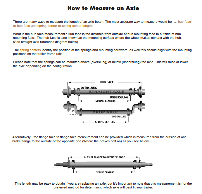

The trailer has a drop down or drop axle as in the diagram submitted by Meriachee which I am thankful for. If I recall the trailer side braces are welded into a V which is why I need to talk with Chern. I will send him a private message if I haven’t done already. There is more info which I need but the trailer is correct.
