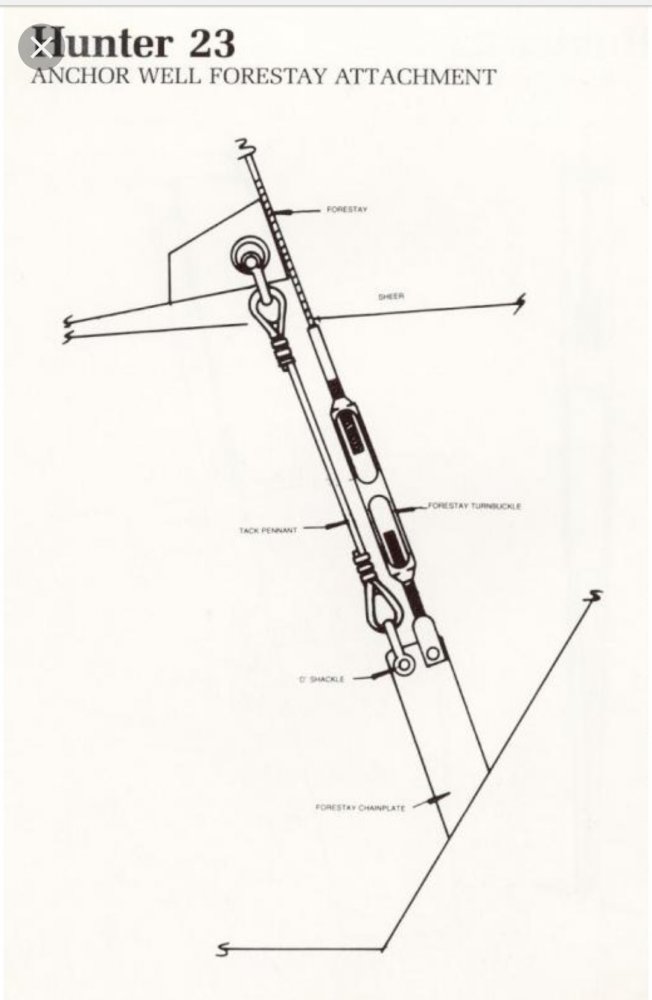

Hunter 23 tack pennant help plz

I just use a short piece of small high strength line with loop run thru the shackles on both ends, infinitely adjustable.
Jul 31, 2018
46
Hunter 260 Chapin
So you are using line instead of wire? I thought of that too. Any problems?
Feb 18, 2011
341
Hunter 260 Cave Run Lake, KY
I've used 3/16" amsteel dyneema high strength single braid line for pennants- no problems, and great UV resistance. I'm gonna use it for lifelines too when that time comes.
Likes: P100D
3,024
Catalina 320 Dana Point
No, just use a piece of low stretch, you just have to adjust length/tension the first time for a furler. I do it kind of like a truckers hitch so you can tension it after the sail is up also.
Likes: P100D
13,019
a down haul might be a nice touch. A single block at the tack and a double at the chainplate. Then you could adjust the tension in your luff very quickly. I guess the halyard serves the same purpose .... just a thought.
