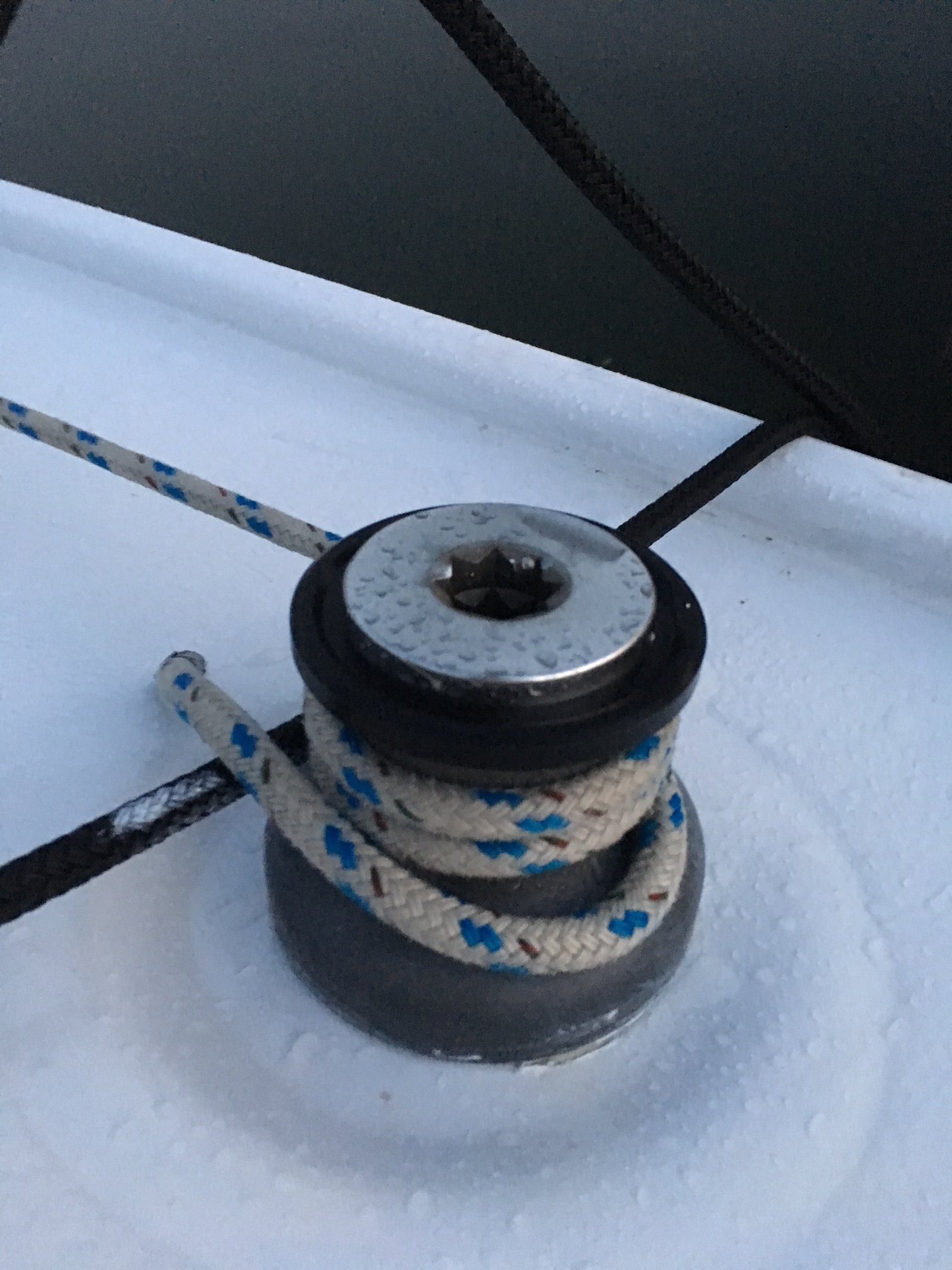

1 - I'm looking to replace the current jib winches on my H23 and would like to put on 2 #6 Harkens. Will the Harkens fit? And should I buy need any hardware or do the Harkens come with all needed to attach to the boat? The current Winches work fine but look extremely weathered. Also they bolt directly into the boat with a wood backing plate inside the cabin.

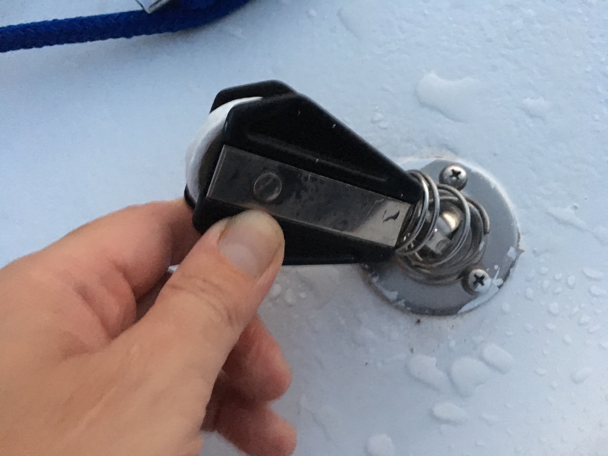

2 - I'm also looking to upgrade the jib sheet pulleys. Either just by buying new plastic interior wheels (if I can find them) or replacing the whole assembly.

1. I think a little metal polish would fix those winches up fine.... there's no point in replacing them unless you're upgrading to self tailing.... or want a larger winch... in which case you can move the old ones to the cabin top for your halyards. New winches don't come with fasteners or backing plates. If you do change... use the existing wood backing plate and mount it as it is now.. there's no need to put it on a pedestal unless you don't like the angle coming from the jib lead block (not pulley, btw)
2. If you really want a practical upgrade...take the money you were going to spend on the new winches and install a 2-3 foot track with sliding car .. so you can move the jib leads for better headsail better trim. As far as the existing block..don't try replacing just the sheave.... better to get a whole new block.... about $20 buck apiece a Harken Bullet.

Agree with Joe. And, if perhaps the problem with the winches is that the barrels are slippery (worn slick) you can consider replacing the barrels only or you can take them to a machine shop and have them resurface them (bead blast) so that they have some "tooth" to better grab the line.

I bought a set of the harken 39mm jib lead blocks and will put them on this friday. My wife and I climb all over the deck so I'll hold on the rails for a couple of seasons.
Great tips guys and Ill give the polish a try on the winches/see how that goes and take them to a machine shop if they dont shine up well. I'll save a bunch of cash that way too and I think the winches would look better if i can find replacementss for the top rubber O-rings.
Any recommendations on what metal polish to use?
You mean the tracks? Not seeing your reasoning.. the tracks are about 1/4" high... with one block on a movable slider. Aluminum T track from Garhauer for $11.25/ ft. A track car and block from the same company is $50.
Add $15 for fasteners and for under $200 you'll have a very slick addition that will improve your sailing.
Lots of folks use this:
The wax will help the rubber also...you can get it at an automotive store... Amazon sells it for under $15. WM wants $22.. !!!!
