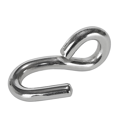

My boat is an 87 and the part I got is the hook in the picture below. Unfortunately, upon closer inspection, this isn't my gooseneck. I'll get a picture of it next time I'm out at the boat. Thanks.
8,038
Hunter 26 Lake Martin AL
That looks like the hook I have.

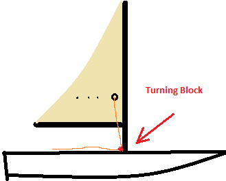

In a pinch, you can always take line through the reef-tack-grommet from a point on the mast foot. On my H26, the mast foot has attachement points where I can shackle a turning block. If you tied a line to one of those points, then brought it up through the reef-grommet, then back to a turning block on the other side of the mast, you could then run a reefing line all the way to the cockpit and not even have to leave the cockpit to reef.

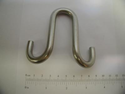

Or you can buy a hook that looks like this at Tractor Supply, Lowes, Harbor Freight etc...
And bolt it with a washer here...

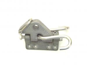

From the first photo you included it looks like someone may have changed out your gooseneck. (Holes in mast below current goose neck. )

I wouldn't be surprised if someone changed something along the way. I looked at the catalogs and I don't think the gooseneck on the Z145 mast looks right. If I look at the 2000 catalog at the Z170 it looks like that matches what I have.
