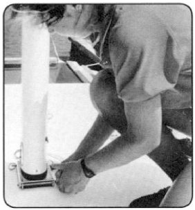

That ain't a stock mast step for the H23! The mast step that came on the boat has two pins, one fore and one aft, that allow it to act like a hinge. When stepping the mast, you put in the aft pin and then raise the mast. Once up, you insert the fore pin and you are ready to go. Picture is shown below (taken from the H23 user manual).

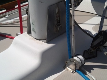

As for your pivoting mast step, I have always seen and used them with the bottom of the mast resting on the bottom of the plate and the bolt just used to keep it in place (ie: Number 2 in your picture). Actually, I have never seen or can even imagine how you would get the mast to the number 1 position (raised and resting on the bolt) in your drawing. You would have to first step the mast then lift up against the shrouds and stays while having someone really tighten down on that bolt.. and if not tight enough, it can slip while underway! Below is a picture of a similar mast step in the upright position where you can see it resting on the bottom (taken from a Dolphin-24 web site).
