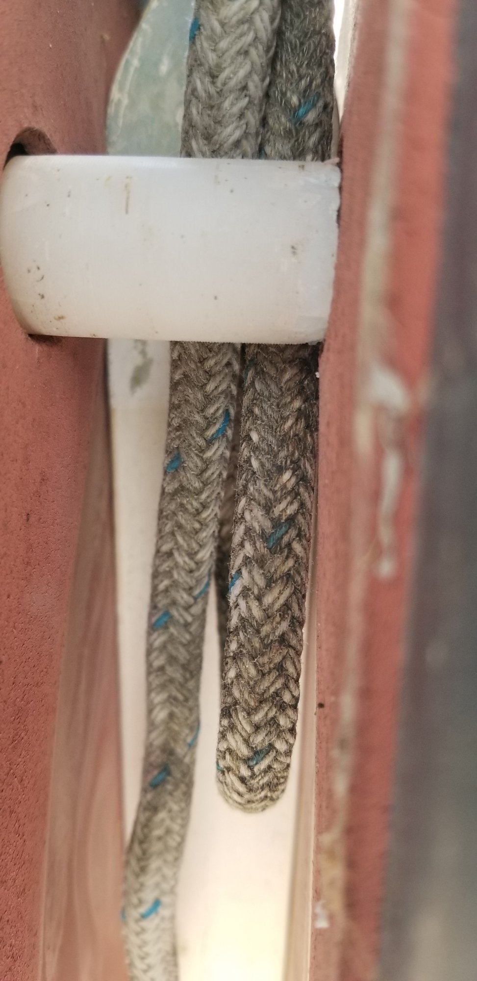

2.) is there a good photo/vid showing how the rudder rigging is supposed to be run through the transom and rudder paths? I haven’t taken off the hard yet (waiting to get my outboard back). The rudder rigging that is currently on it has the line under the bolt and it looks to me like it’ll start fraying from the friction. The manual photo is too congested and unhelpful.

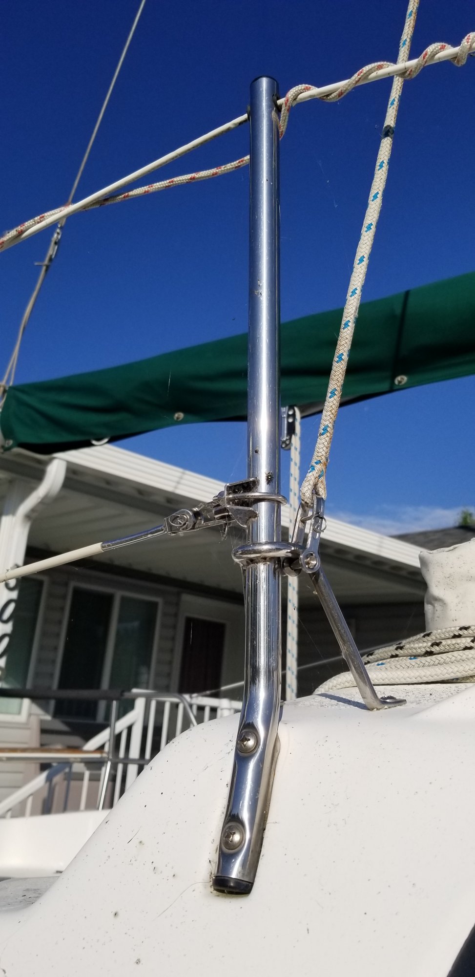

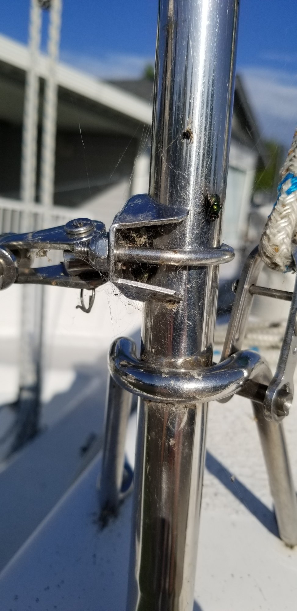

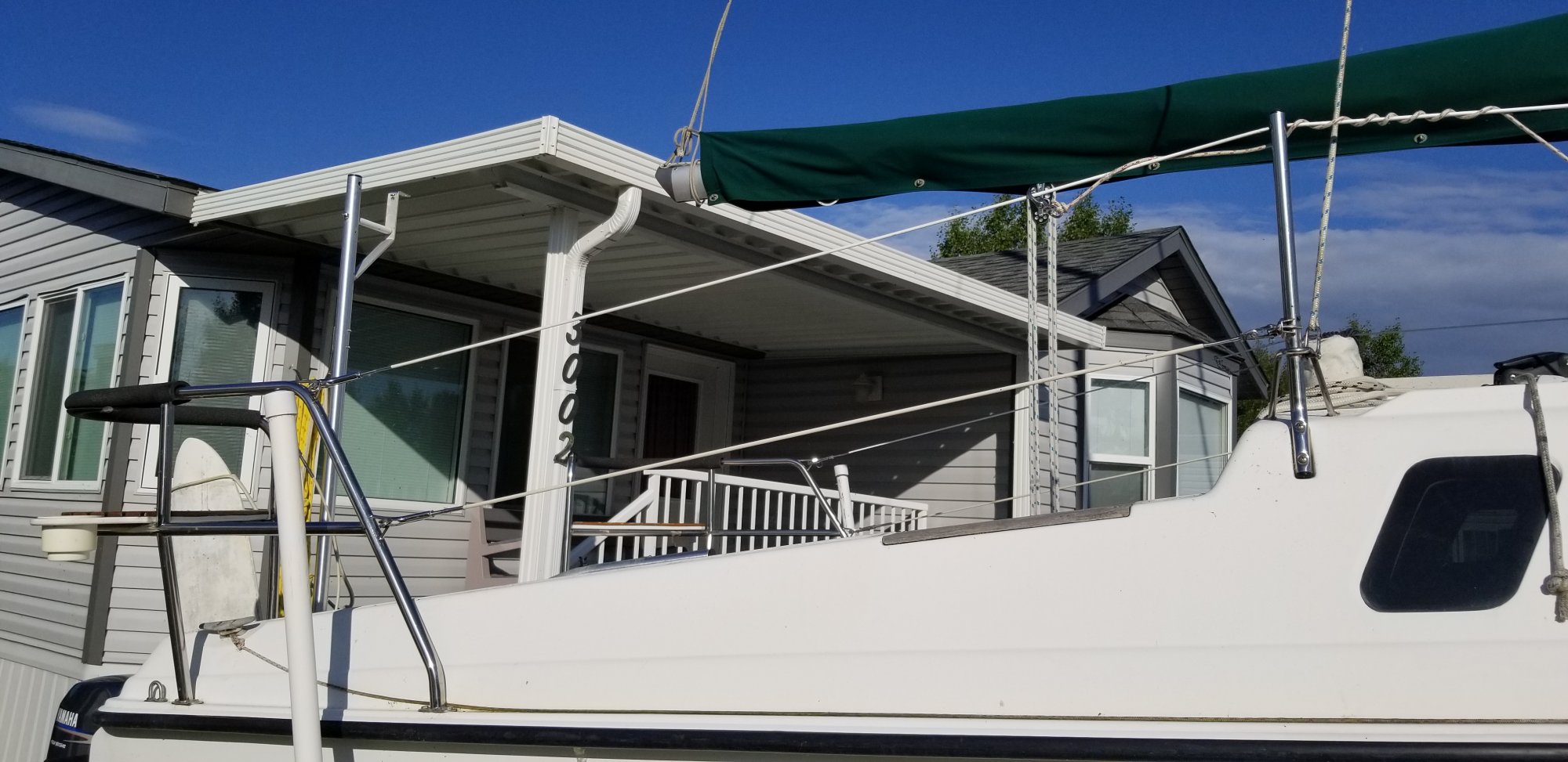

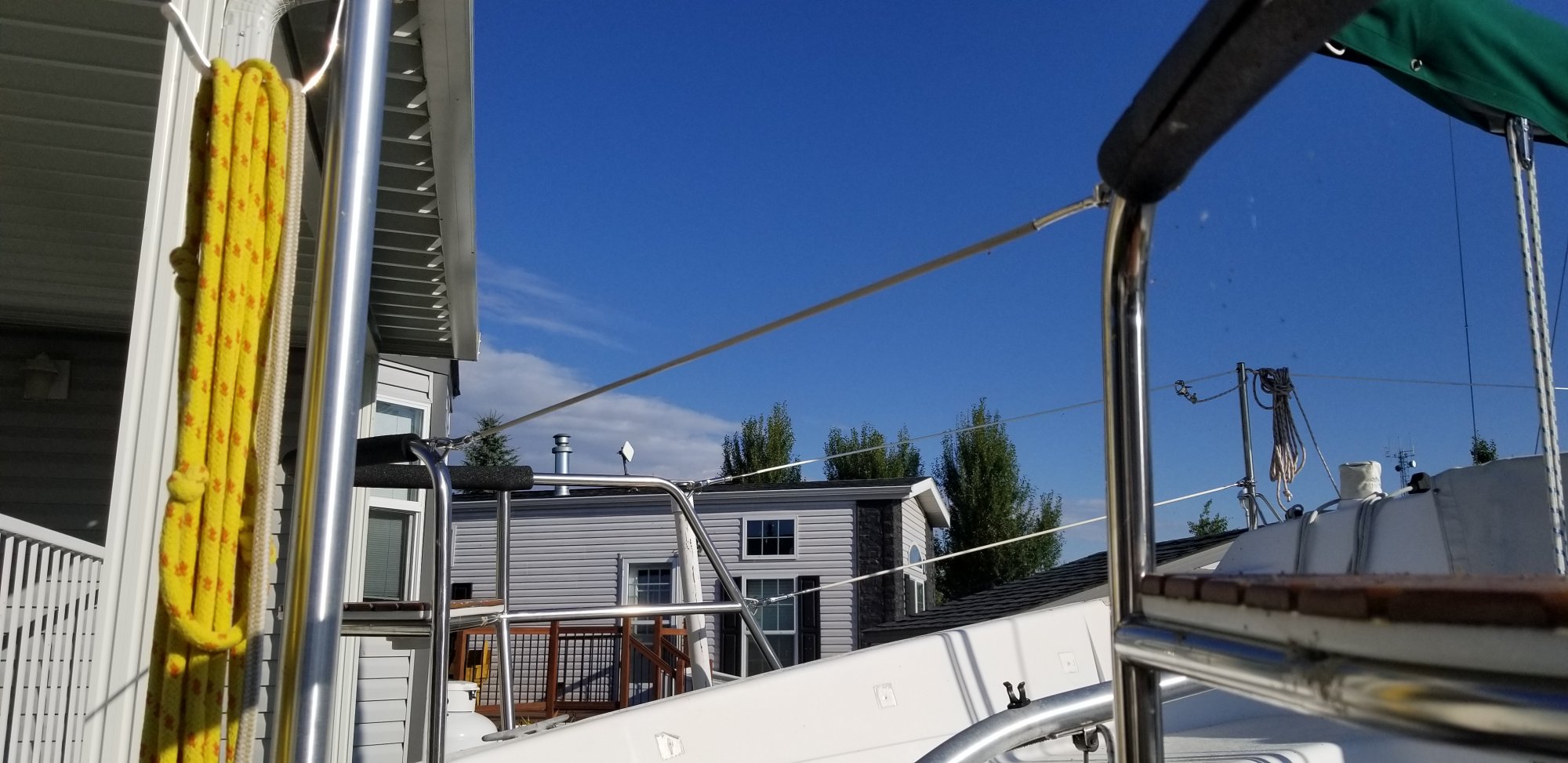

I bought Stern rail seats for my '95 H23.5 in about 2003. I'm pretty sure the local sailboat shop ordered them from the Hunter Factory. I don't know if that is still possible. I'm not sure what I paid, but it was 16 years ago and I live in Canada and they had to be shipped from Florida. My price wouldn't mean much now.
I'm writing to suggest you consider doing something I did, which was to have the lifelines modified to connect to top of the stern rail seat posts instead of the u-bolt on the side lips of the boat. That leaves a big gap between the combing wall and the upper Lifeline, so I had a short second piece run parallel to it from the stanchion to a middle point on the stern rail seat. This was all easy to do because there were little Loops already welded onto the stern-rail seats for just that purpose. If not, they make bolt-on connectors. I also had a short life line fashioned to fit between the top of the two Stern rail seats to help keep people from toppling out the back. There were Loop connectors for that as well.
I can post photos tomorrow if this isn't clear.
I always leave the mast crutch in place. It gives something to hang on to when you're standing by the tiller.

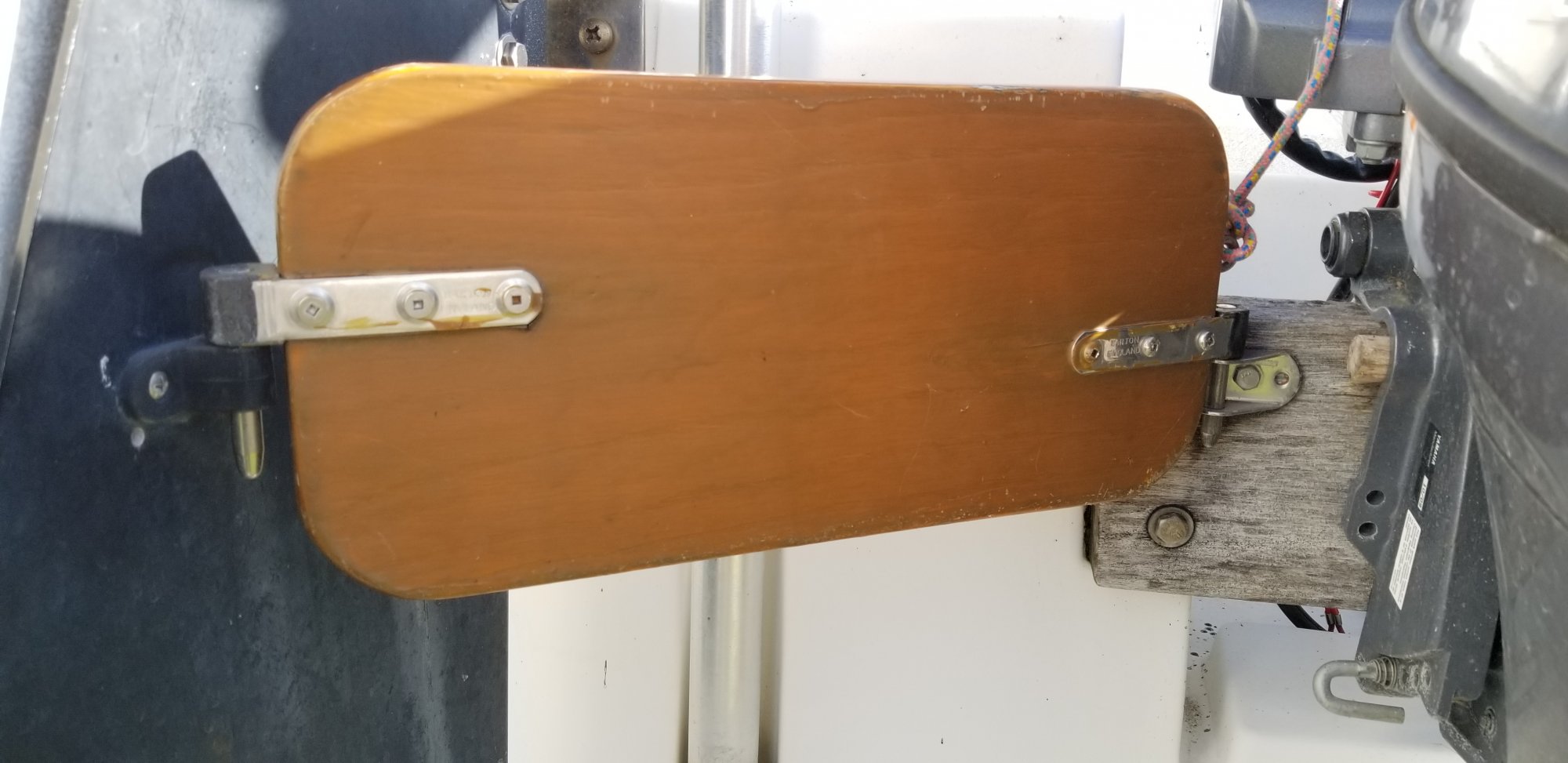

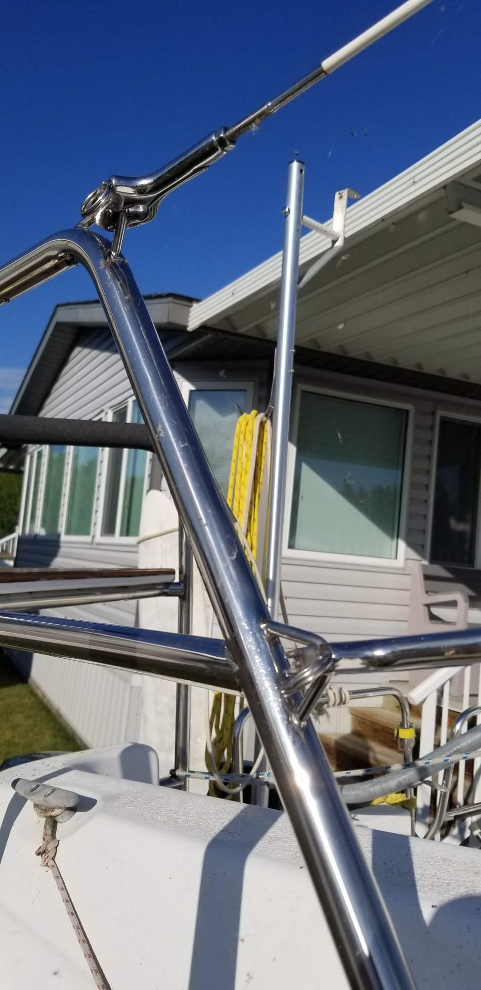

Here are some photos. The one of the rudder lines probably doesn't help but it's hard to get a good view. I incuded the rudder lock (thanks Rick Webb!) which is one of many favorite mods.
I'm glad I spent whatever I did for the stern rail seats. I wouldn't be without them. The boat was only 7 years old when I got them so I've certainly got my money's worth.
I regret not buying cockpit cushions but it's too late now. My salon cushions are vinyl so I use them in the cockpit sometimes.

Rick,
I like the rudder lock. Nice idea. I have to raise mine because the marina Im at is not very calm water. No wave break, so a lot of wake action. Kind of hard on the spade.
