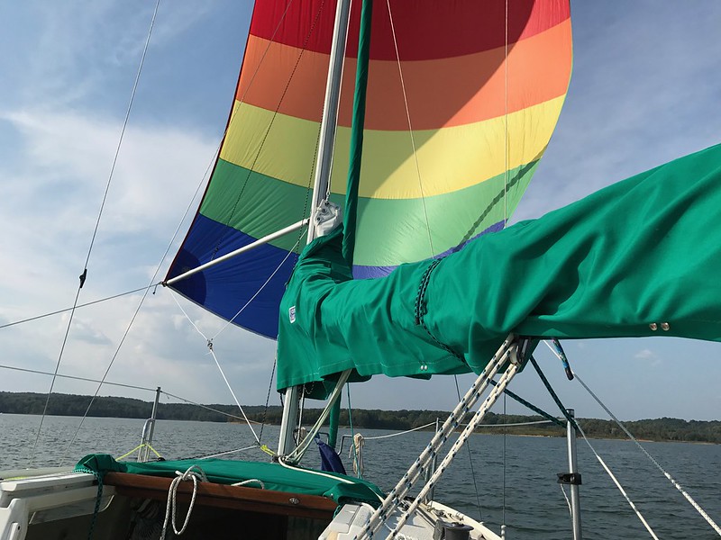

I finally got all the rigging and tried the spinnaker out. What a blast! I loved it. It was a lot of set up compared to a roller jib and main. But the down wind efficiency was pretty impressive. It was a good day for practice. Nice 3-5 knot winds. I tried out all the wind angles, gybes, and took it down and launched it a few times.
From what I could glean from the owners manual drawings, which are pretty vague, the 23.5 is rigged much like a classic dingy rig, when it comes to the spinnaker. There are no guy lines, just sheets. The pole has a topping lift and a down haul, both led to a double block on the base of the mast and run back to cam cleats.
One thing I couldnt find a good answer on and just made a best guess- the attachment of the pole to the sail tack? In one video, it showed the pole with the sheet running loose through the loop at the end of the pole., so the sheet could slide through the pole end. That didnt seem right on this setup, so I clipped the pole to the tack. Seemed to work great.
Overall, very easy to fly. And one more thing to master, which I like.
