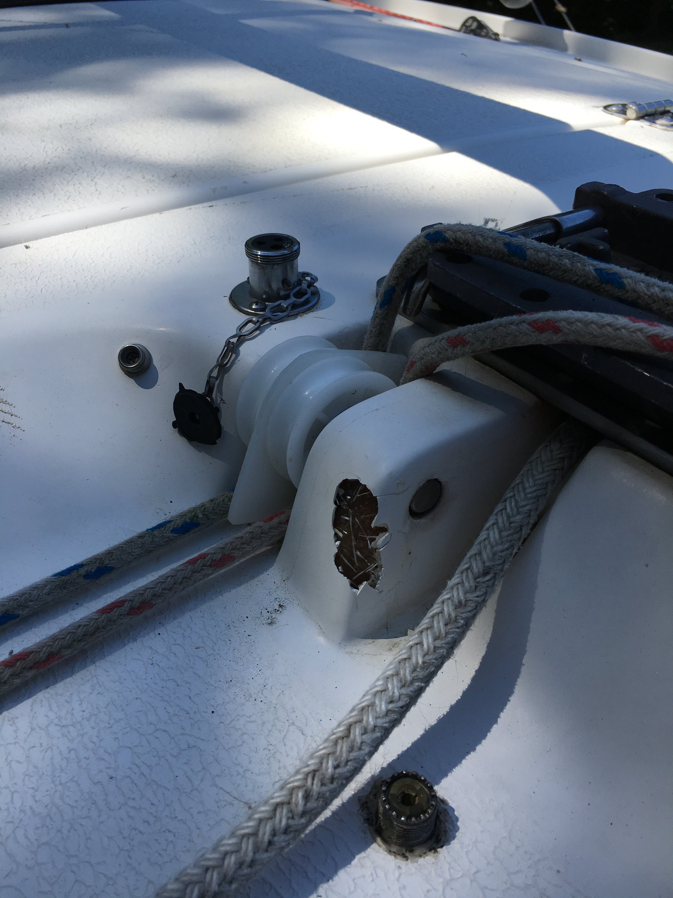

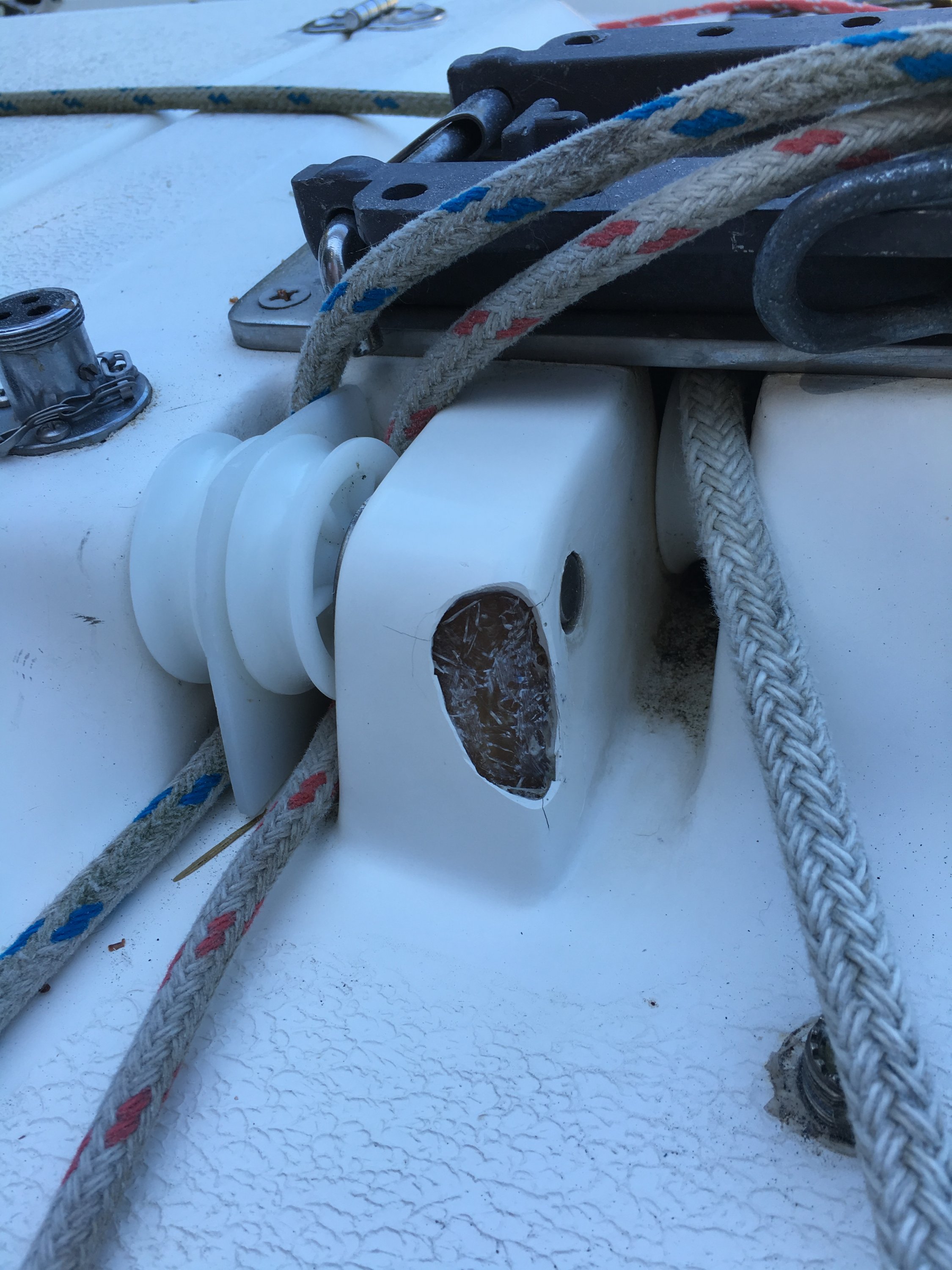

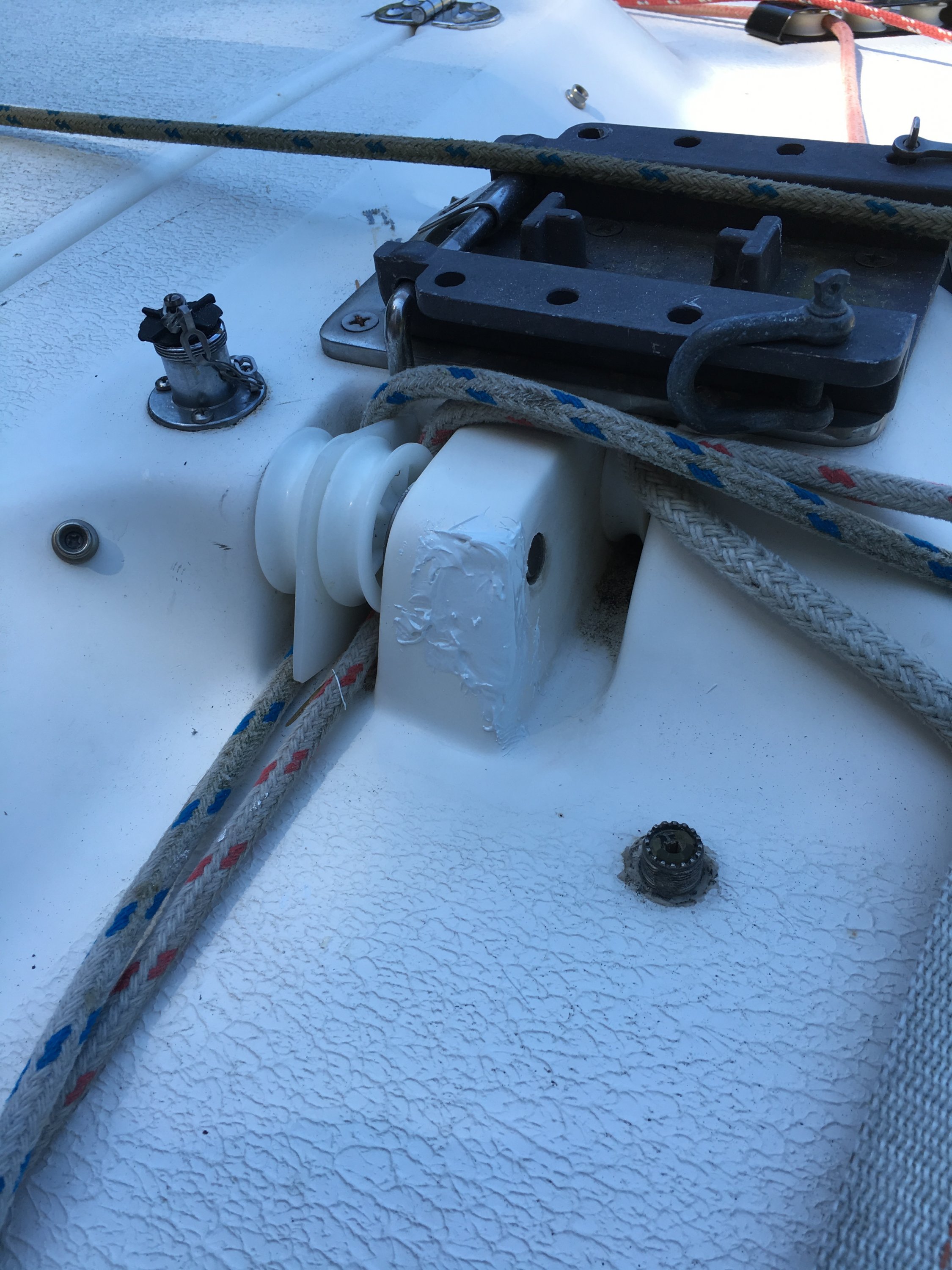

So here is the first pass of my first attempt at glass repair. I'll refill the last few dimples this weekend, sand and paint. I think I can live with this. :))

Hip-hip Huzaah! Congratulations on a great repair. Keep us posted on how it holds up. I have a few voids to fill and that looks like it might be in my future. Do you have any of those spider web looking cracks? I seem to have many and want to get them filled. My cockpit seats are just a tad soft, right where you step down off the house. I'm not sure what to do about those. Probably nothing, just stop stepping there - lol. Hey, how does your forward window look? Mine looks a bit like granite, very specular. And it drips just a tad. I might take that one on this year, we'll see.
10,524
-na -NA Anywhere USA
TR, you are learning and we will be glad to help you thru this. The major is done and it was not that hard. I would finish filling in the smaller voids to finish that off. If you want to put a finish paint on it, go to a store that sells Krylon and for the plastic paints find the closest white. Then sand lightly and wipe off with acetone or alcohol. Then mask the area off and lightly spray a few coats off allowing time to dry and then remove the painter's tape. What many do not realize you can hide the color difference where there are curves as it will blend in. Worked for me as a dealer and no one knew unless pointed out.

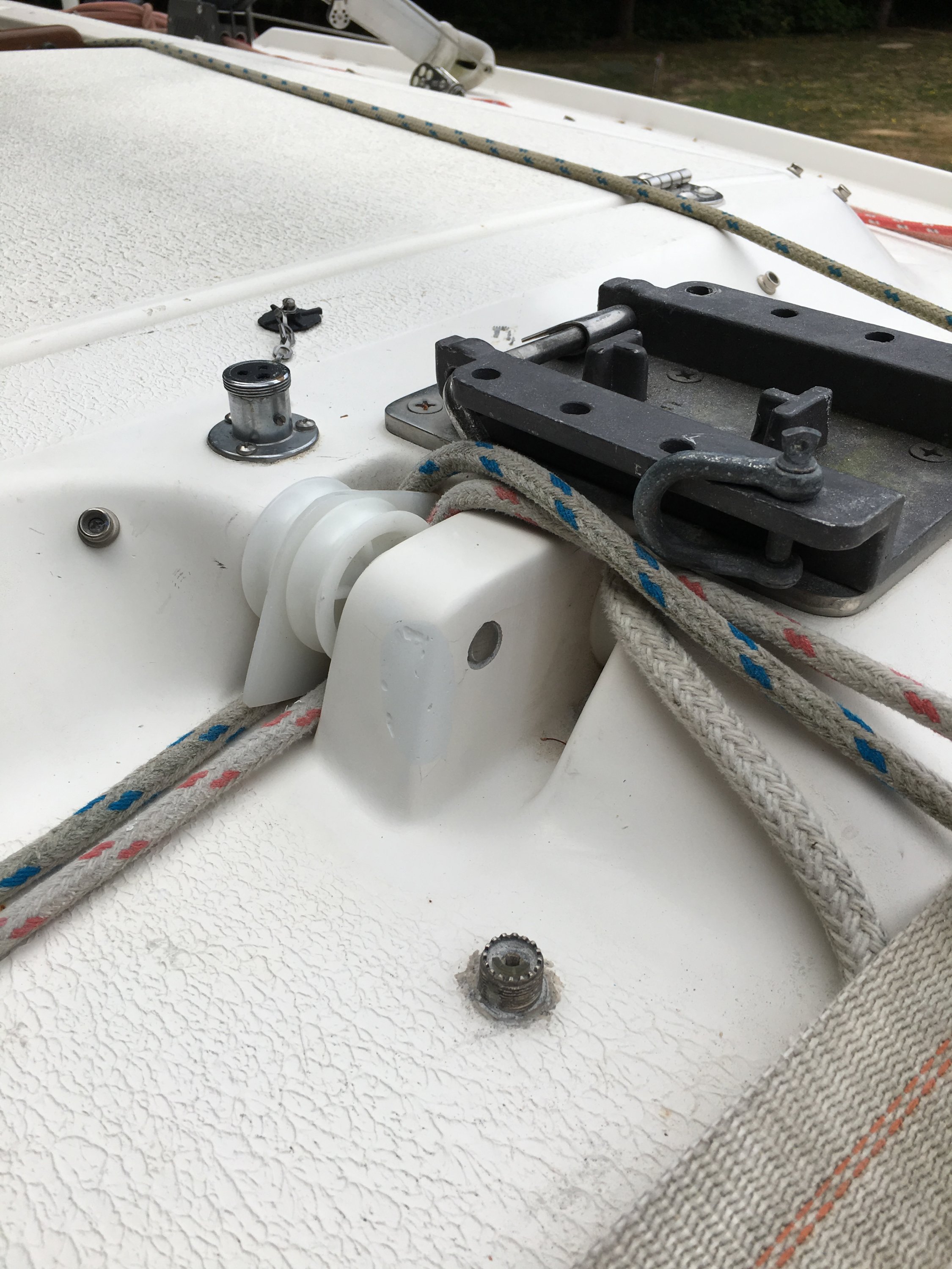

The stainless steel round object sticking out with hole in center (pictured) if not used needs a cover for that. It is a two inch double ended female fitting secured to the deck by the small nut on top and below the deck used for attaching a PL 259 cable VHF end. They make a stainless steel cover for that and I am not if it is Shakespear that makes it. Ok guys please help me here as to the specific mfg. number and good source to get one. It is needed to keep rain from going thru the deck via that hole.
Is there a dealer id on the boat say on the back, not the mfg id seen elsewhere as in hull id>

Crazy, Yep little by little I'll get it finished. Hopefully I'll get a bit more time this weekend. Thank you all again for all the advice and encouragement. That putty is awesome! I think I'm probably going to replace the coax its in pretty bad shape already. Will find a cap for it also. Thanx again.

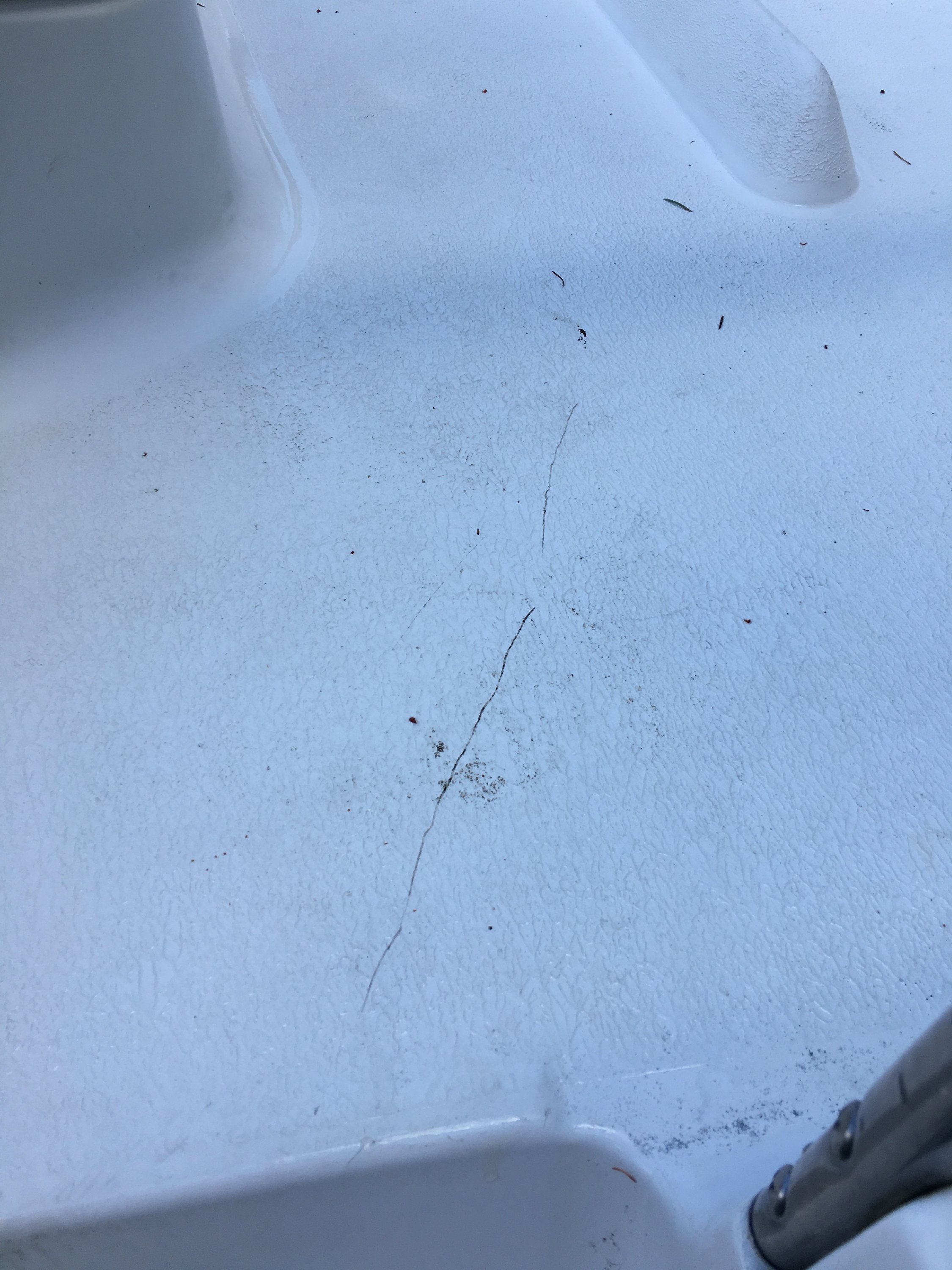

Sir, would you recommend this to fill the fine spider web like cracks that run along the smooth sections of the deck? Ah yes, it is a cosmetic repair, but I feel like one of Sir Dave's own is well worth the effort. How would you deal with these in the non-skid sections?

I really have no idea. This was my very first attempt at glass repair. My guess is that it would work fine? I have a small crack in my cockpit floor but wonder if I could replicate the anti skid finish.

It appears the gel coat is cracked only. I would attempt to dremel that crack to clean out the debri accumulated in it and then some acetone to clean out making sure not to really enlargeon too much. Then fill with marine tex. Then repaint the entire deck which will also take cleaning that surface. If you are not so keen on applying gel coat which is another discussion, then you could use the Krylon paint but the entire non skid surface would have to be painted. TR, please review and then send me a private message with your contact information and we will talk. This is easy but a little time consuming.

OK, last post for this thread for me. All done! I'll add before and after photos. Thank you all for your help and advise. :)) I think I can live with this, my first, fiberglass repair.
