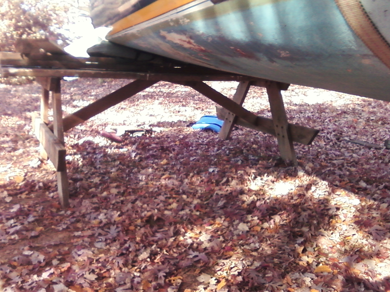

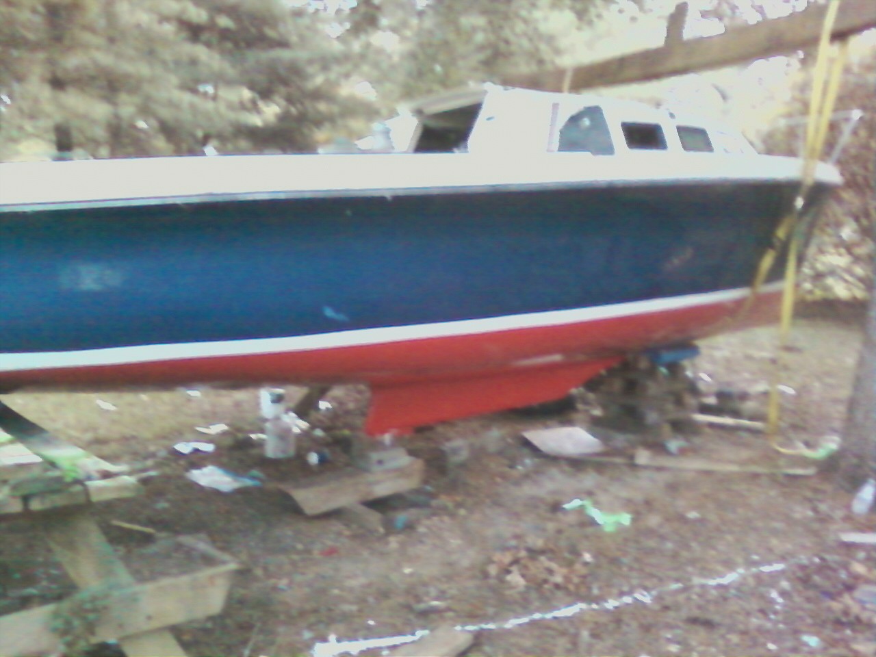

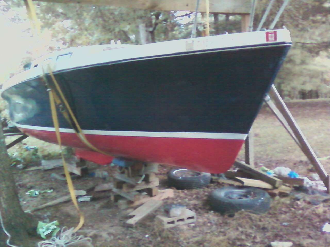

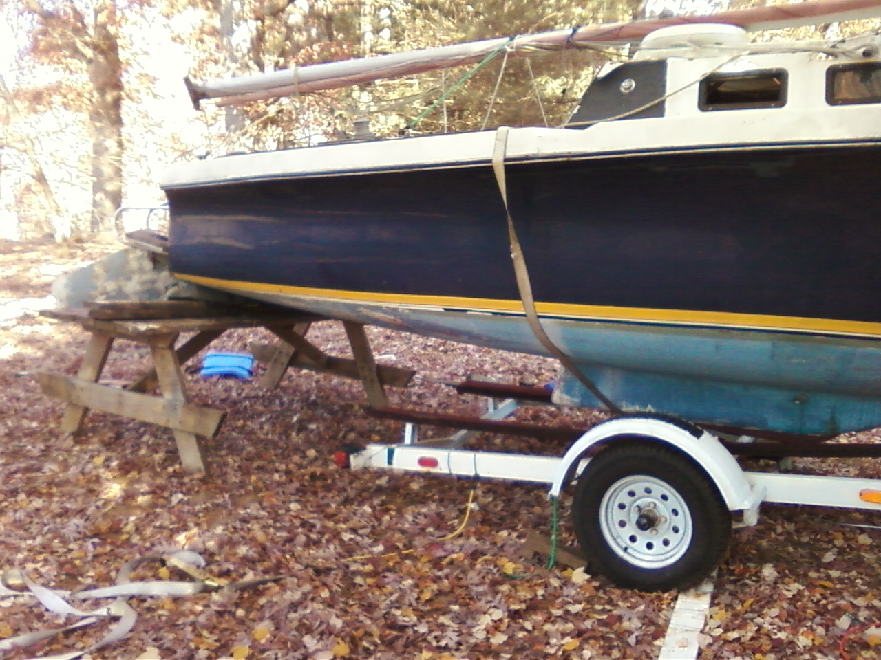

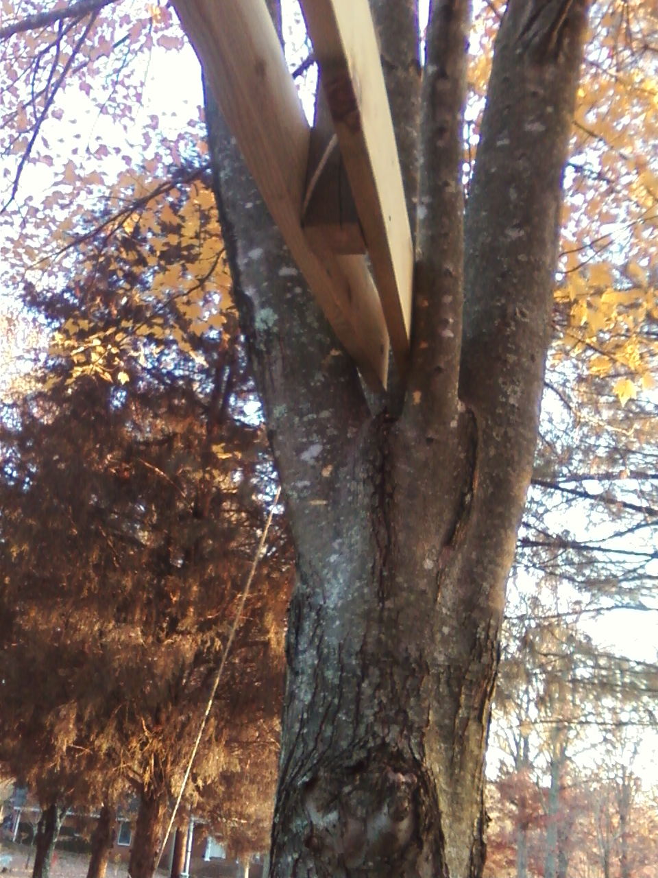

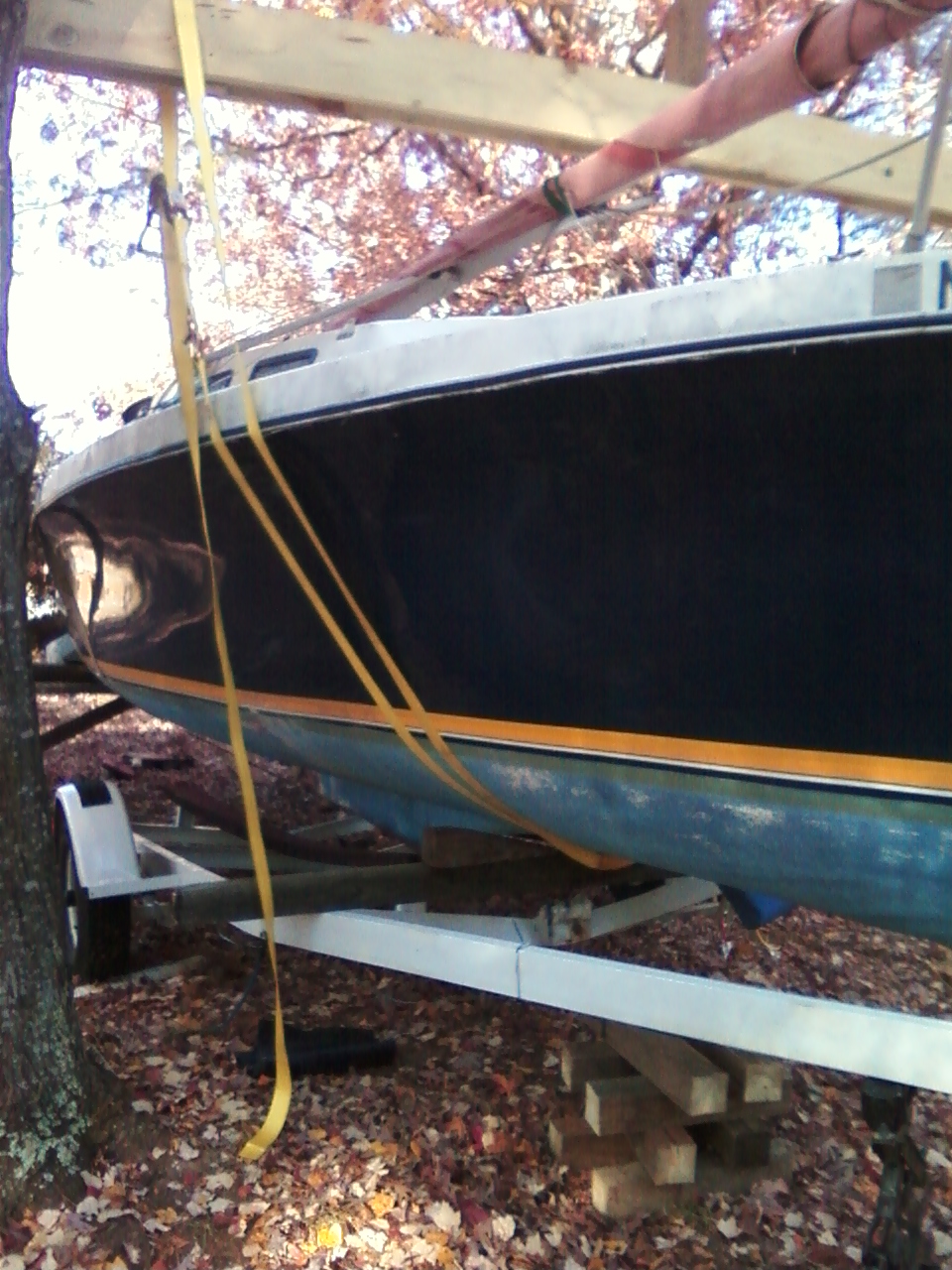

If you have a stout tree, You can park under the tree... lower the nose oof the trailer all the way down... slide a sturdy picnic table under the transom with an old life jacket to pad... then raise the nose of the trailer all the way up using the trailer jack... this will get the nose of the boat about 4’. Take a heavy duty tow strap (or two) under the boat and up into a sturdy branch of the tree. Jack the nose up a bit ... sinch the strap and remove the trailer.
I can post pic later (I’m on my phone now) if you want to try this.

Although I value @rgranger I would not recommend this to a novice. Experience you do not have lifting on your own, doing that alone, what about a dead tree and the list goes on and on. Suggest a yard with a lift and make sure the line is 7/16 inch only

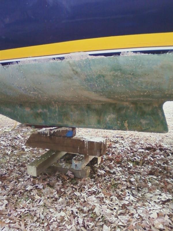

and here are some pics of how I've jacked it on a similar sized boat.
